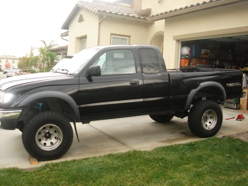

    malander
    malander Well-Known Member
    May 6, 2010
    #36656
    2,421
    max
    01 limited trd 4x4

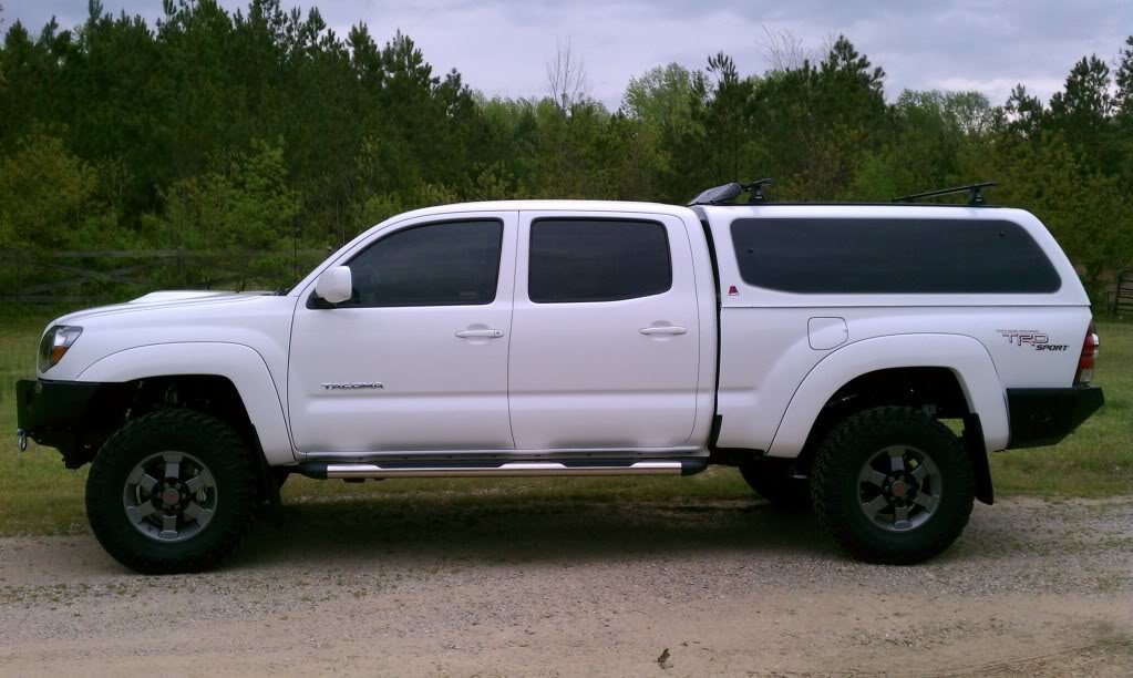

    deck plate mod,jba cat back,bilstein 5100's,ome 883 springs, Allpro expos, allpro U-bolt flip kit, 10" Bilstien 5150 shocks, custom lower shock mounts
    That set up looks great. I take it those are kings? set at 3"? What length 5150 did you need to run those springs? stock mounting location I presume?

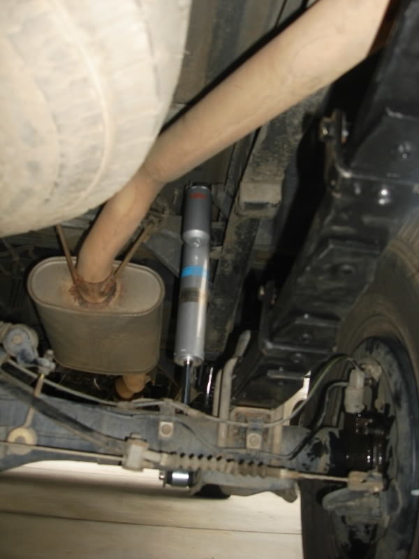

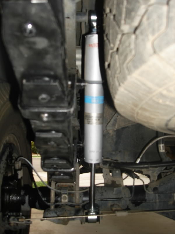

  4. Apr 10, 2011 at 10:04 PM
    #24
    ExpoSpy
    ExpoSpy Well-Known Member
    Nov 1, 2009
    #25260
    678
    Brian
    Temecula
    Just by looking at Monkeyproof's old leaf packs it does look like you have the wrong ones. His are AP4505T's not AP4500T's like yours say. Uh oh! :ohsnap:

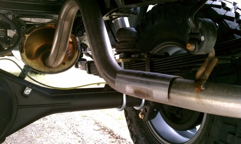

  17. Apr 20, 2011 at 2:35 PM
    #37
    Kyouto42
    Kyouto42 Iron Beard
    Aug 18, 2008
    #8614
    9,120
    Jake
    Ahwatukee, AZ
    BSP '10 4x4 TRD Off-Road DC
    See build thread in signature

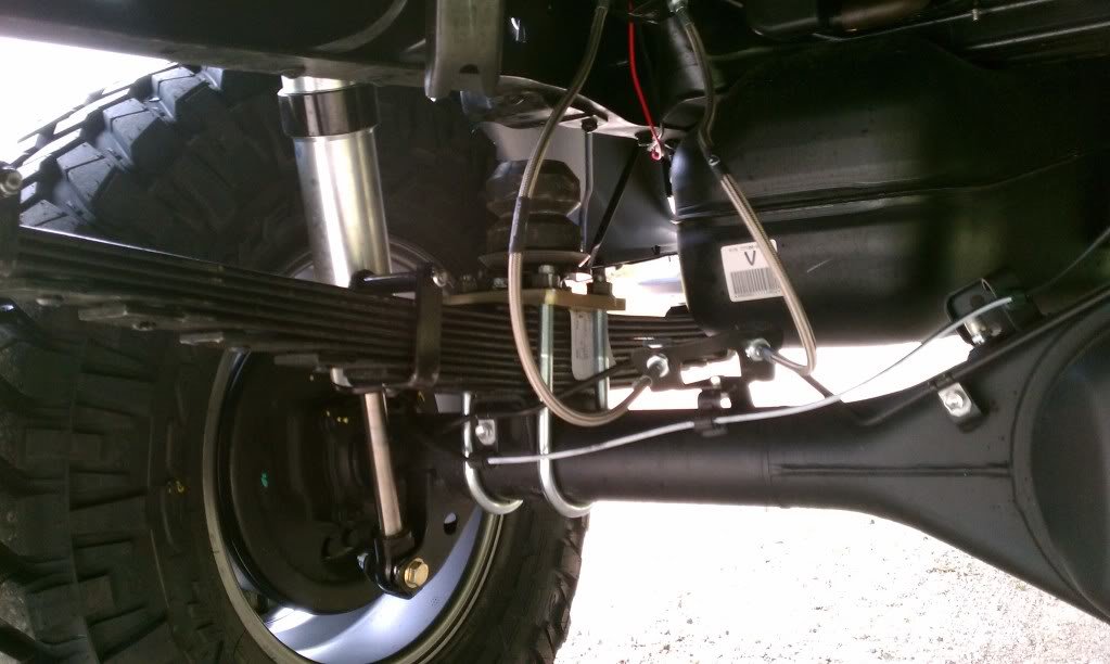

    I just got these installed on Friday.... I freak'n love them. When I had the old TRD 16" rims and rugged fails, plus the spare KM2 285/75/R16 in the back and the old leafs and sway bar.... the truck road like absolute butter on the road. Even with very little weight in the back... it's stiff (like a truck should be) but absorbs bumps at speed like candy. Couldn't be happier.
    Pic installed from side level (front needs to be cranked up quite a bit, been waiting on settling)
    Pic with the AllPro U-bolt Flip from back
    [ATTACH=full]2282572[/ATTACH]
    I don't have any better pics atm of them installed though. But yea, +1 these springs rock!
