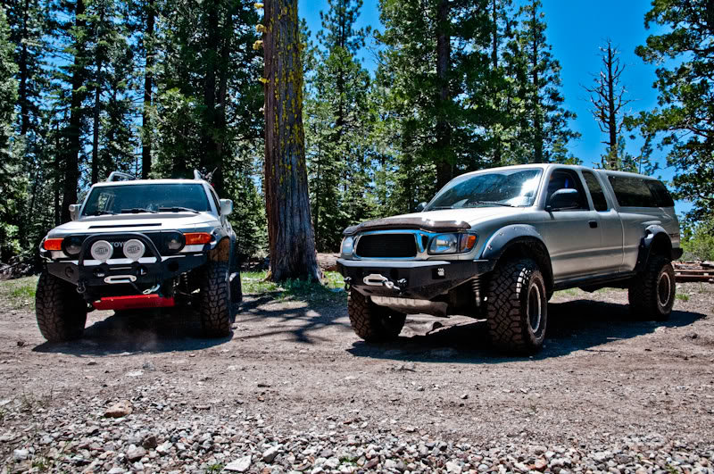

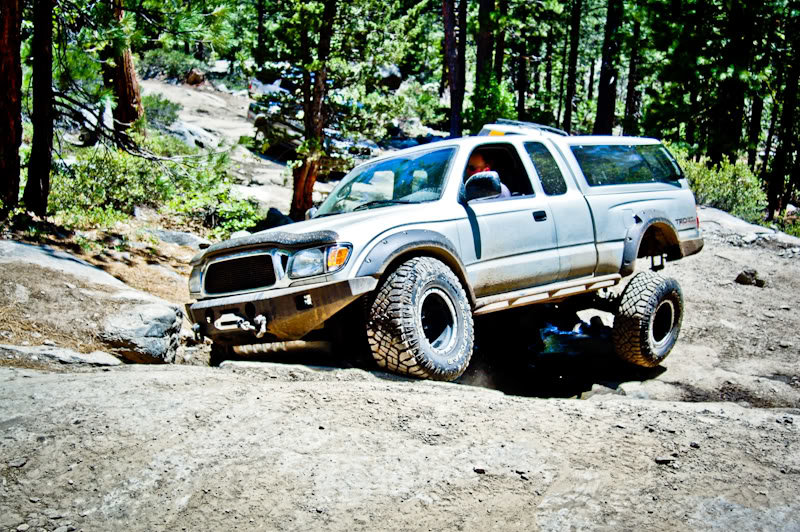

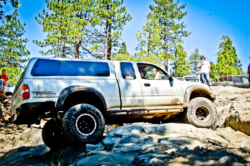

    Yep they are awesome in this pic i had about 600lbs of camping gear in the bed as well as a 200lb camper shell and never bottomed out once well unless i was flexing :D
    Also they flex pretty well
    Here is the stance loaded.
    And unloaded.
