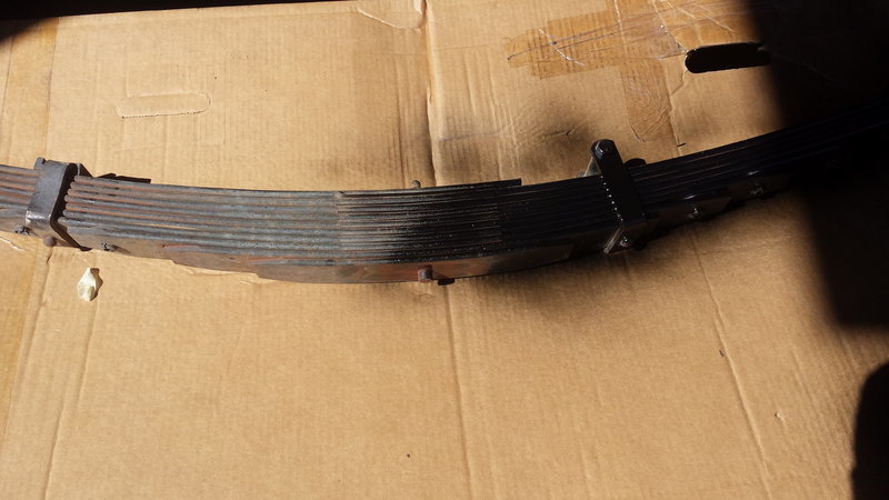

    Looking for help identifying a set of AP expo leafs for a gen 1.
    Here's a little bit of the back story: The person that I got them from bought them new from AP a few years ago but wasn't happy how tall they were so he sent them to Deaver to have them flattened a little. He isn't using them anymore and offered to trade them to me.
    Here's the issue, they look to be missing a leaf or two. I count seven leafs at the centering bolt. Also, they don't have the part no. (4500T-AP-3EX-PR) anywhere, just a faded sticker that is barely readable. I totally belive the guy, I think Deaver removed the few leafs, thus flattening the pack.
    Can anyone that has a EXPO set counting how many leafs are at the centering bolt? I'm trying to identify which leafs are missing with hopes that AP can send them to me. I have an email out to Tracy but she hasn't responded yet. Any help would be greatly appreciated.
    Here's a photo for comparison (from OP)

    The first gen ap expo pack comes with 7 leafs. Following my purchase, I too was concerned regarding the amount of leafs in the pack so I referenced previous threads to confirm I was clear to begin installation. I'm assuming the the 10 leaf pack for the 2nd gens consists of thinner leafs whilst the 7 leaf pack is able to provide the same load carrying ability with a fewer number of thicker leafs?
    Anyhow, best of luck with the install.

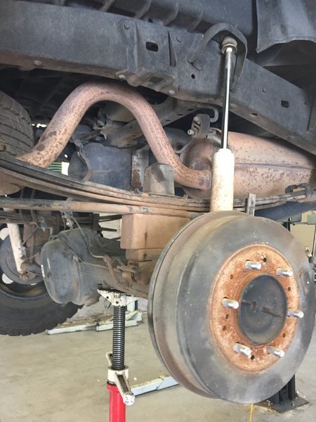

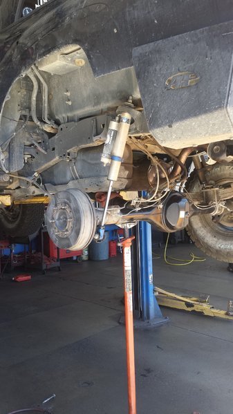

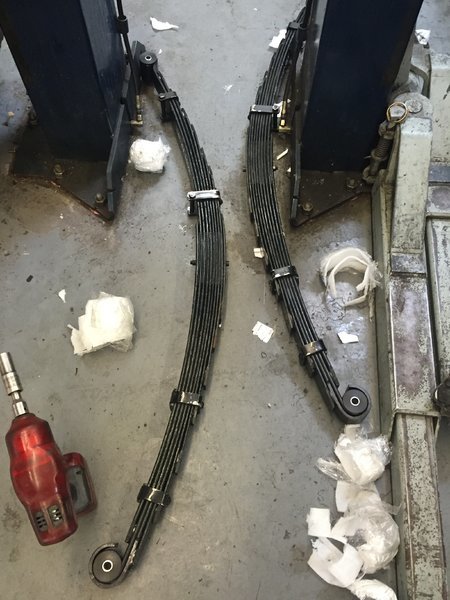

    Went smooth since I work at a dealership:D never have done springs before and took me about an hour and a half the springs came in good bushings already pressed in my truck finally sits level with the weight and rides way better than the blocks and the AAL these springs should have been done a long time ago here are some pics
    image.jpg Way to much block and flat leafs..
    image.jpg The truck after is level and rides like a dream gonna order some fox 12" smooth bodies now so I can see how well they flex
