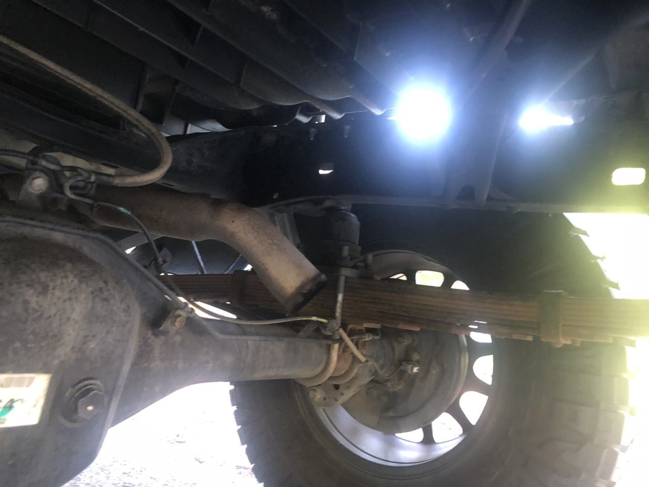

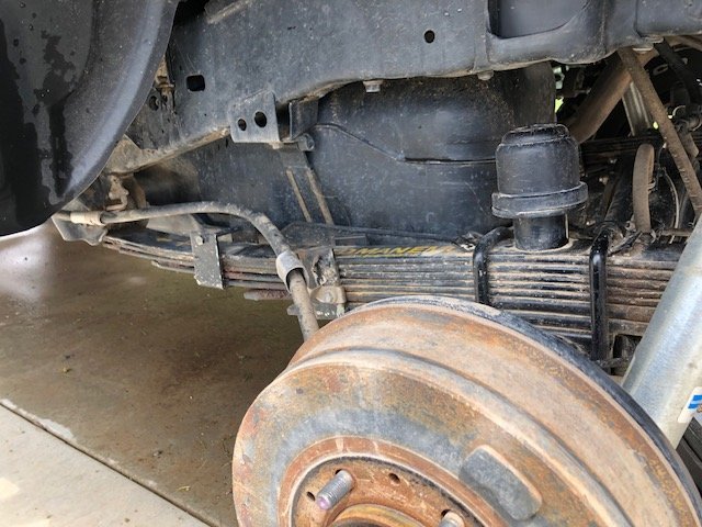

    Dont waste your money! 2 years of use... supposedly these can run 500lbs consistently (I’m running 400lbs) rtt and bed rack.
    Completely rusted, negative arch, my bump stops are almost touching the frame, causing my driveshaft to vibrate now. BS
    Sent a couple emails to all pro seeing if they would have some sort of apology for their crappy product but nothing. This just pisses me off, my hard earned money down the drain. I won’t buy anything from them again. Their lack of ownership just says it all.
    I ordered Deavers, sure they’re 300$ more but I haven’t heard anything bad from them yet, no sagging stories like all pro. Do it right the first time and save yourself the headache and time.
    3E03C55A-ACCC-4080-8F15-25CA8E570DFC.jpg F2304AD1-AFE3-441F-918E-DA3666726244.jpg
    *rant over
    Edit: They have flattened way before the 2 year mark, they’re only now starting to disrupt other components on my truck, driveline vibe and leaking pinion seal on the third member.

    Hey thats what my HD Dakars look like with less then 1.5yrs on them. I am shopping for my next set of leafs
