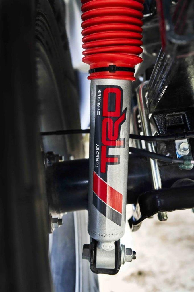

    Bought my ‘16 as a leftover in March of 2017. Only ‘16 on the lot. 6spd manual Access Cab. Now that I have over 100K on it, I’d like to do a few upgrades. It’s my daily driver. It never has a constant load in the bed, although I have hauled around mulch, topsoil, gravel at times (definitely maxed out the payload).
    I’m thinking of doing the silver and red TRD branded Bilstein 5100 as well as the Deaver 1.5 AAL (1 leaf).
    Additionally I would like to do the OTT Mild Tune to address the annoying hesitation I’ve put up with all these years.

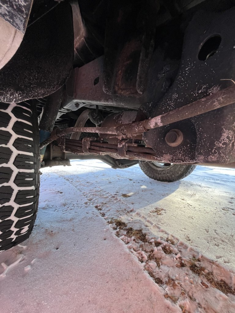

    Your leaf pack is probably past its expiration date( worn out), they were crap to begin with. Go get a decent spring pack and drive for another 100k.

    My leaf pack has to be shot. I’ve gone way over the payload when filling my gardens with stone. I don’t plan on doing too much more of that. Just one area left to do.
    If I had the money, I’d go with the Deaver J66 or stage 1.

    I just realized I had that TRD shock picture in there twice. Trying to post on an iPhone is mildly annoying.

    I rarely carry a load either, and have been ok with a 1" block the rear. But I would think it would be much cheaper to get the true Bilstein 5100 over the TRD 5100 version.
    But I may be wrong. Either way, can't go wrong with the 5100's... :cheers:

    I want to say you could get the TRD shocks without the other nonsense (grill, harness), for like $350 back in 2021. Then they combined it into a lift package for over $1000. I found just the shocks again for around $350 shipped.

    This is how my stock springs look at 101K miles…

    Just buy new front shocks with new installed springs as an assembly, this is the most common route.
