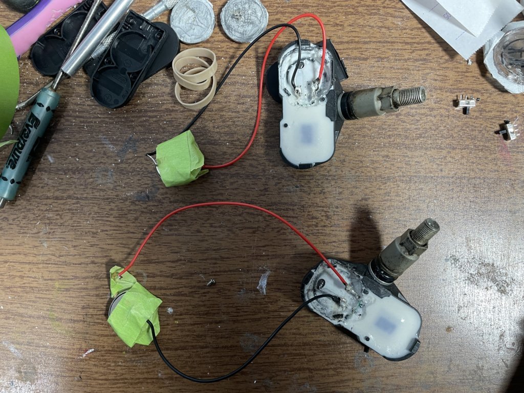

    I made mine about 8 or 10 years ago. This is the picture from when I made it. Stays under the backseat. Wrap the sensors with bubble wrap before you glue it together so you won’t hear them rattling around.

    Also want to add, I made this because I had two sets of rims and tires. They were in my winter tires and in the summer I had trouble getting my inspection sticker because of the light on.
