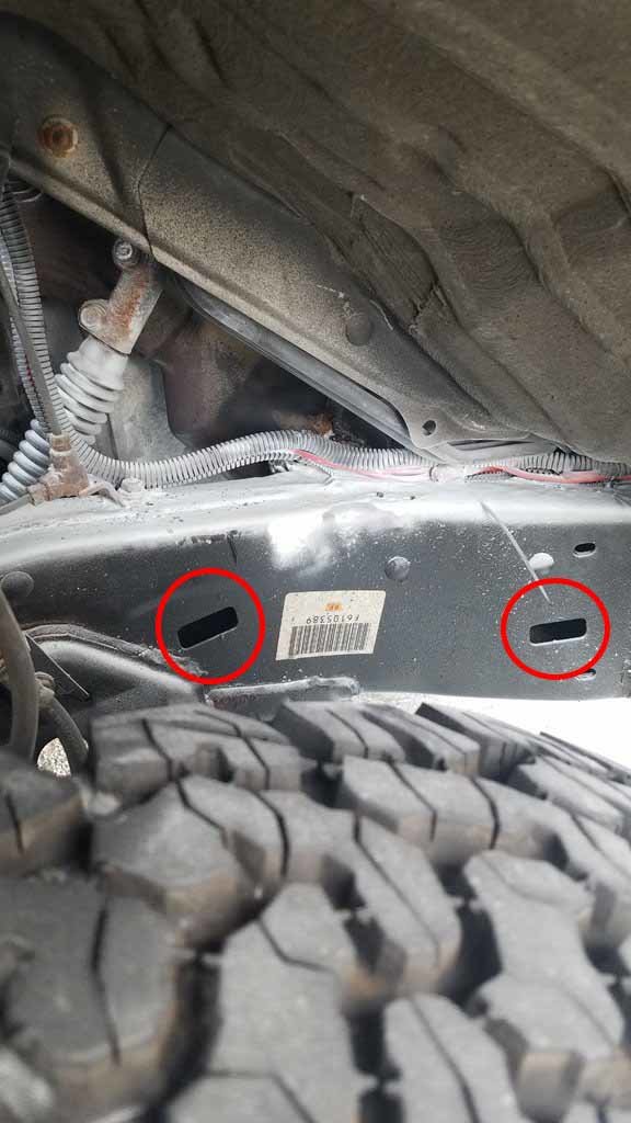

    No. There is a reason toyota doesnt run anything through the boxed section of the frame from the factory. Especially at that location where debris from the tire or the tire itself can cut wires, let alone the frame cutting through wire installation.

    True, I have it in wire loom but I can see where your coming from.

    Seriously guys. Run your wires properly and this won’t be an issue. Go through the firewall. I’ve seen so many car fires because of poor diy wiring it’s scary. If you run out of grommets to route through, buy more grommets and drill through the firewall. Routing wires through the frame or near moving parts or exhaust is asking for a fire. Just don’t do it.
    ETA: also your fuse should have blown. Test the amp draw of your system while you’re redoing the wires and put in the correct fuse.

    Yeah I see your point. There's a few sets of wires up there that could use neatening up, but for the most part everything is in control. That pic is also right after I ripped a few wires out to ensure everything was disconnected. But yeah all wire runs should be loomed and clean to prevent issues like this!

    Great point! This cable really should have been run through the firewall. I do have some other 0 gauge cable for the dual battery install that is run along side the frame rail to the bed, but that's because I wouldn't want that much current in the cab. Breakers on either side, and it is not near the exhaust. I'll be double checking it tonight!

    What exactly caused the wire to melt at first? Being close to the exhaust or just a short?

    sounds like it was routed way to close to the exhaust, zip tie melted, wire shorted on to exhaust / wire insulation caught fire.
