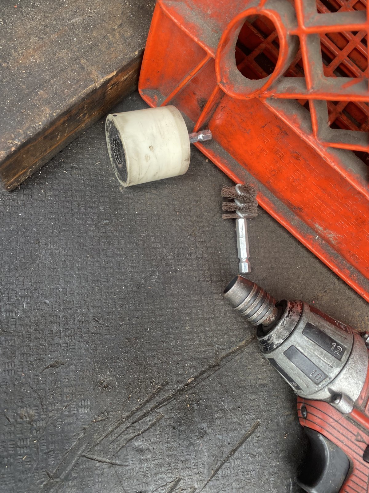

    You could try a battery brush on the terminals and posts. Even if they LOOK clean there could be oxidation on the posts interfering with a good connection. They’re available cheap at most auto parts stores.

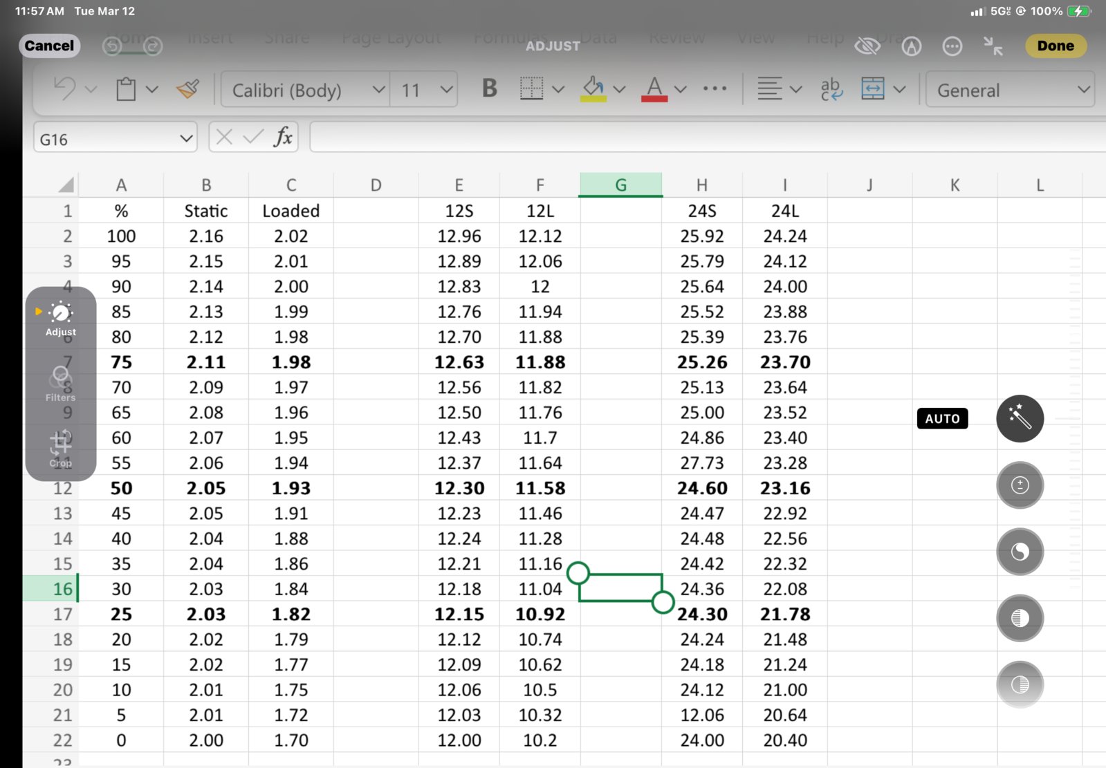

    i'm not a battery expert, but i think 12.2 static is on the low side.
    i think mine was at 12.42 or something last time i checked.

    According to the chart I use, it’s about 35% static, 30% loaded. I wouldn’t replace it yet. Id brush the terminals and posts, then retest.

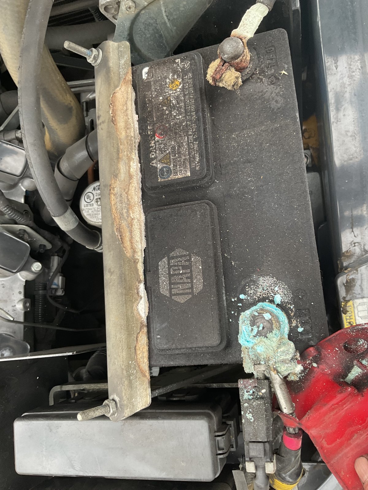

    okay, how are your cables? had an absolutely perfect looking battery terminal once, but the 12mm bolt at the back was loose, and the inside of the terminal itself was corroded up scrubbed that and tightened up the 12mm bolt on the positive lead and have not had an issue since.
