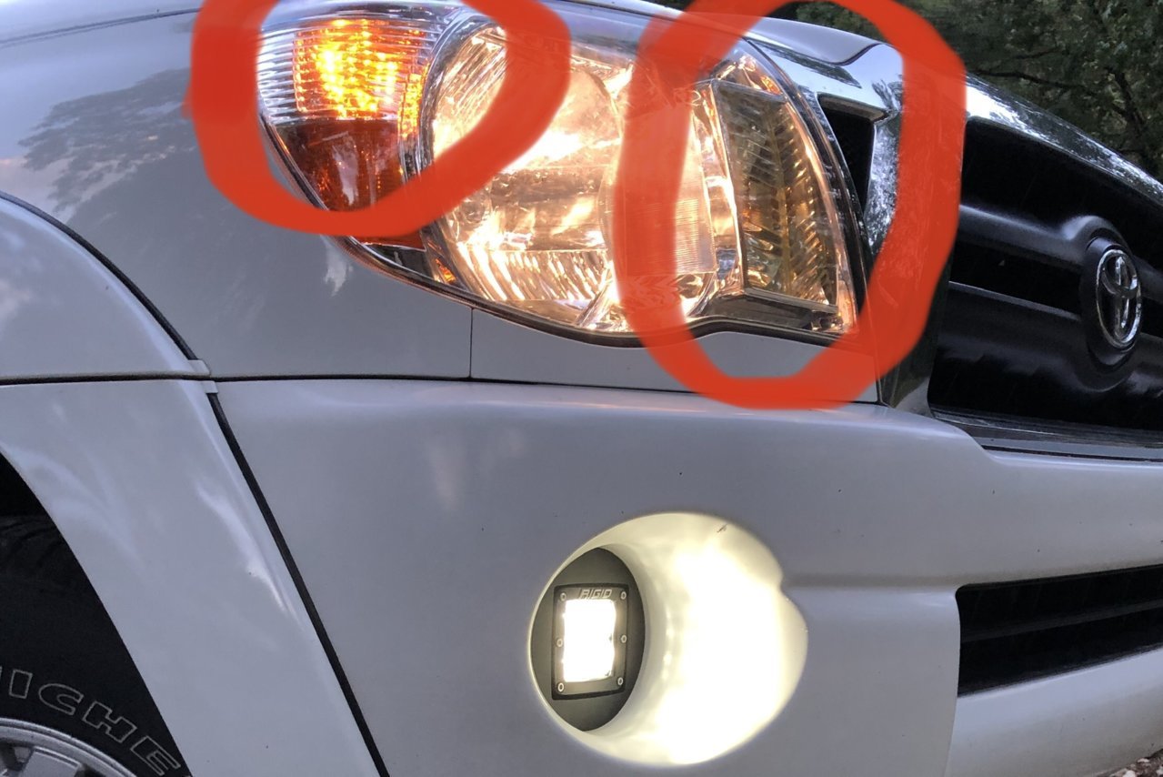

    Hey! I about to pull the trigger on these but I’m struggling to get my DRL question answered so I know if I have to order extra DRL harnesses or not. Instead of having my turn signals be on 24/7 the only lights that I have similar to a DRL on on the sides of my headlights. I tried looking at older posting but none really answered the question.

    Here’s a picture to make more sense of what I was trying to say

    If your inner light is not illuminated when the headlights are off you do not have the DRL, double check your headlight stalk for a DRL setting. The outer light is a parking light and not a DRL.

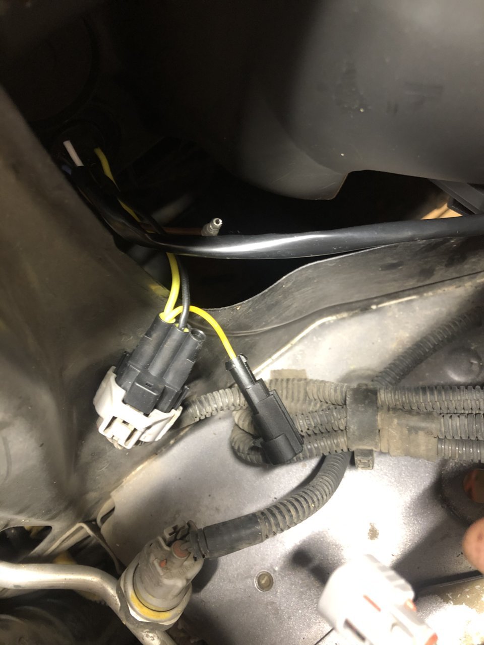

    I just installed the Novas on my 2011 2nd Gen with DRL. I’m having an issue with two left over wires and its hyper flashing. There is not a connection for them and I can’t stand the hyperflash. I’ve tried multiple times to get ahold of Alpharex via phone, text, and email with no response whatsoever. These also did not come with any directions. It’s pretty expensive piece to be having problems like this IMO.

    Did you buy them with the resistors? I would contact Nelson Mann on Facebook or messenger and tell him about it. I didn’t have day light so had to purchase the resistors for like $30

    that’s probably what it is, I selected that I have DRL and that was the only selectable part. So I assumed that they would have sent me the correct version.

    did you have these unused on both sides or just the passenger side. My 05 did not have DRL so it came with the extra harness which was quite easy to install. Anyways my driver side used that double yellow but the passenger side did not. I have the feeling they use the same harness for both sides so they don’t have to stock 2 types in warehouse. Hope that helps.

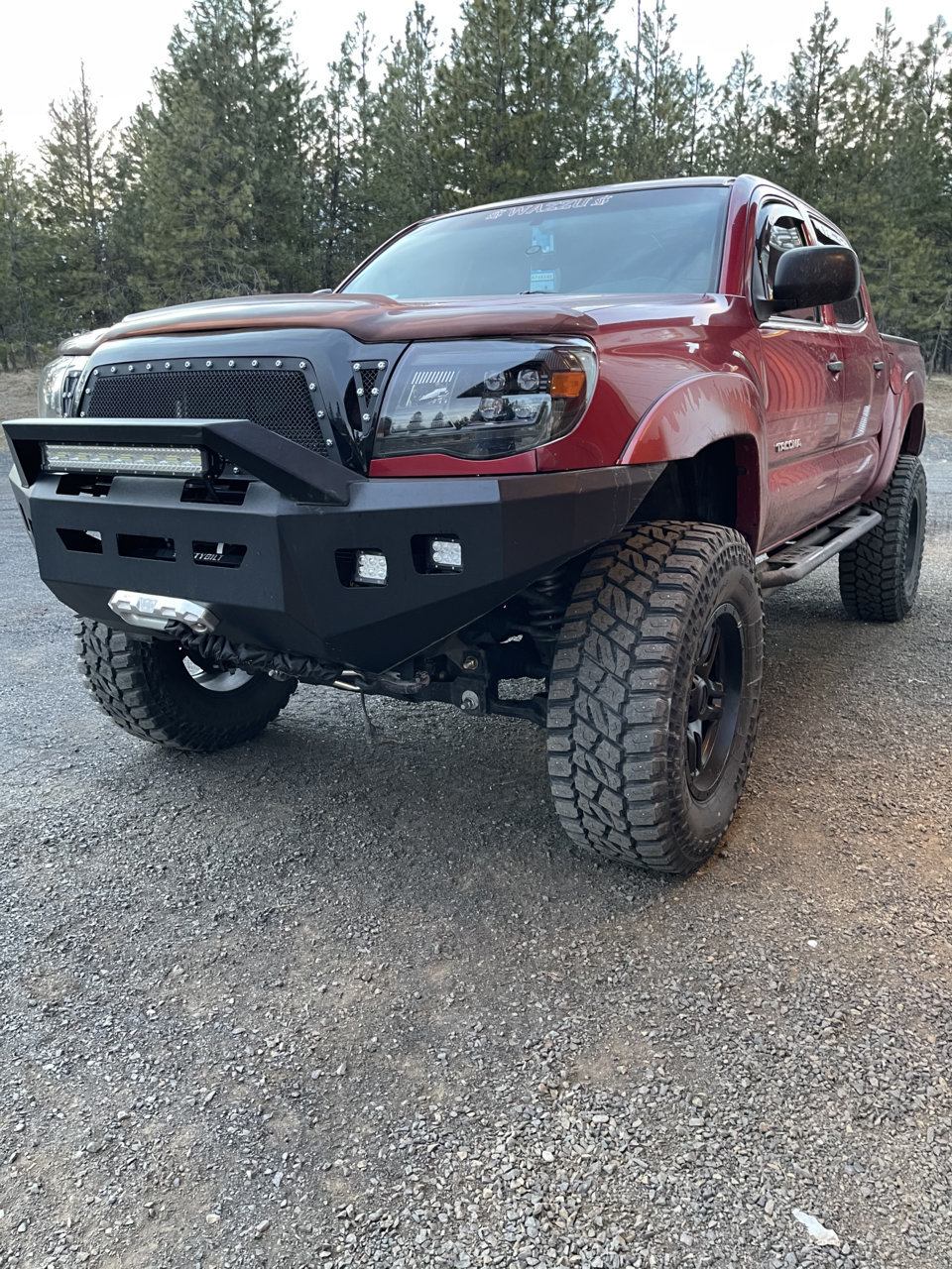

    I absolutely love mine. They are super bright, well designed, and I love having daytime running lights on my 05 that didn’t have them. They are pretty easy to install as well. There is a very well done walk though for the install. I’ll do another post with that link. I chose to turn off the 3 little bars because I personally thought just the outline looked better. The s bars are there so you will still have a DRL when the blinker is on. This is just a personal chose and super easy to switch on and off.

    this video is a great walk though on install. After watching this anyone will be able to install. Also, it shows how to disconnect the small block of the running lights I mentioned above.
