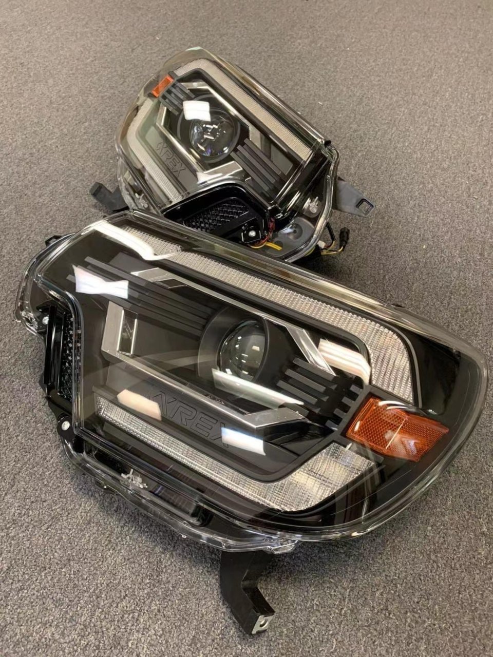

    Looks like they are be announced tomorrow
    Integerdy and cdex8357 like this.

    got to love their business model:
    but a $30 unit from China, slap their name on it, mark it up 200%, resell it

    $50ish direct form China

    The difference is they don’t make them. Vland is the brand that makes and sells the headlights. AlphaRex just buys in bulk, relabels the product and sells them for way more when you could also buy them direct from alibaba out of China yourself.
    betoman and Too Stroked like this.

    Gotcha. I read the review in previous post. The housing aesthetics are great. The performance is sub par. And what happened to the OP
