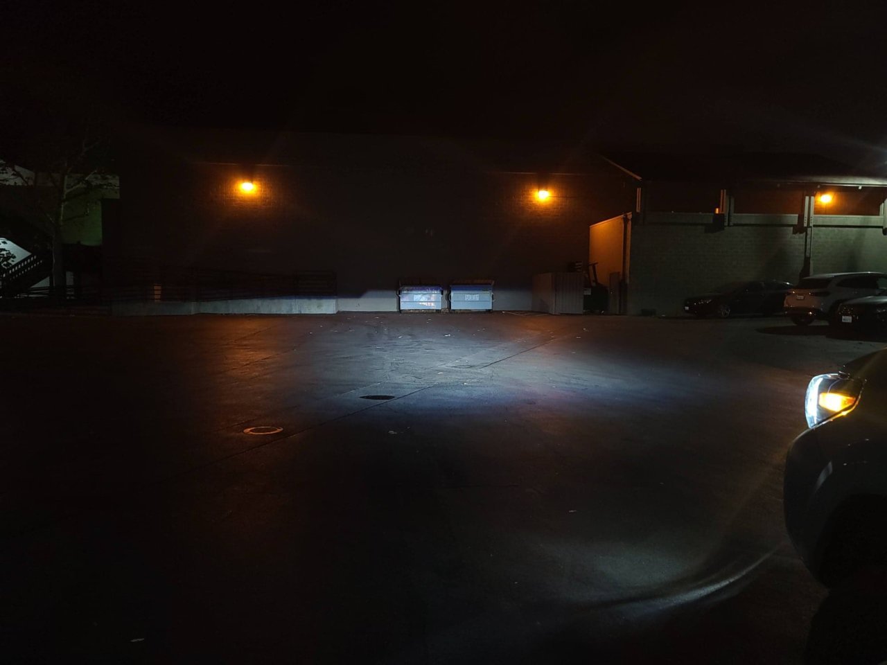

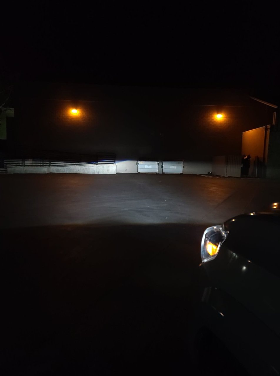

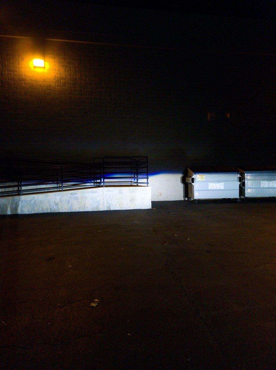

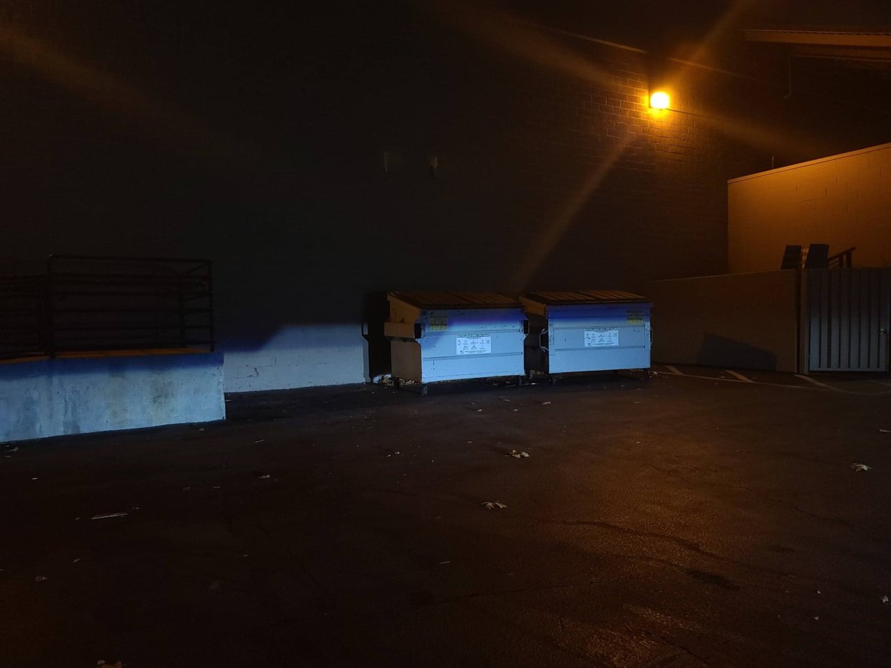

    Hey everyone. Just wanted to share my experience with NOVA headlights on my 2018 Tacoma. Haven't seen great comparison/cutoff pictures because everyone just raves about the looks of it - influencers included.
    I got a set of the Alpharex NOVA during Black Friday for 25% off so decided to pull the trigger. I knew they were going to be bad, but thought I could justify the performance because it has the 2020 OEM LED look. I was wrong. Also worth to note, their customer service was terrible. All images shot at F1.8 1/15 ISO250 same setting.
    Wake up people!
    Alpharex NOVA
    RX350 + STI-R clear lens + Osram CBB + 45W ballast

    More proof that Alphrex is a downgrade in performance. Thanks for sharing. Unfortunately, folks will continue to buy them "because they look cool." Words fail me. Thank god headlights are only a safety item.

    That will just create horrible amounts of high intensity foreground light and no distance light (distance light is the purpose of a headlight). People are always impressed with significant foreground light, because we are more sensitive to it, so rate it higher in importance/perception. But those lights with replacement LEDs will project significantly shorter than stock, aka be a major lighting downgrade, despite what the significant increase in short range foreground light would have you believe.
