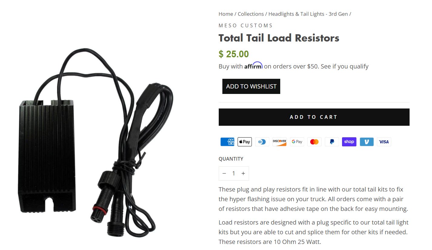

    I currently have the issue with my Alpharex tail lights where when I have either the hazards on or my right turn signal on and press the brake, the turn signal stops working and does not illuminate. I also did have hyper flashing issues on that side as well but haven't had that for a few months now so Im not sure what triggers/ triggered it. I saw tacoma beast has these resistors and was curious if maybe that could solve either mine or anyone else's issues mentioned above.
