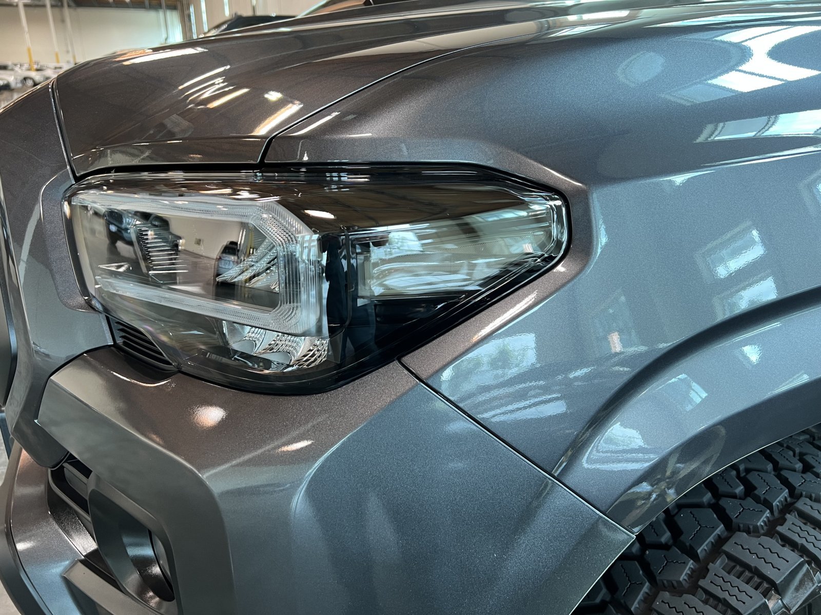

    I installed oem LED’s on my 23 SR using @Puppypunter conversion harness. Works great

    Thanks!!!!! @no vtec 4me did an amazing job doing the whole setup on headlights

    I agree with @crashnburn80….after much research I opted for OEM for couple bucks more. Black Friday looming soon, maybe you can grab a deal on the OEM’s

    OEM LED is by far the best headlight available for 3rd Gen.
