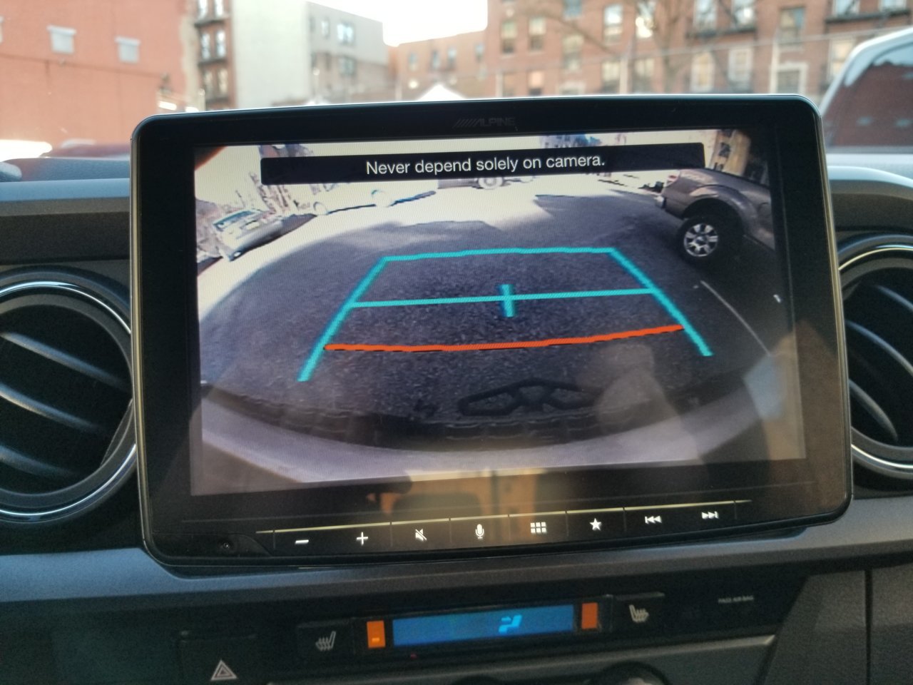

    @LtPeteMitchell it is a little pixelated, and you have to disable the alpine guidelines because they overlay on the stock ones. I guess going to a bigger display distorts the video a little, but its definitely still functional. I'll upload a pic tomorrow.

    Here is what the backup camera looks like. The overall image is not that bad, but its definitely pixelated and more fisheyed.

    I'm tempted to get an Alpine rear camera to see if it improves the image.

    Yea me too, depending on how much work it would require to get it setup. I can live with the stock camera, but indeed a better image would be nice. Keep us posted if you do.
    Also run a camera to the front, which might be easier then swapping the rear.

    I guess I can live with that. It doesn’t look terrible. The Halo9 must have better resolution than the Entune.
