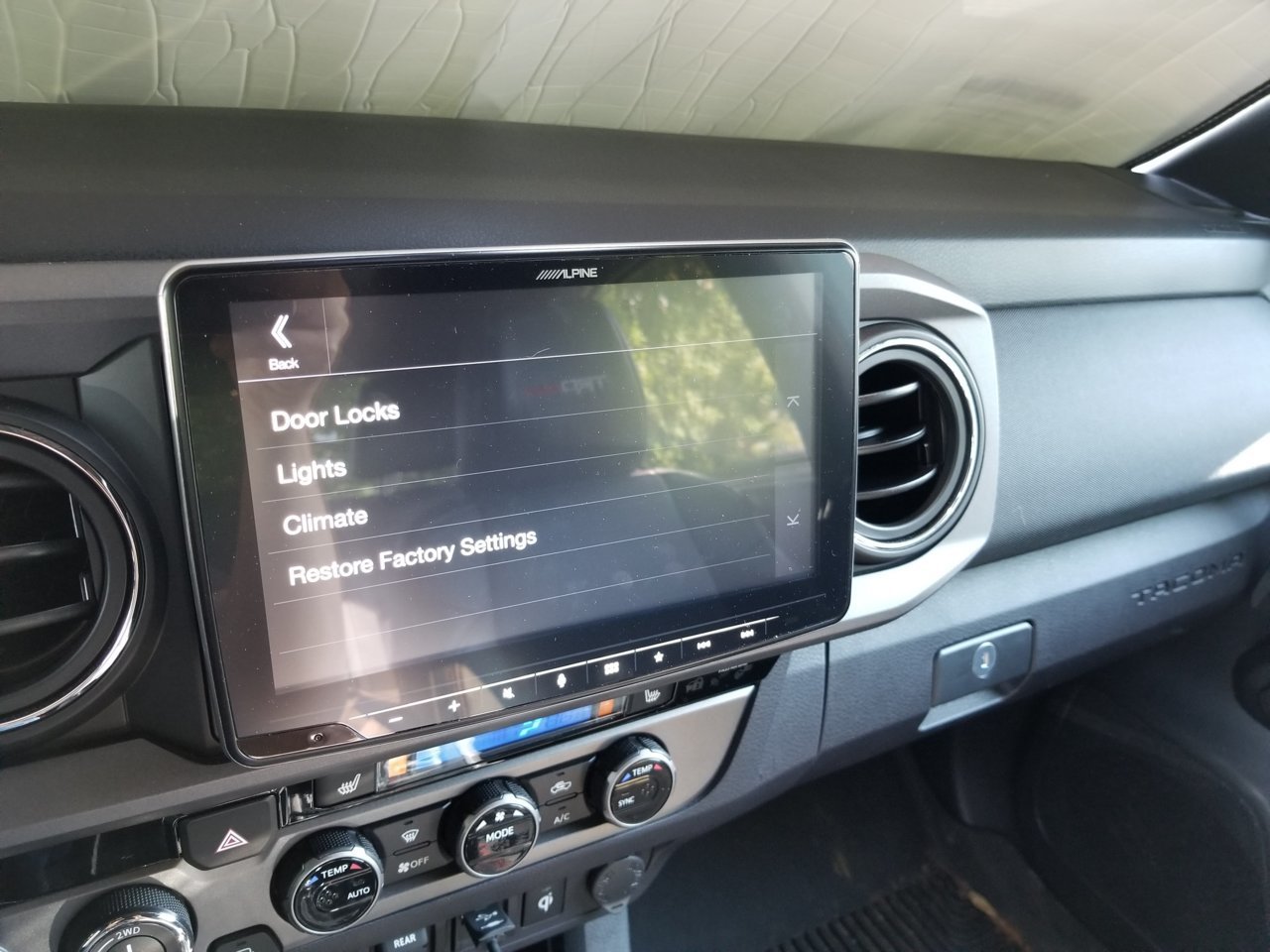

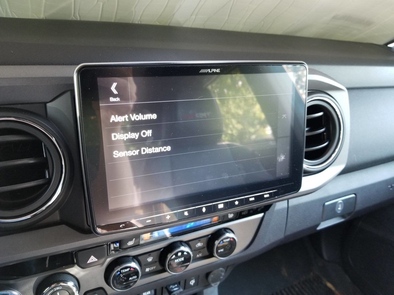

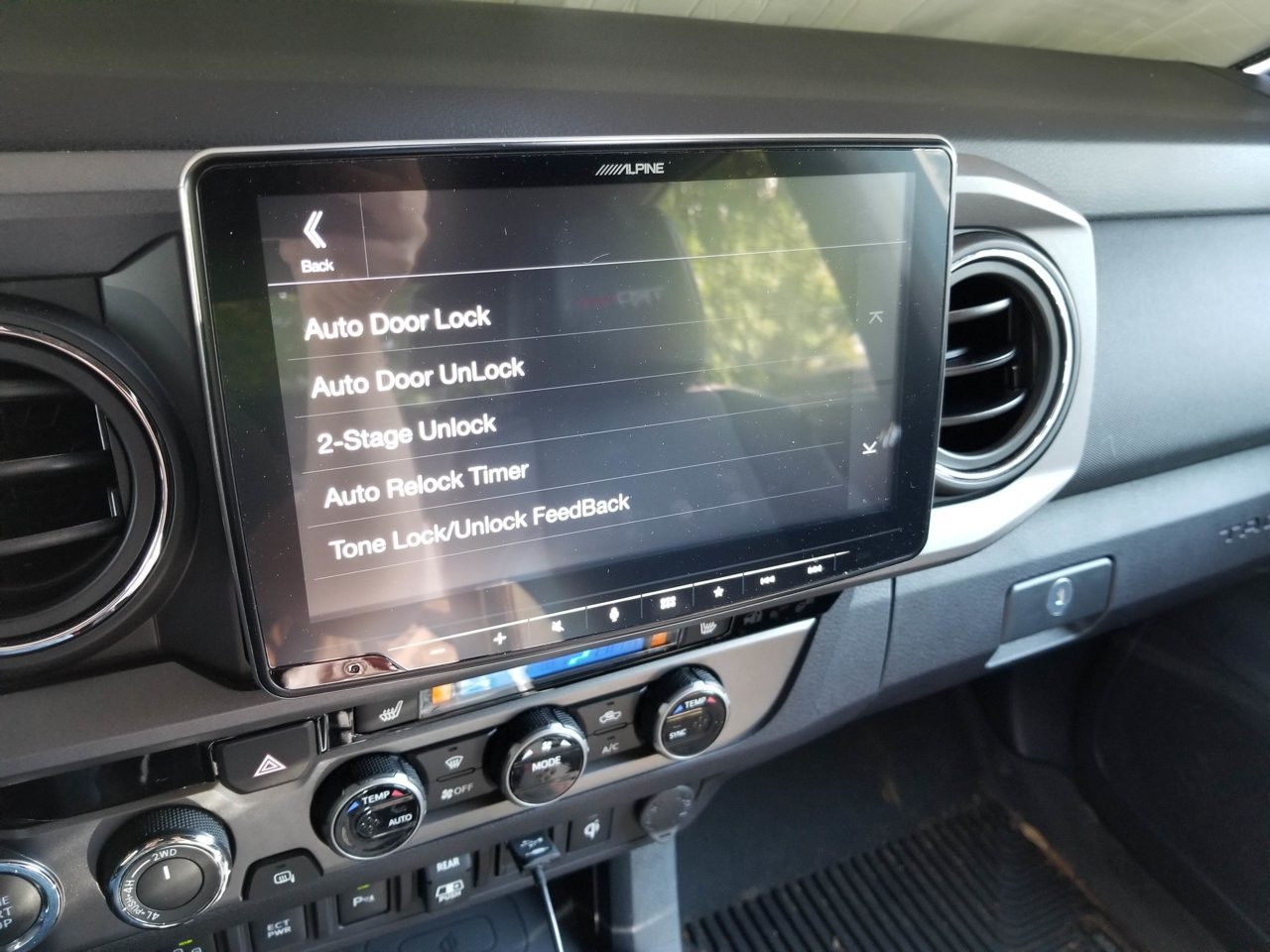

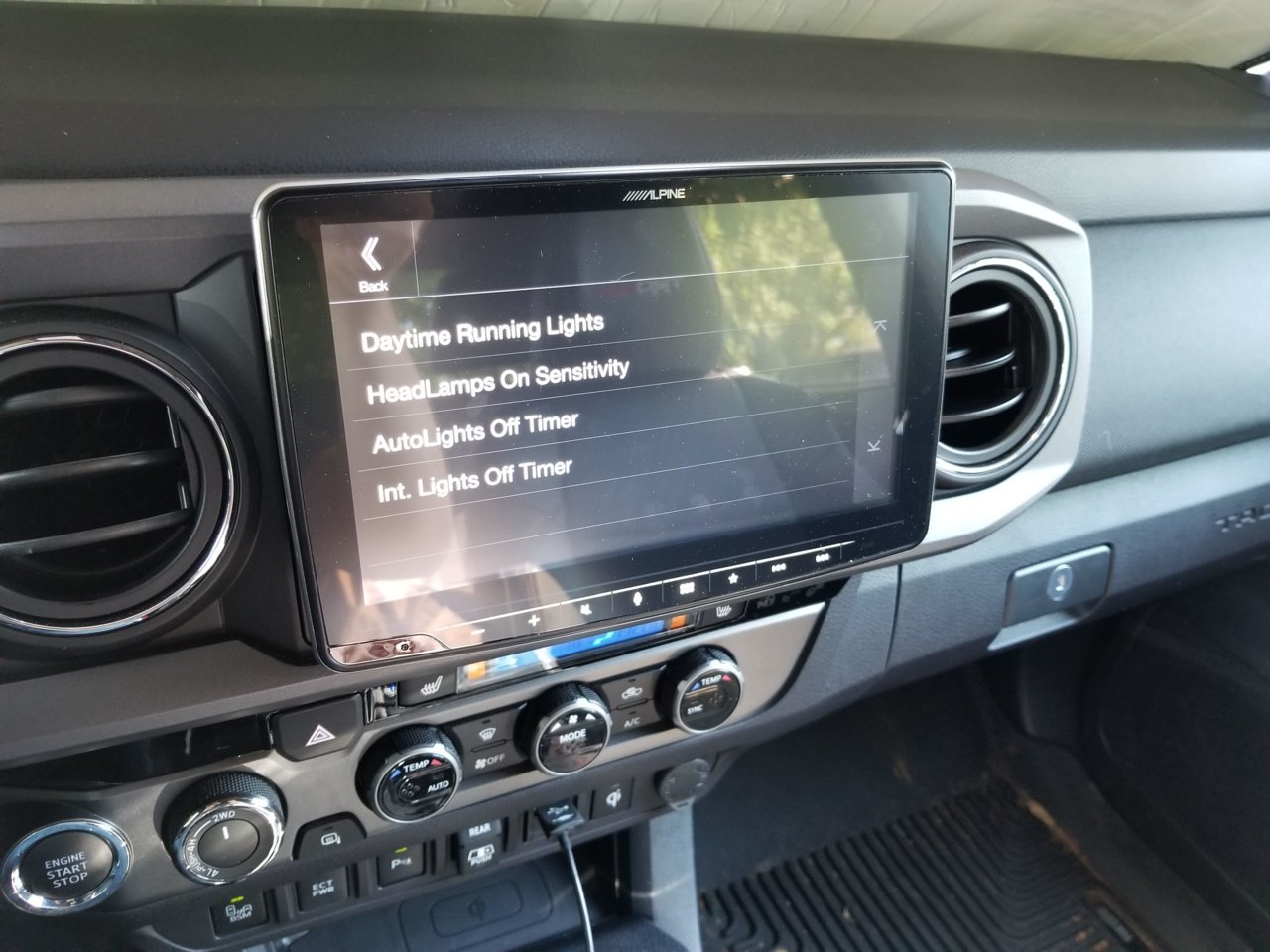

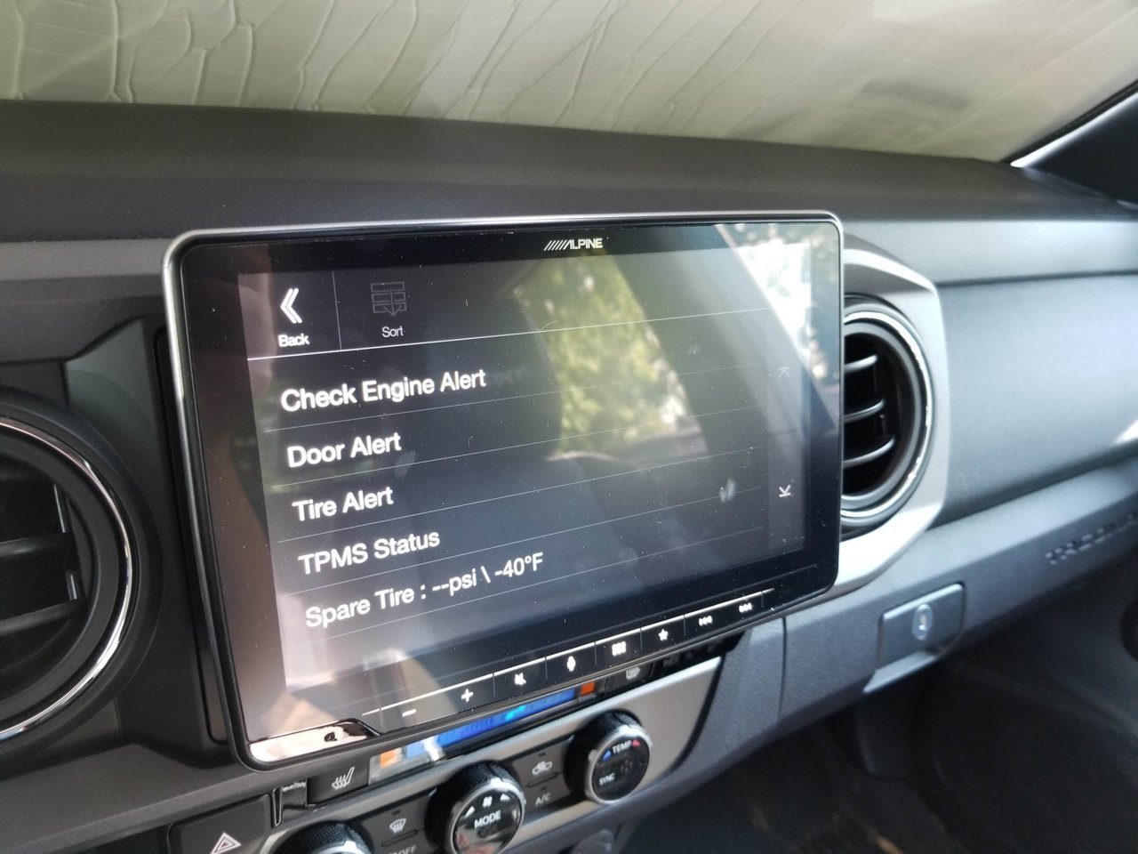

    With all that you have done, does the new stereo allow you to access the setup features that the ENTUNE does like setting lights, door locks and such or do you just lose all the functionality?

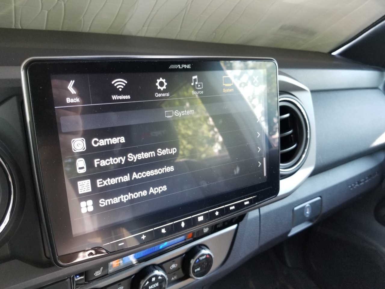

  4. Jun 1, 2018 at 7:07 AM
    #44
    DaMaDo
    DaMaDo Well-Known Member
    Aug 14, 2017
    #226790
    505
    Northern AL
    2018 White TRD Pro

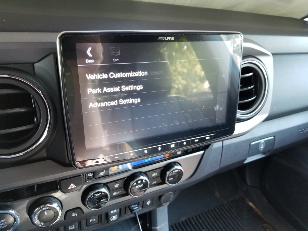

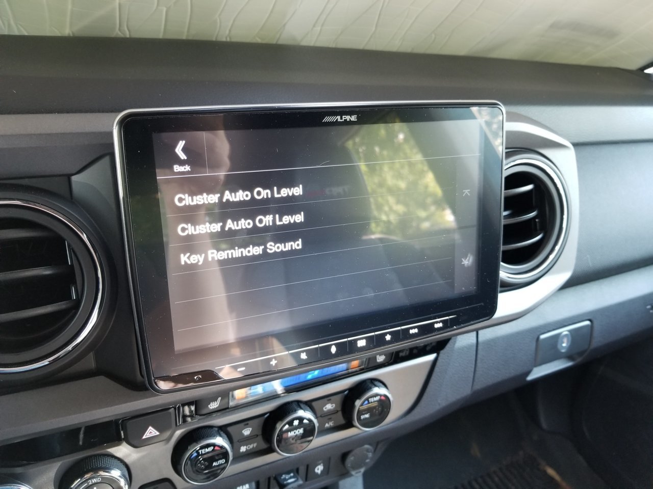

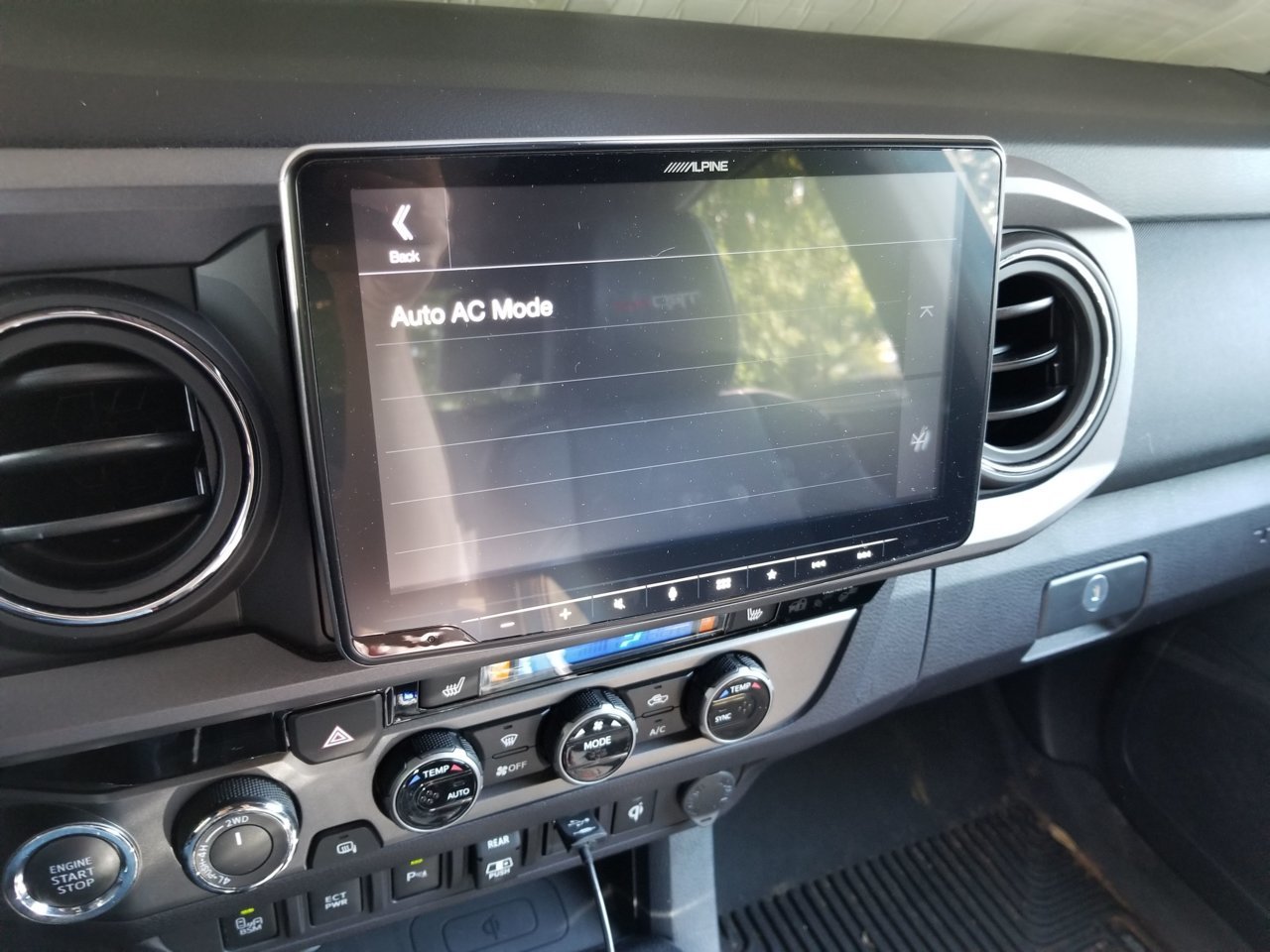

    Yeah, here are the menus for changing car settings
  5. Jun 1, 2018 at 7:46 AM
    #45
    Sam2day88
    Sam2day88 Member
    May 5, 2018
    #252606
    12
    Scott
    2018 Tacoma
    Sweet....that is awesome. Thank you very much.

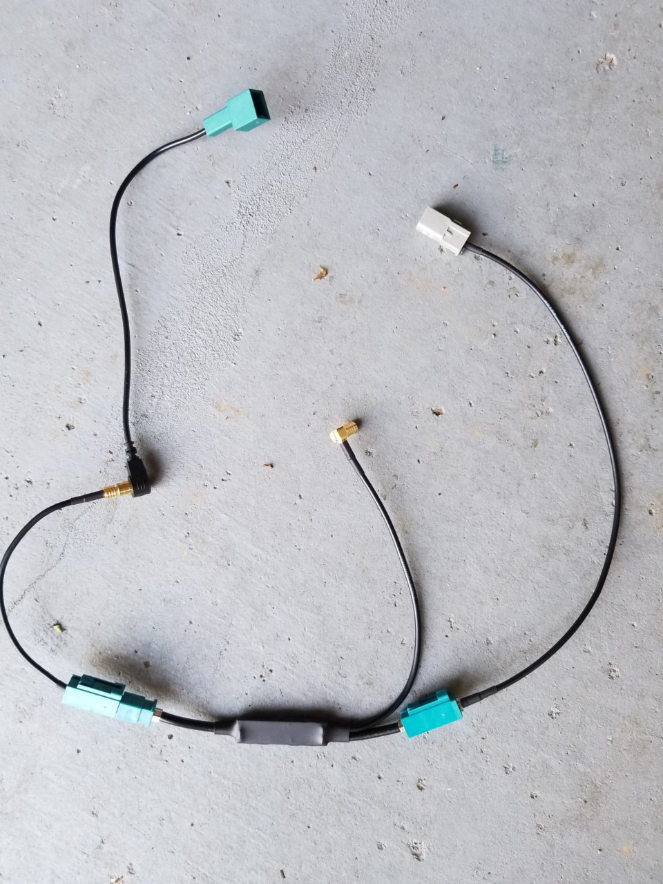

    EDIT: Don't do this splitter thing. It is completely unnecessary - I didn't find the second GPS cable and I thought there was only one (there's a white and a black connector for Nav and XM). Doing this will damage the GPS antenna. Everything has it's own connector, just keep looking in case it fell out of view.
    Combined some cables to make a splitter so I could have the HU and XM both connected to the shark antenna at the same time. I cut most of the circuit board off the split cable and soldered the connectors directly since the connections weren't showing continuity.
    XM works fine and the time shows up on the HU, so everything seems in working order, but I sometimes get an error message about the antenna not being connected each time I start the car, but that message goes away in a second. I'll see how it pans out over the next few days.
    I wonder if I needed a couple of Schottkey diodes or something between the RF cables.
    The green connector at the top goes to the shark antenna, the gold one in the middle to the XM module, and the grey one to the HU.

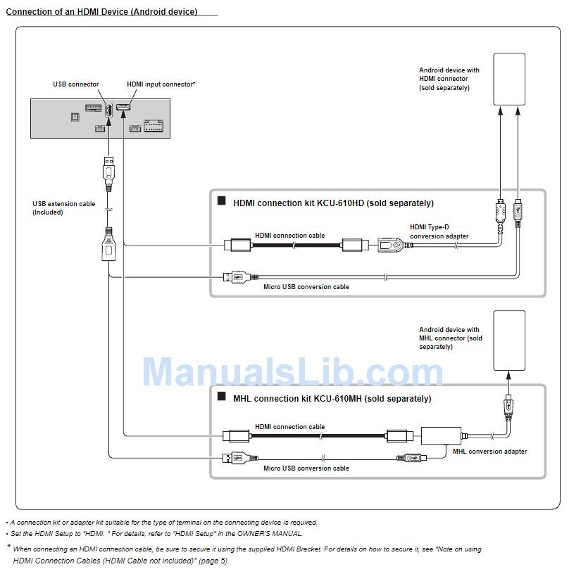

    Which cable do you guys use to go from a note 8 to radio? Does it mirror the image on the screen? Can you connect the factory back-up camera and the alpine junction box to a alpine front camera?

    How do you stream video from a note 8? USB-C to HDMI? Or do I need a converter to do so?

    I think there is a way to do it with some adapter. I dont have it, but I do have a firestick hooked up to the HDMI port and I can get video that way. Maybe a USB C to HDMI cable will work?

    Here's how to connect HDMI
