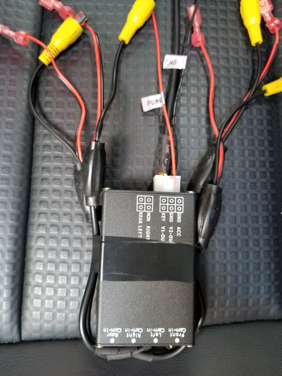

    I'm also planning on putting in a camera switcher, but the alpine cameras are so damn expensive. I'm planning on going with this 4 camera switcher for $39 and maybe putting a camera on each side mirror somehow, in addition to a front one.

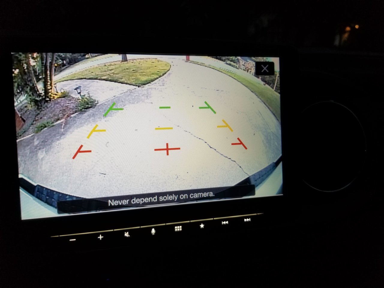

    Also, do you still have the rear camera's parking lines? I'm tempted to switch mine out just to get rid of those lines so I can use the much higher resolution ones built into the Halo9. The rear camera is powered by 6v and 4 wires so it would have to be a 6v camera unless you run another line. The wires also have reverse voltage...the black wire is 6 volts higher than the red, weird.

    I still have the factory lines and camera. The factory camera resolution looks like crap on the screen. I might replace it later

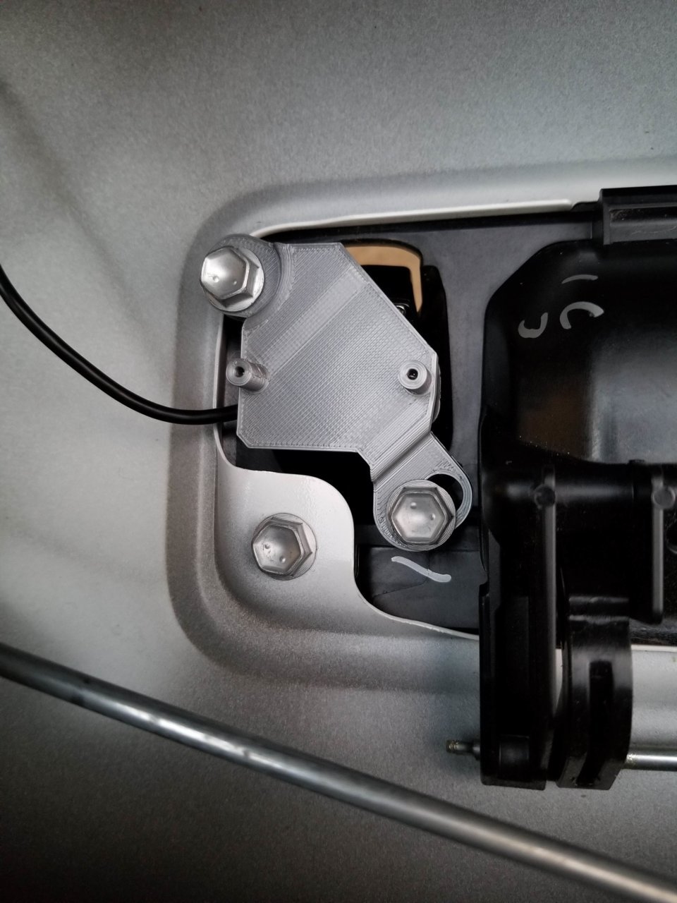

    I'm planning on adding front and side cameras, so I installed a switch box. I can set it to switch to left right when I activate the turn signals or any camera manually with a little 4-way switch it comes with.
    I also went ahead and changed out the rear camera to get rid of the factory guide lines. I made a 3D printed bracket to hold the new camera in position.
