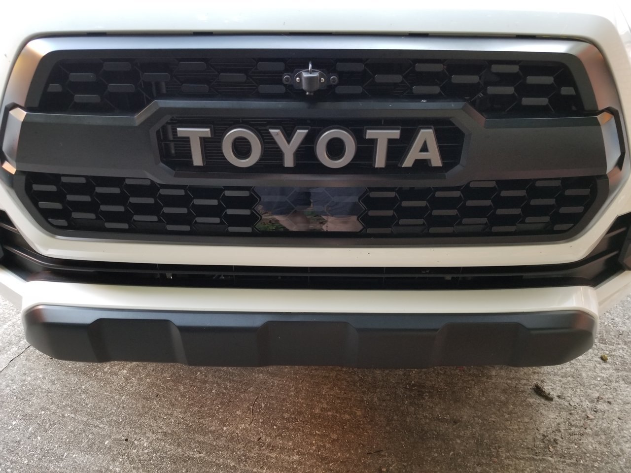

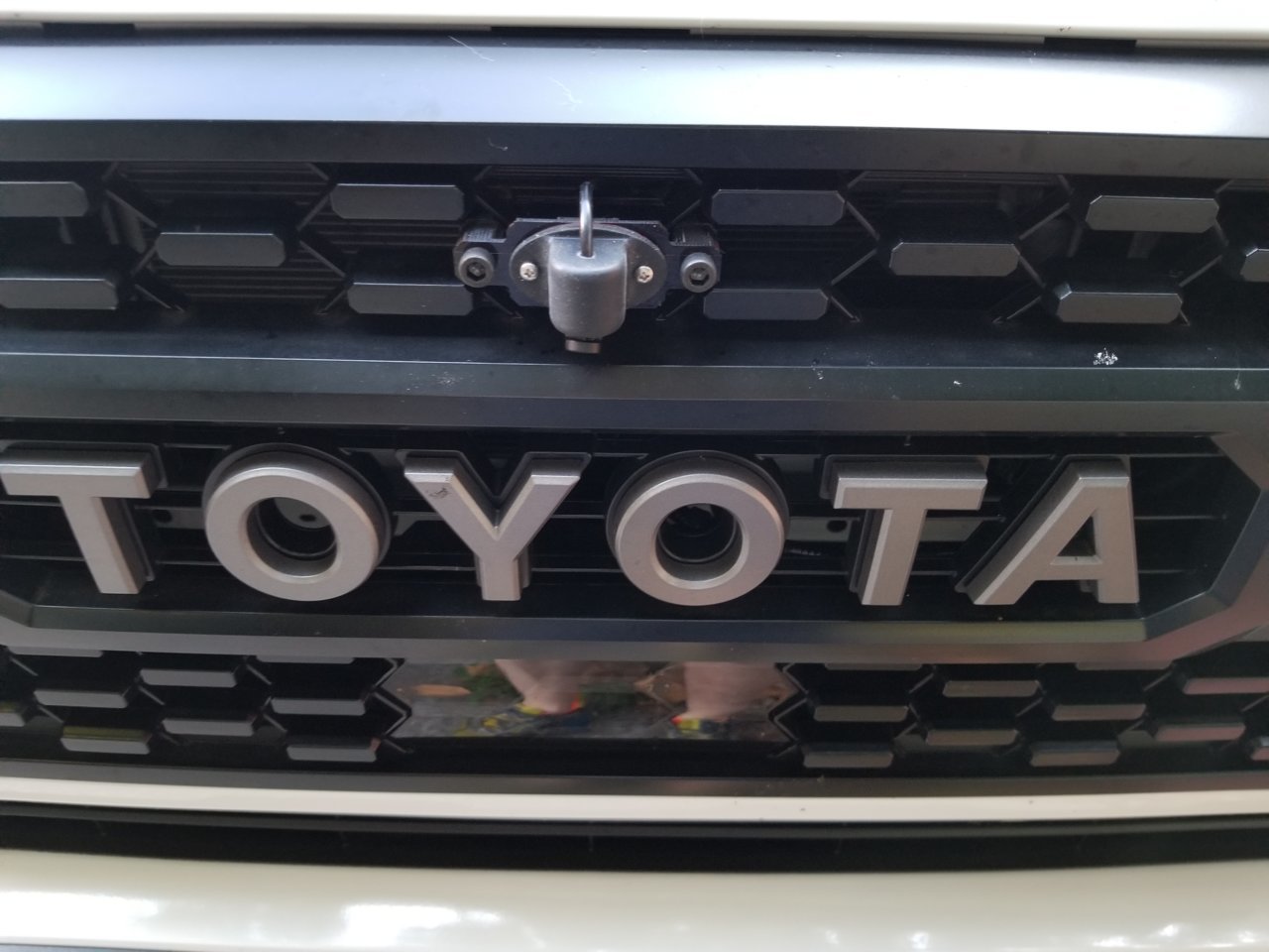

    I finally got around to putting the front camera on. I made a bracket for it in PETG.
