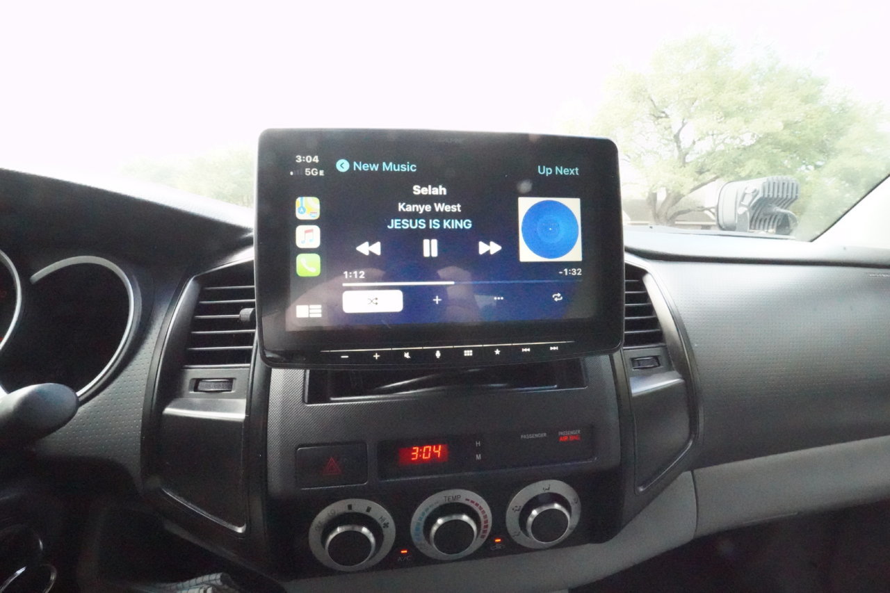

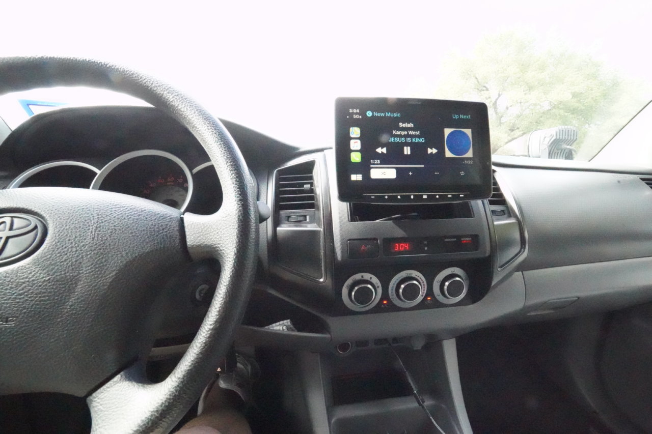

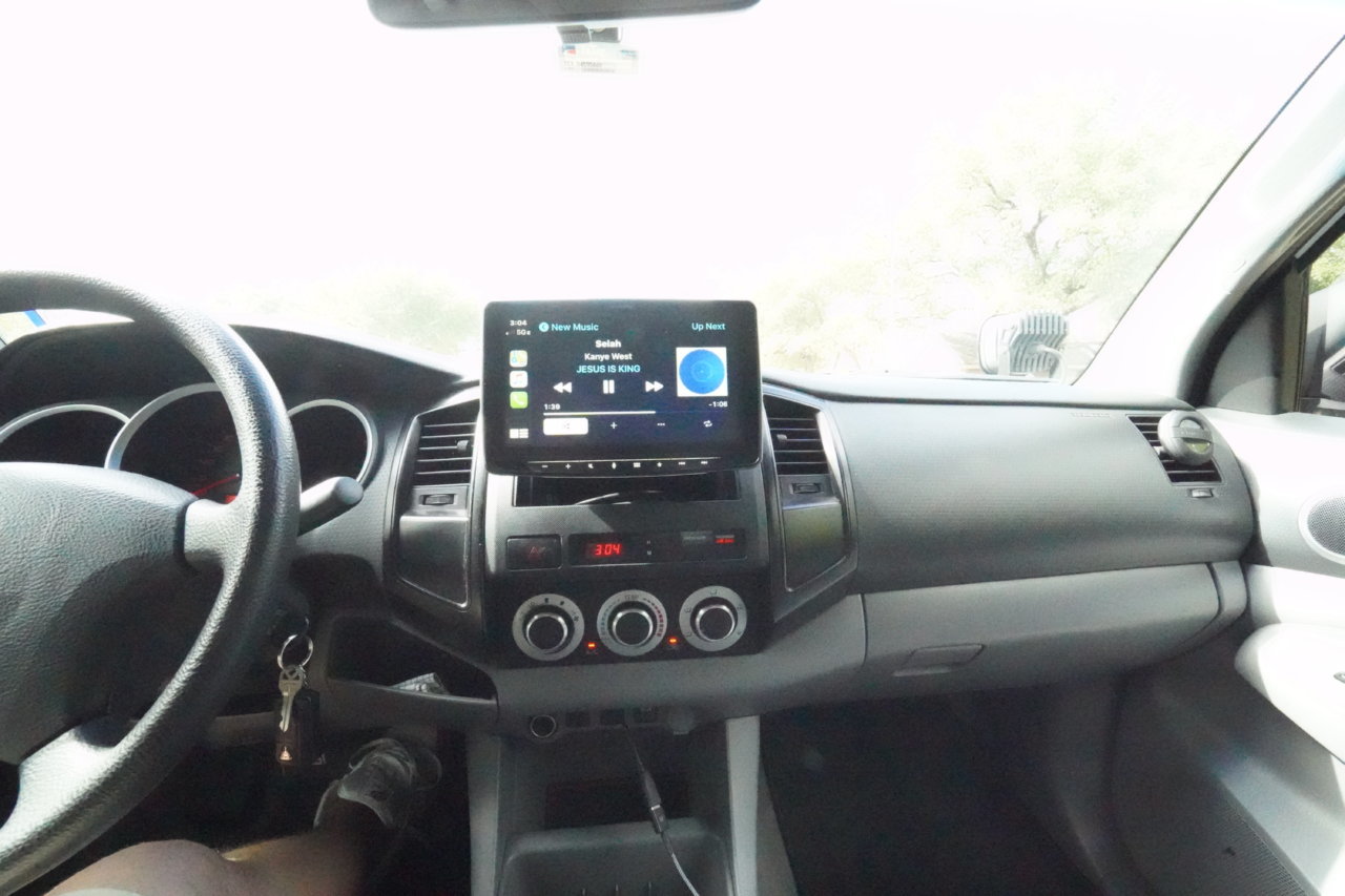

    0D6847D0-53D9-4EEE-9250-C4EE81F87F70.jpg I’ve had it for 2 days and I’m liking it a lot!! I didn’t wanna mount it up too high but tried to keep it around eye level.. it can be seen from the front but unless you know what it is, you won’t know what it is haha, I used metal brackets to mount it so cut the vibration(bouncing) to a minimum, although I haven’t taken off-road on bumpy roads the shaking isn’t noticeable..
