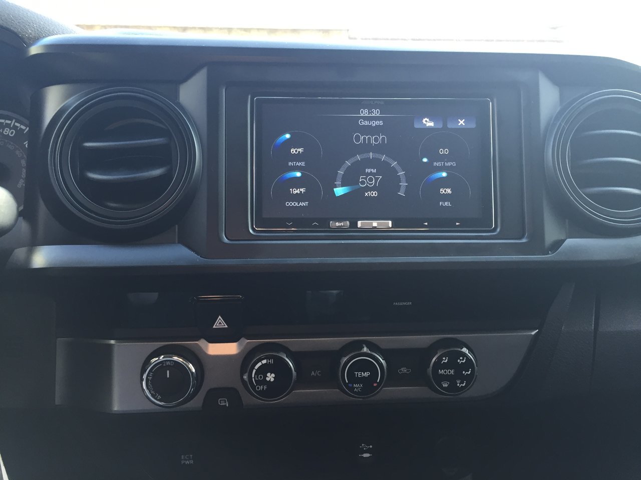

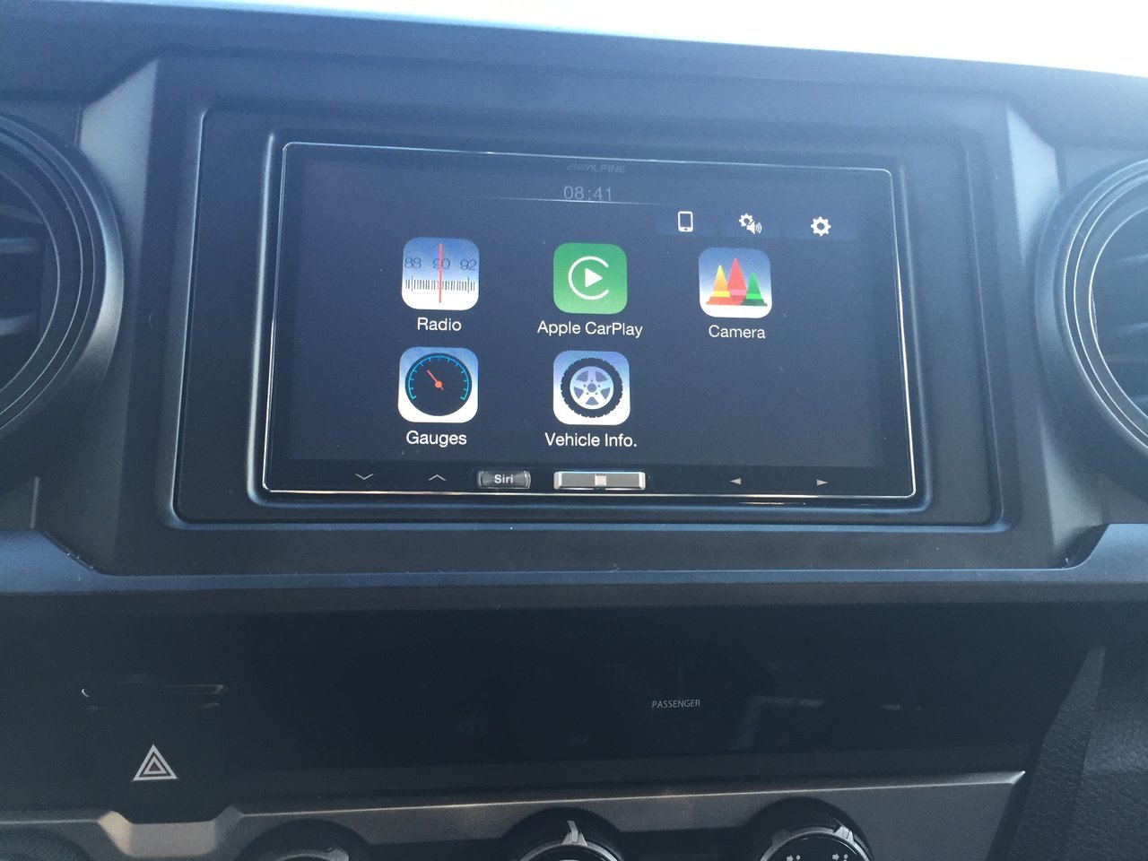

    I picked up an ILX-107 and installed it into my SR. Pulled out the basic entune radio which was lackluster. Install was easy with the Maestro datalink kit. Uses wireless CarPlay and adds vehicle info with live tire pressure. Sound is markedly better and customizable. It was expensive - $850 ish out the door. Definately worth it.IMG_7772.jpgIMG_7775.jpg

    I had the Base Tacoma SR radio. The base is very basic without any vehicle info or bells and whistles.
    Everything works with the swap except for the factory microphone. The Alpine included one which is actually clearer than the OEM.

    I got it from Crutchfield. The only thing that didn't work is the factory microphone, but the one the alpine provides is better. Having the gauges is awesome.

    Could you show images of the vehicle customization screens? I want to see how they show up on the alpine
