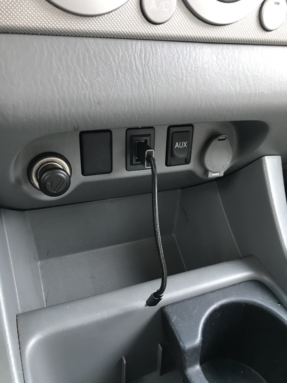

    my truck didn’t come with a stock usb adapter. will any of the “charger” ones from Amazon work?
  6. Dec 24, 2019 at 11:02 AM
    #126
    destin_meeks
    destin_meeks I used to fix people's crappy stereos
    Jul 14, 2017
    #223997
    3,687
    Destin
    Tuscaloosa, AL
    2017 SSM DoubleCab TRD Off-Road 4x4
    Most of the chargers wont. They will have red and black wires for power, but they don’t connect to the radio. Look for the ones that show the male end of the USB.

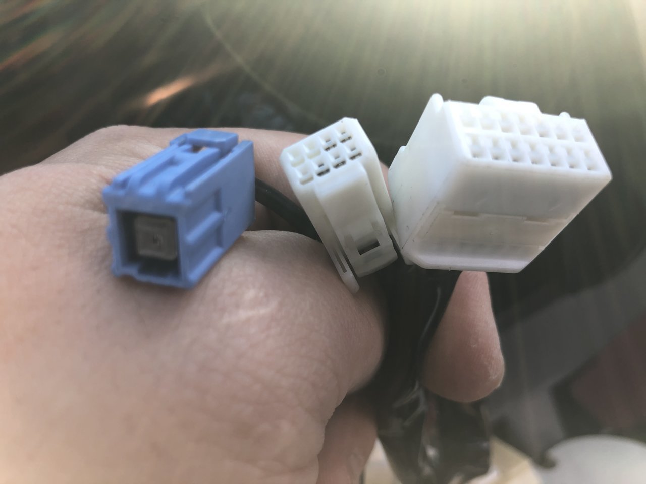

    hooked mine up but no steering wheel controls or backup camera working. i have three extra connectors not being used from the module, which is normal for my truck according to the instructions and twostock plugs not being used (below - one is for the hazard cluster). the light on the module is red. the switch is set correctly for alpine. i have also tried resetting all of the controls. am i missing something? am i supposed to buy the cam-ty11 separately?
    edit: i’m getting a new interface as mine seems to be defective. that’s why no steering wheel controls. no backup camera in the head unit because my truck doesn’t have the proper wire to connect to the head unit.

    I installed mine with the idatalink maestro. Overkill, but I might upgrade down the road and figured I’d be ready that way. Anyway, every plug from the factory was used on mine. The 20 pin white connector runs the steering controls.
    I used a usb adaptor from Amazon that plugged right into the blank locations by the cig lighter.
