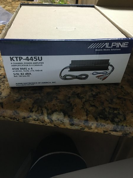

    Good news for you, I went out and bought it so I guess I'll be your lab rat. It seems pretty self explanatory if you're okay with cutting wires behind your H/U. I'll be hooking it up tomorrow after work.

    I installed it today and it has my vote, took me about an hour to hook it all up

    What did you do for the yellow power wire?
    1. What did you do for power for this? Did you wire it directly to the battery or grab power somewhere else? Either way you are using that entire yellow wire, with the black box attached (it has some sort of power conditioning loop in it)
    2. Did you have to put a 15a fuse in it (what type) or is a fuse only needed when you wire it directly to the battery from the battery terminal?
    I was looking over the install procedure for this and couldn't find anything concreted about that fused yellow power wire. If people are tapping into power behind the dash somewhere are they still putting a fuse in there? Does it need one no matter what?

    I connect directly to the battery and I only didn't add a fuse to it. Idk about your but mine seem to have super glue on the little cap so I just assumed I didn't bed one since the amp already had a fuse? And still a little confused on where to tap in the remote wire ?

    Yeah, I discovered after I forced it open that it has a bit of glue holding it shut...and that's where my confusion comes from. It clearly states that when you run that wire to your battery you need a fuse...So I opened that up and there is a slot for a fuse in it under that cap. But if yours is working and you never opened it then that fuse would serve no purpose...So it must be necessary to install an in line fuse between that black box and the battery...according to the directions...
    I think I am going to send an email to alpine...because I think people are installing this without a fuse, as you did...the fuse in the power pack isn't sufficient to protect your truck. That entire wire could overheat and catch fire if the amp goes bad before the fuse blows...and you could have a fire. The fuse at the head of the power tap from the battery would protect you from that.
    I am looking to use it in 90W x2 for my speakers...
    Did you tap right to the batter and then run the wire through a hole in the firewall or did you tap into a + spot inside the truck?
    Thanks for replying.

    First off be very careful because there is one remote wire on the amp that stays free to chain to another remote amp or powered sub's remote in...you don't connect that to anything. I've read where people connect it to another remote wire and fry things...In the instructions it says
    "Remote Out Lead (Blue/White)
    Use this lead to turn on additional amplifiers."
    The remote turn on wire that is with the RCA cables would be the remote turn on wire you would use as an INPUT for the amp, but the AMP has a special sensor that should turn it on when it detects signals sent from the head unit (radio) to the amp. In the event that your amp isn't turning on then you might have to connect the remote on wire to the remote out of your head unit (if after market) or wire it to the 12V wire from your factory radio, check your wiring diagram of your radio harness to tell which it is, but it should be a 12V non-power wire...it's the 12V ignition wire (I think) it's one of the 12V's...But the amp should sense your radio...
    The blue and white wire on the OTHER harness is and output so if you installed a powered subwoofer under a seat you would find a way to connect that wire to the remote IN of the subwoofer so it would turn on when the radio turns on...
    BTW here is the power cord with no fuse...I am in contact with alpine...

    Called alpine today...the guy said there is not fuse needed in that black box on the power line...it's not used...it was going to be but they scrapped it...The only fuse needed is if you tap into the battery directly you have to add your own fuse before the yellow line...
    I can now install with sanity..

    Yea I grounded it to the readio ground and seems like I'm going to have to add a fuse since I wired it to the battery. Thanks for the updates
