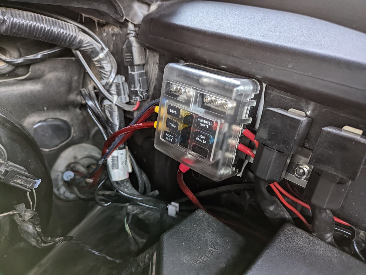

    So I'm running a completely different amp, but I'll butt my ugly nose in. :cookiemonster:
    For running power to the battery, I did this:
    Cheap fuse block. It keeps everything tidy and easy for (hopefully not) future troubleshooting. My amp tucked behind the dash so I used a small 14g wire to feed it.

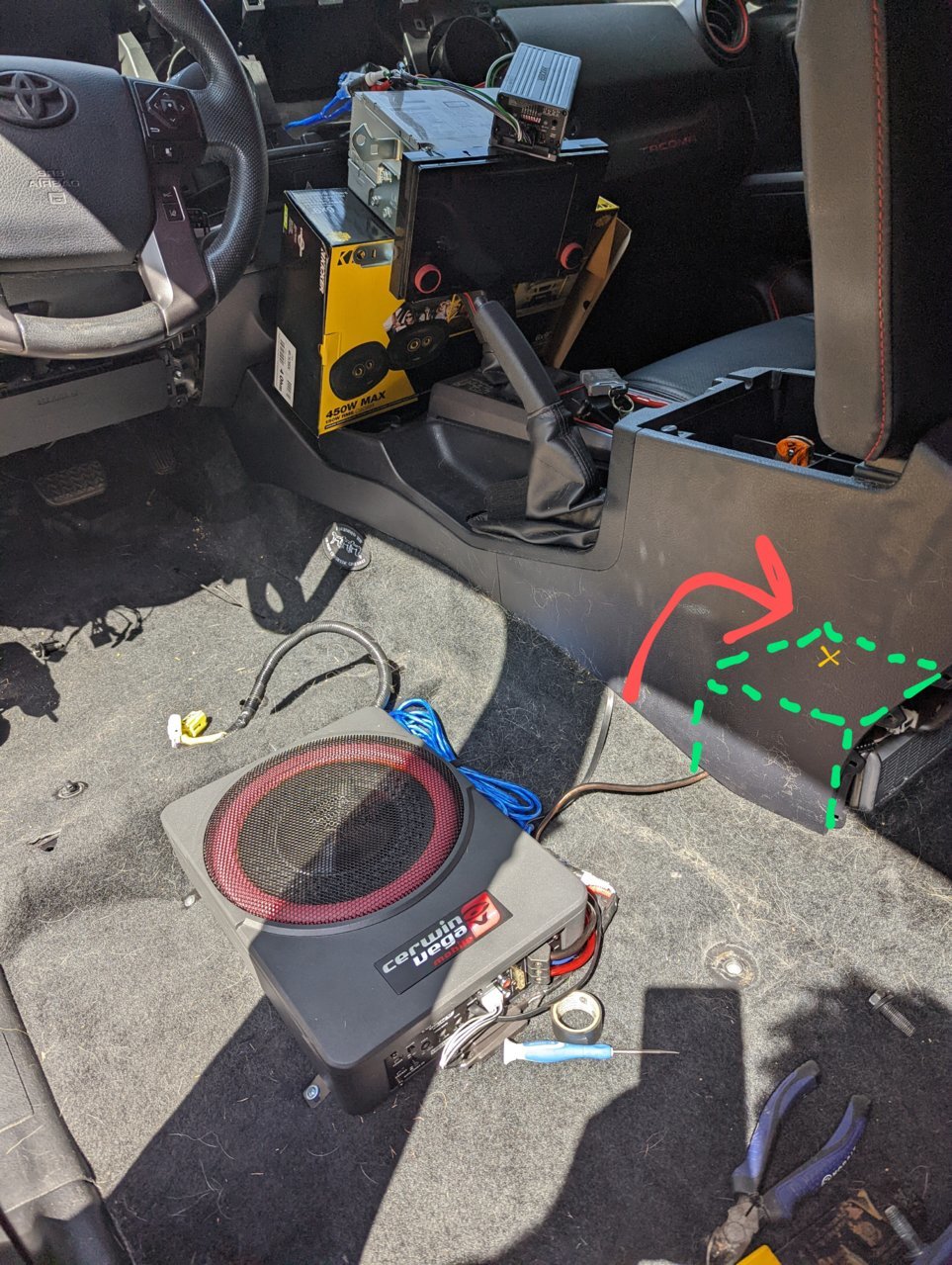

    For running to a ground, there are many, many ground points hidden throughout the vehicle. The basic strategim is to pull a panel, look for where the stock electrics are grounding, and piggyback off of that. In the dash there are two metal columns running up the center. You'll see some ground cables tied to it about halfway up, next to the climate controls. If you're mounting yours under seat, there's a ground point under the center console storage box, the frame where the 120v inverter ties to.
