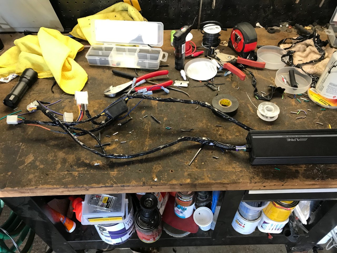

    Yeah, I just have the power pack amp (KTP-445U). It's a pretty easy install. Harness took me about an hour to make and maybe another hour to pull apart the dash and install the amp. I added my amp behind the dash. Plenty of room in there as outlined in the other threads.
    I got a great deal on the amp (99 bucks) but if paying full price would get the kicker key. Same price as power pack but it has a microphone and auto-adjusts. Not sure how well it works in a car but my home stereo does this and it makes a noticeable difference.
    Here's a pic of my completed harness. There's only 4 plugs to hook it up the stock stereo (the clear plastic ones at the top). Pull two plugs off stock stereo, plug into harness and plug the other two back into the stock harness and done. This can be 100% made on a workbench and no cutting at all of factory wires. I also added some spade connectors that you can see and those go to my sub (4 for line inputs and remote turn on).
