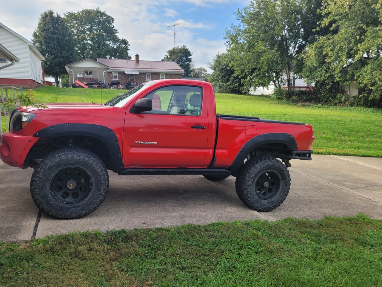

    Bought this truck off a member on here recently. Already mostly built, but starting this thread for the rest. Plan is eventual SAS and fj case swap. Spring should see 37's on it.
    2007 SR5 regular cab
    35x12.50R17 trail grappler m/t
    4.88 gears
    ARB locker front/Detroit rear
    Bamf lca skids
    IFS skid
    Rock sliders
    Bed bobbed 8 inches and high clearance with bumper
    Fox ifp suspension
    Rockmen uca
    Relocated cab mounts
    Fenders trimmed two inches
    All pro leaves rear
    Timbren bumps tops
    U bolt flip
    Shackle flip
    Nice stereo of unknown origin(lol)
    Fumoto drain valve
    Parts I've added/adding
    4xinnovations tube bumper front
    Dobinsons snorkel(to be installed)
    High lift mount in bed

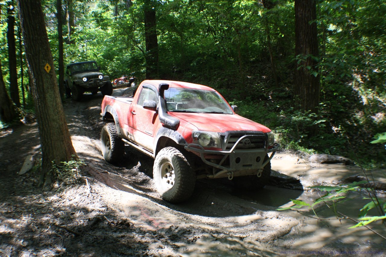

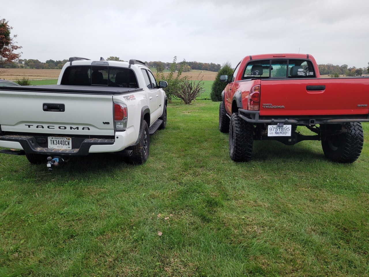

    Pic next to brothers stock 21 offroad...my future truck in another year.

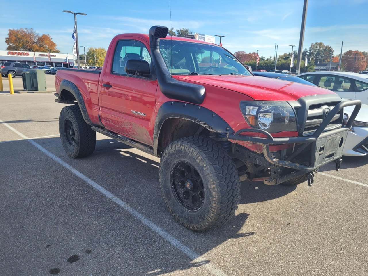

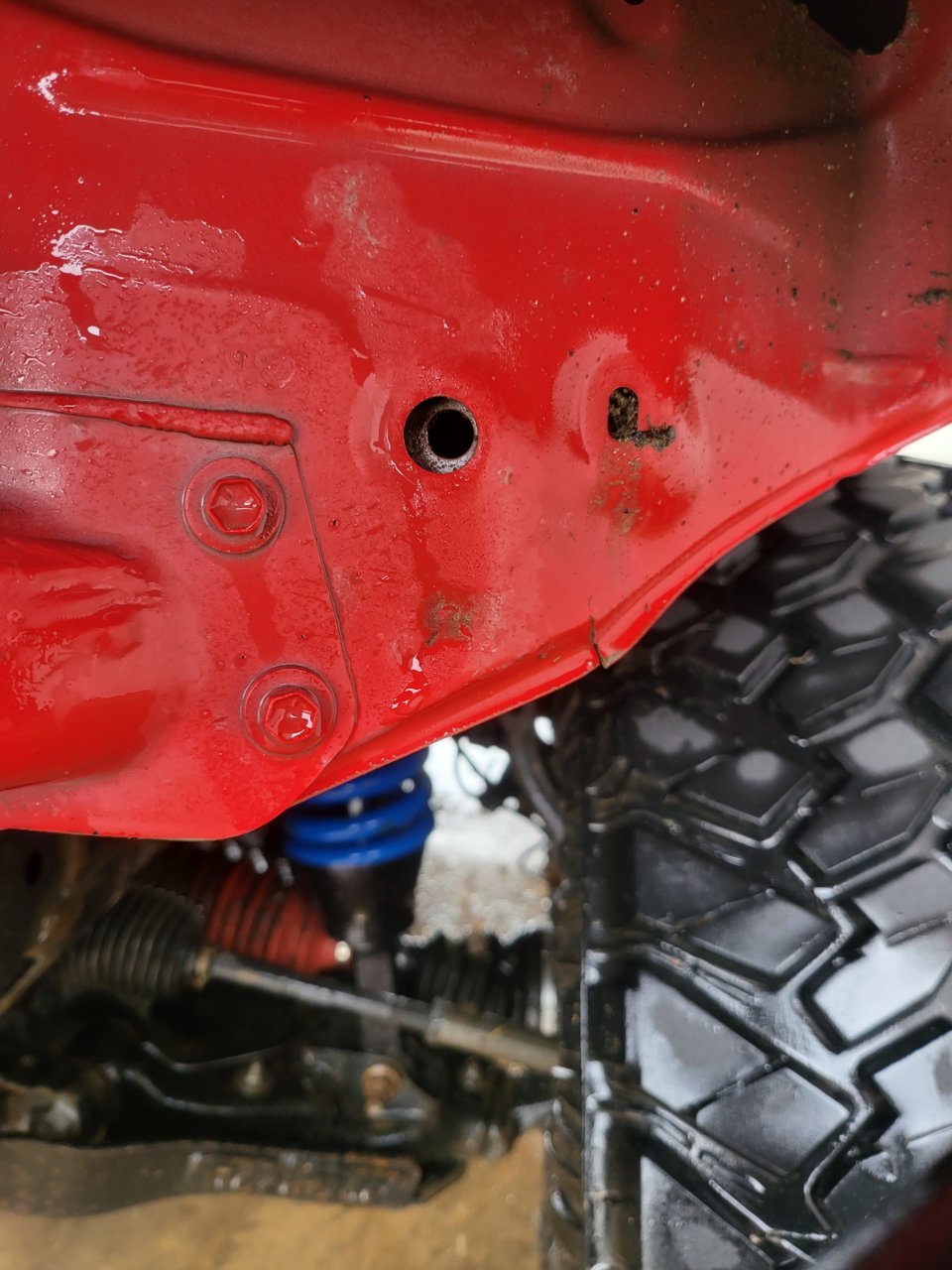

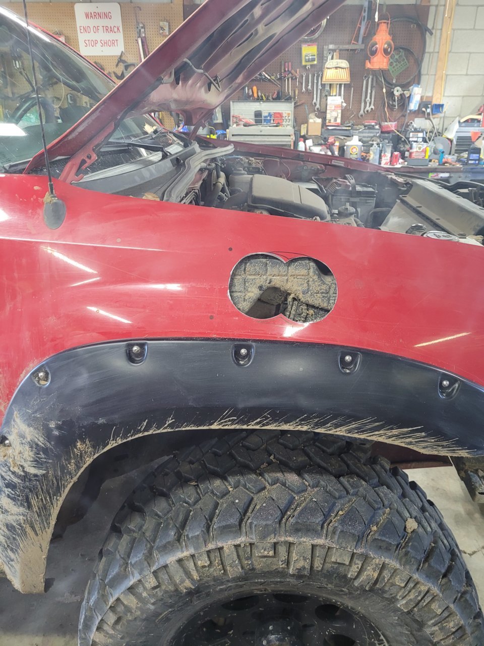

    Threw on a Dobinsons snorkel today. Not bad, but was nervous cutting holes in the body.

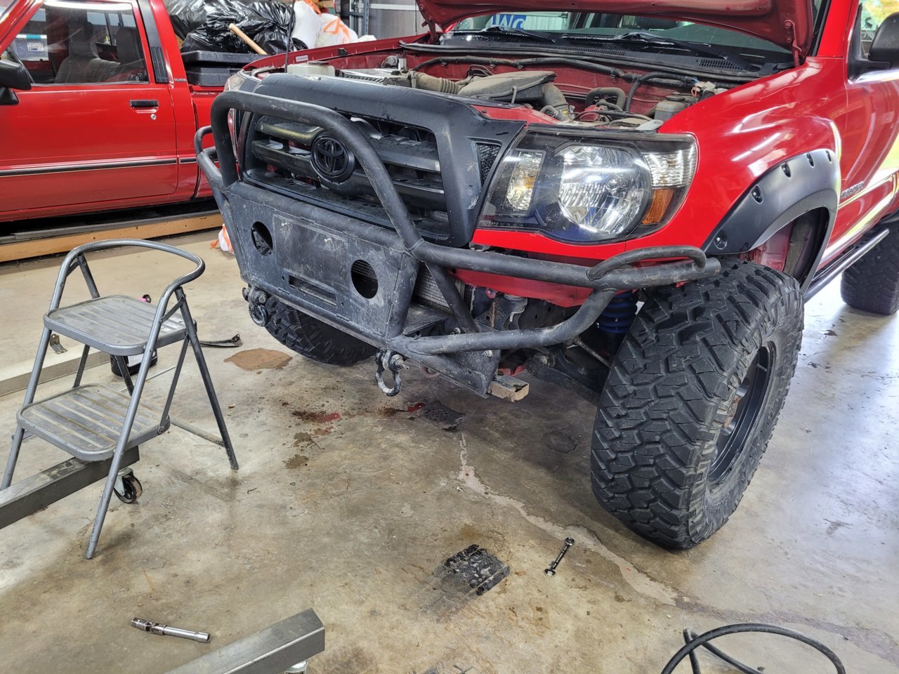

    Well, just maintenance today. Those 35's take a toll on the front end. New tie rods, wheel bearings, cv axles etc.

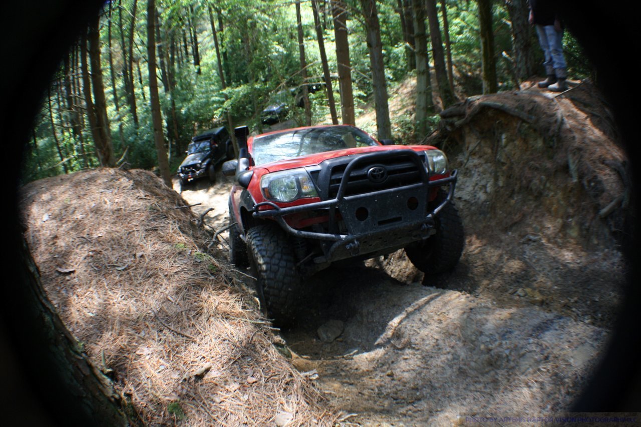

    Took her out on the maidens voyage. Two days of wet wheeling at Interlake, Indiana. Made it up butthurt hill(left, rocky line). Video is demo only to show the hill as I didn't have anyone to film me in the rain.
    https://youtu.be/FwQutBURDPc
    Observations:
    I need to do a SAS
    I need 37's
    More up travel is needed in the rear
    Rock sliders are your friend
    I need to fix my core support
    Michaelo likes this.

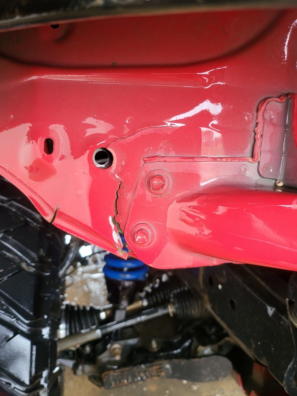

    Those are nice, but I don't think will solve my issue. I've got tons of fender clearance so no fender rub. However, the springs on the front are ridiculously stiff. I'm going to a softer spring, and I think I'll build an inner core support frame work. I think that combo will prevent further tearing

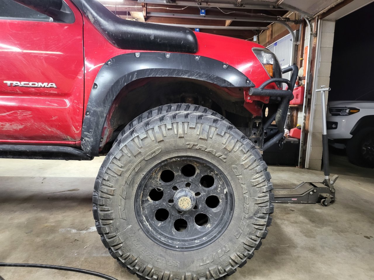

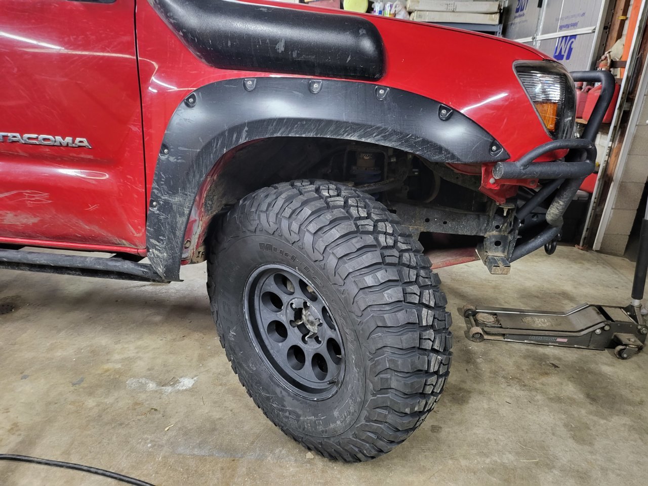

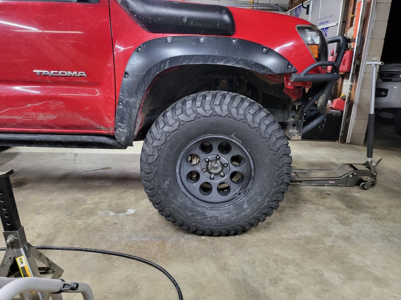

    First real "mod" on this one for me. Swapping to 37x12.50 BFG's. Second Pic is of the 35's I had on before.

    I will massage the cab mount a touch, but otherwise fine.

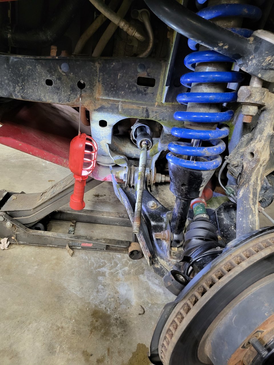

    Part upgrade, part repair...throwing these in later today.

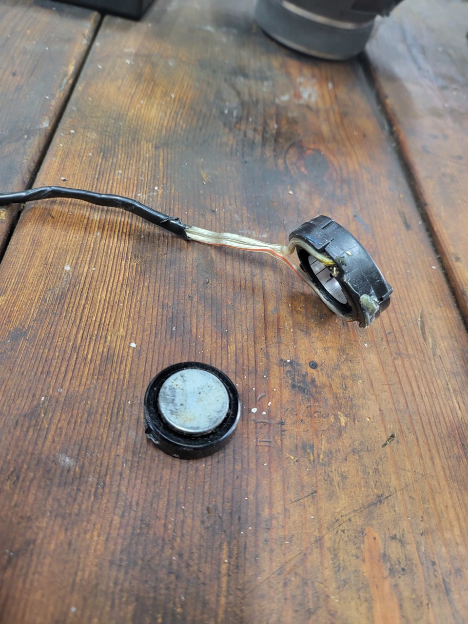

    Got the speakers installed. Sounds MUCH better. I replaced due to a blown 6.5 on the passenger side...guess the drivers tweeter wasn't doing much either.

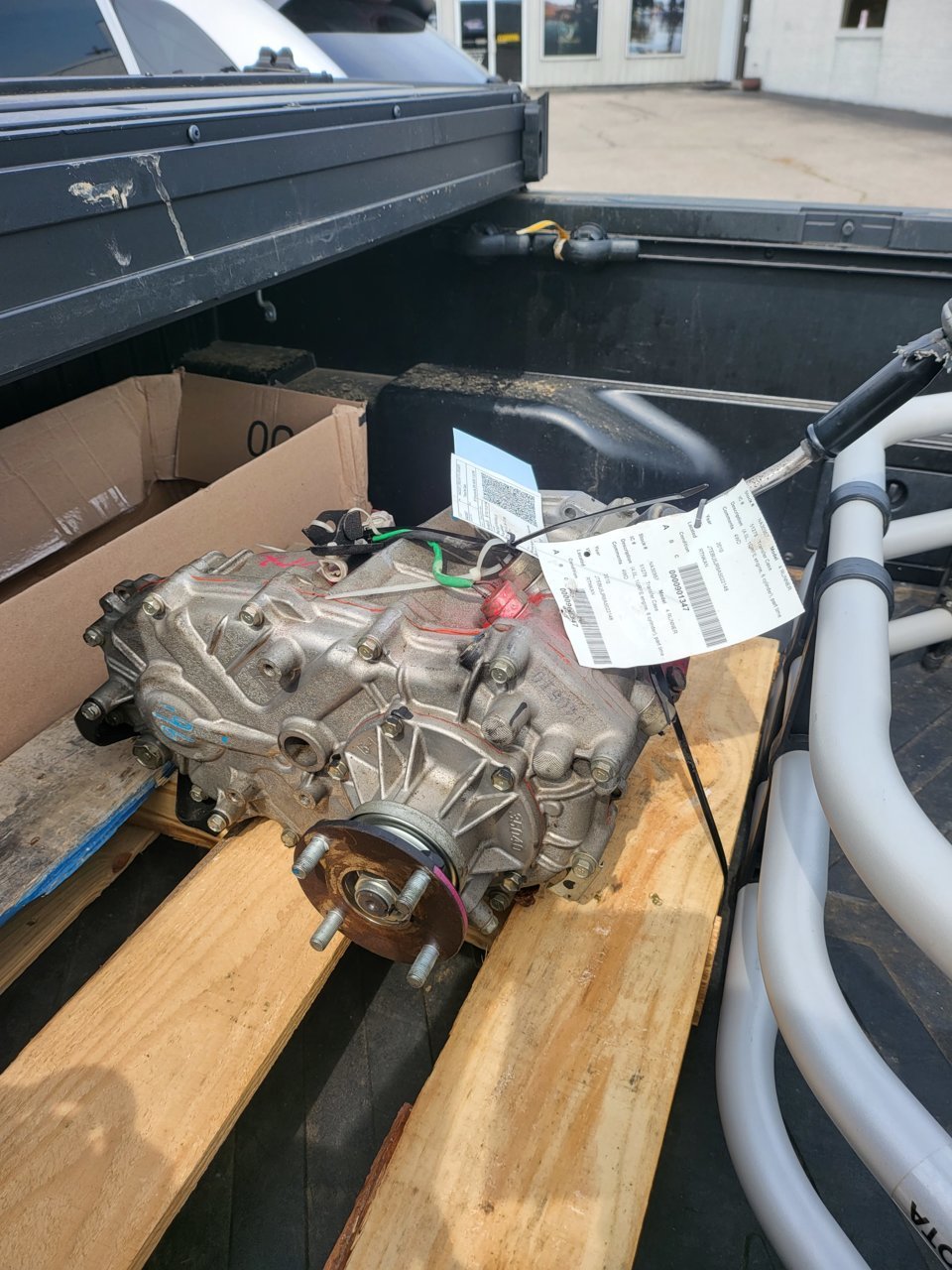

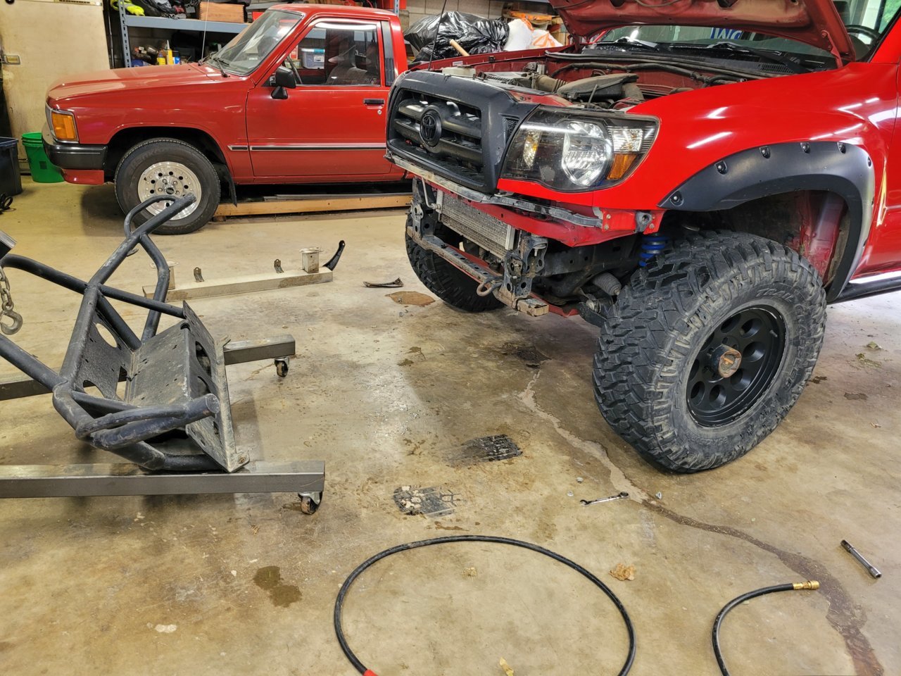

    What could this possibly be for?

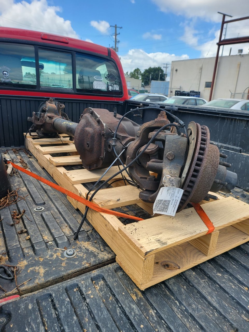

    And more surprises coming...going dana 60 front/sterling 10.5 rear
    TimberTiger likes this.
  20. Aug 10, 2023 at 9:56 AM
    #20
    super_white
    super_white Well-Known Member
    Feb 6, 2012
    #72230
    8,188
    Harry
    Connecticut
    2012 Tacoma 4X4
    In the Taco?
