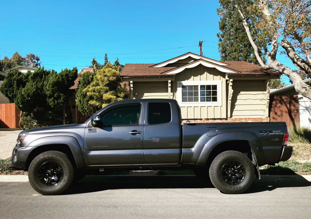

    Here is Bilstein 5100's on 0" with OME 883's and a Headstrong Offroad 1.5" AAL in the rear:
    Since you have a 2" AAL I would go with the 884's. Just note, the AAL's typically are 1.5" without the overload leaf in and 2" with the overload leaf in. I left my overload leaf out to retain the 1.5" rear lift.
    JW2011[OP] likes this.

    Thanks very much, I was unaware of the possible need for longer brake lines so I'll do some research on that!
  6. Apr 14, 2021 at 7:59 PM
    JW2011
    JW2011 [OP] Member
    Dec 7, 2019
    #312780
    15
    That's very helpful... I have an overload leaf in right now, so with that information you've provided I'll have some options (take out the overload) if the back is too high. Thanks again!

    Wow, that looks fantastic. I think I'll install the AAL, add regular camping weight (roof top tent, cooler, etc) and see how it sits... might turn out I wanna be using a 885 or 886. Very helpful, thank you for replying!
