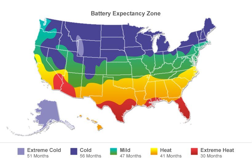

    Replacement time should be by region, not the battery's warranty period. Being in the "cold" region, I replace every 5 years before winter.

    Well, it doesn’t seem like you drive much based on year and mileage. Short trips without any time to recharge are the
    Worst thing you can do for a battery. Take it once a week or every other week on a long drive. Also hot climates significantly shorten the lifespan of a battery
