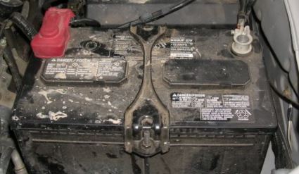

  17. Oct 18, 2021 at 3:19 AM
    #17
    willtill
    willtill Well-Known Member
    Nov 18, 2007
    #3502
    761
    Maryland
    2018 Cement Off Road V6 Access cab
    I pulled this image of a stock 'Taco battery off the 'net. These battery caps are removable:
    tacotoe likes this.
  18. Oct 18, 2021 at 4:06 AM
    #18
    Skydvrr
    Skydvrr IG: @kalopsianick
    Sep 13, 2017
    #229889
    12,652
    Nick
    YMH
    Black '17 OR
    Nah I don't think there is. Only a light if the alternator shits the bed.
    tacotoe likes this.
