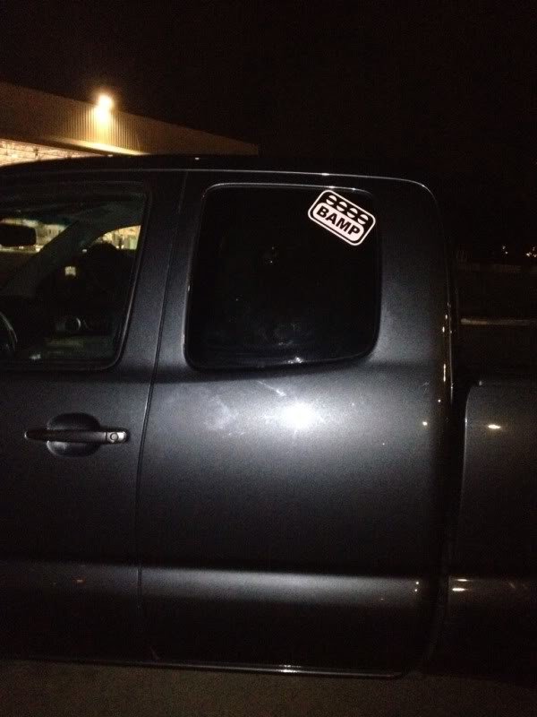

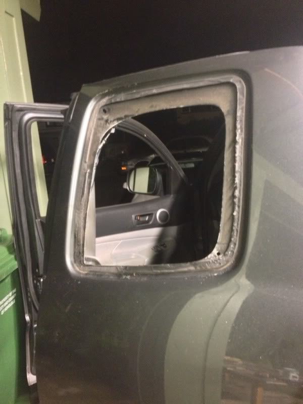

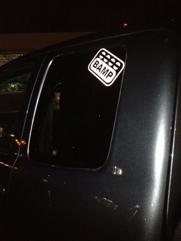

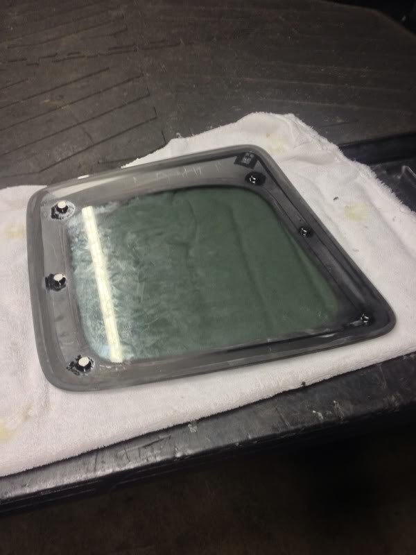

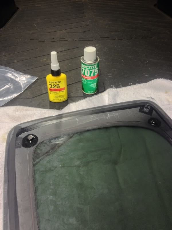

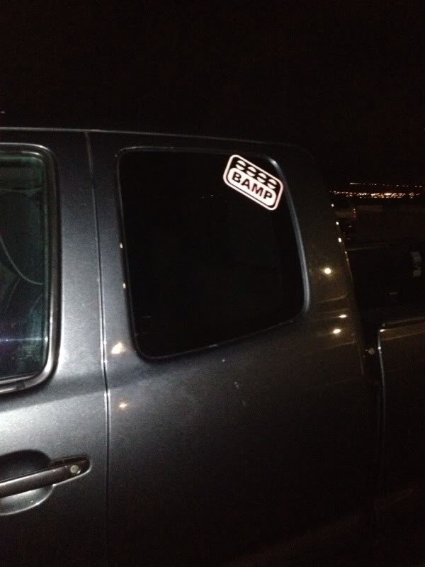

    Well since toyota decided to make the access can windows fixed and I like my dobermans to ride inside I made the windows removable. The adhesive is specifically designed for magnets to glass. Now you might be thinking...fucking magnets?? Come on man. Well these magnets have a 14lbs pulling force. EACH!!
    Now I'm not done with the project. I still need to get some proper seal and keep an eye on the window for a bit. It takes some serious ass to pop it out. At any rate here are the pics. I will post up better ones after work.

    Interesting... I like the idea but not sure about using magnets. I guess I wouldn't spread the word aorund that your truck is only kept secure by magnets but on the plus side, you'll never lock yourself out of your truck!

    It's probably very difficult to pry it from the outside. (even if you're not worried about scratching the paint with whatever you're prying with) Looks like it would only be feasible from the inside.
    Cool concept though.

    Well if you try to pry the window out from the outside you will most likely break it. If a crook wants to get in they will.

    I did think about latches, first off you can't drill tempered glass. And then I was gonna use lexan, the real issue was the latch attachments on the inside. I searched for hours and hours for the perfect latch. Then magnet popped into my head. Few more hours of researching magnets and adhesives for magnets to glass.

    I doubt that the 14lbs holding force on the magnets would be enough to keep the glass secure in a collision. Those kinds of accidents generate a LOT of force.

    That's 14lbs per magnet. So 84lbs currently holding the window in.
    I agree it might fly off in a collision. I didn't think that far ahead. I am gonna test it more. Off road and such. The beauty is if it starts slipping under harsh conditions I can add more magnets.

    Why can't you install the latch to the glass with adhesive?

    I could, but I couldn't find a clean latch setup. What makes it difficult with a latch is the inside door panel.

    Now the challenge is taking it out without dropping it.
    Oh and how is the wind effect in the cab while driving without the side window.

    Does it leak?

    I see that, but collisions and sudden stops sometimes rate in the high G forces.
