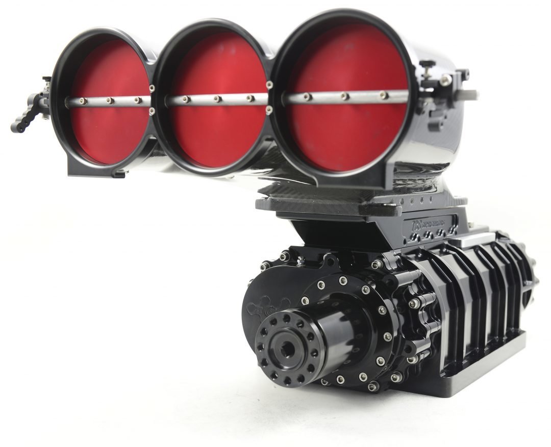

    How much more air would you like?
  3. May 20, 2019 at 6:26 AM
    Alaba4.02006
    Alaba4.02006 [OP] Well-Known Member
    May 14, 2019
    #293292
    63
    That blower would tip my yota over
