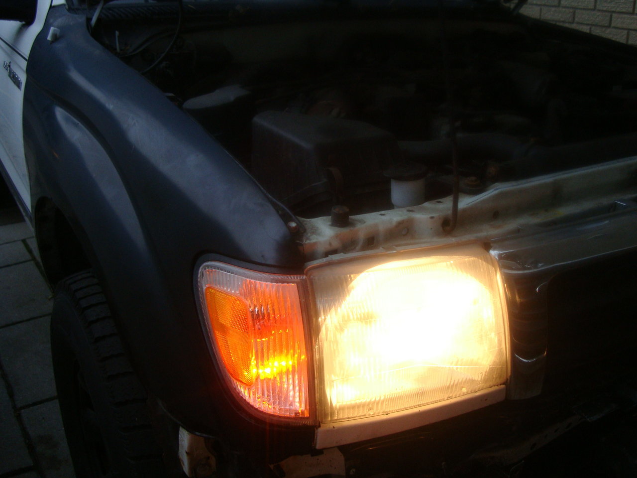

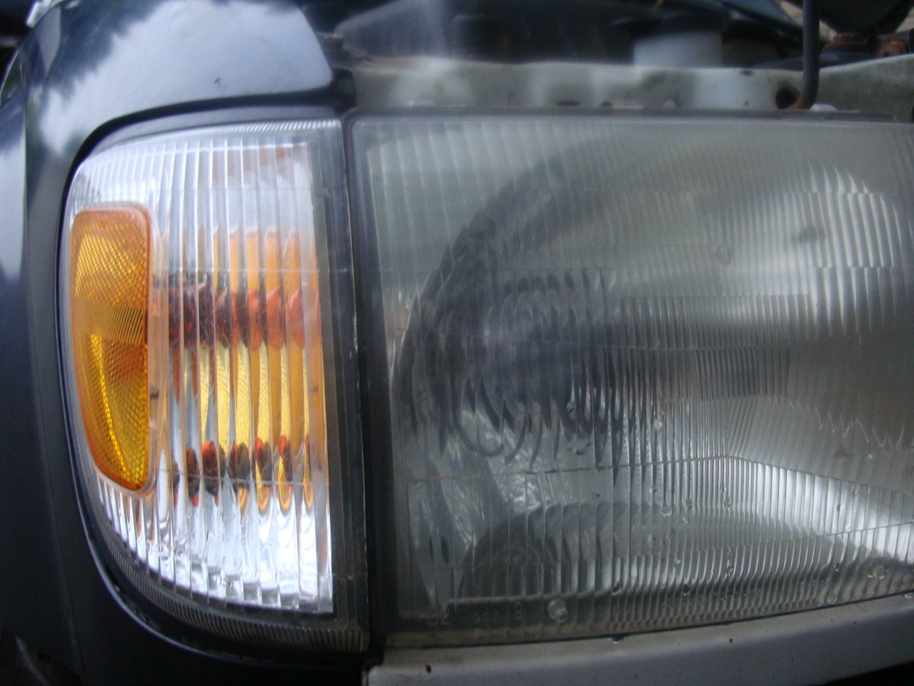

    First, here's what it looks like:
    corner light only

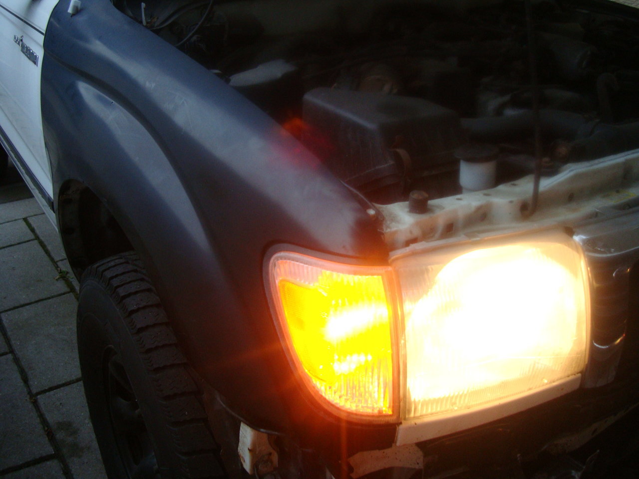

    with the blinker on

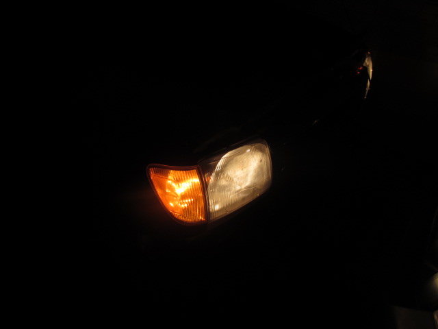

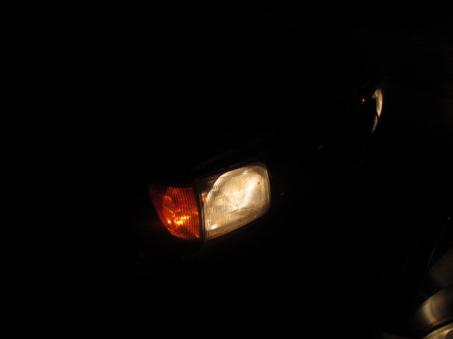

    at night:
    corner only
    corner with blinker

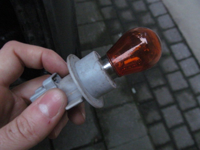

    Turn signal socket and bulb
    File down the tabs around the socket that are used to lock it in place into the turn signal housing. File it until you have a smooth and even circular surface:

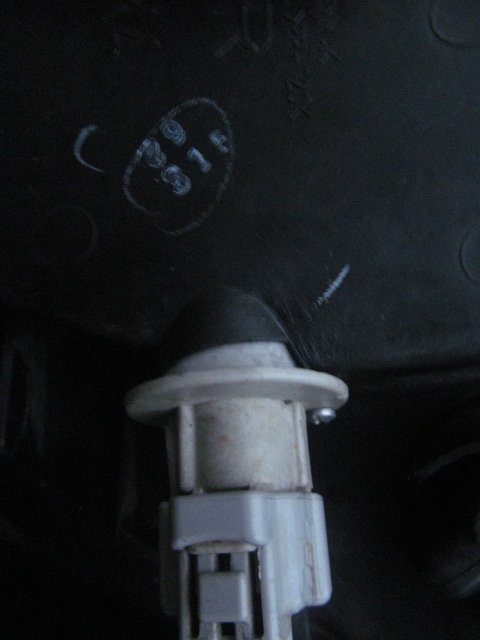

    Then you'll have to file the hole where the smaller socket for the corner light was so the turn signal socket and bulb will fit in. Basically, you just file down the part where the locking tabs for the corner light socket were latching onto. File it untill the edge of the circular dip this part was coming from. Don't file it too much, so the socket fits tight and snug into the hole
    You will now be able to push the blinker bulb and socket in untill it stops at the circular lip around the socket, like this:
    Then to make sure it stays in place, put a small screw through the socket's lip (it should stay in place on its own, as it is fitting tightly in the hole, but just in case, I put a small screw).

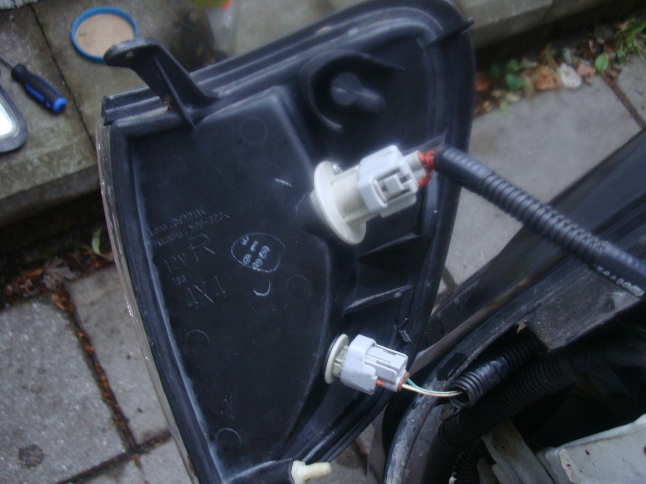

    Corner light bulb and socket

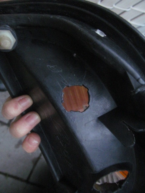

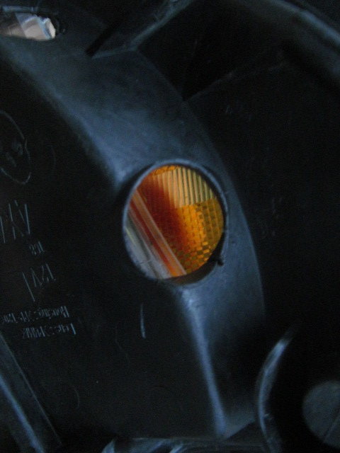

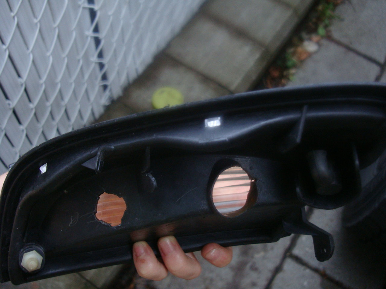

    Now, drill a hole the size of the corner light socket (tabs not included) then cut out (or file) the edges so the tabs will fit in, allowing you to lock it in place:
    Now your housing should look like this:
    To clean the plastic dust inside the housing, put some water in, shake it good then empty it. Do this a few times and the dust should be gone. Then let it dry or blow it dry and reinstall it on the truck
