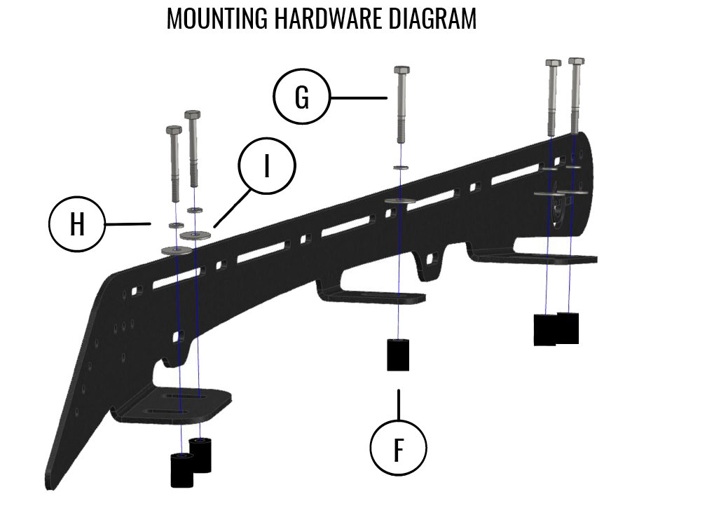

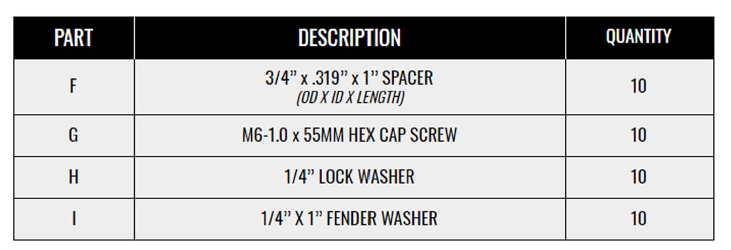

    Does anyone know the size of the spacers (and maybe where to get them) that go from the prinsu "rails" (not really rails, but front to back) into the factory bolt holes of the roof? They seem about 3/4 OD and about 1" length. I am also curious what size bolts that are used to mount it into the factory holes... seem about 5/8 and 2" long. (I am mounting to a 2nd gen 4door tacoma, if that maters)
    I am completely making my own rack and this thread has been helpful in finding a lot of hardware... Thank you everyone.

    So the spacers are 3/4 x .319 x 1 but i cannot find them. I might be able to make them. Won't know for a few weeks when I can get to my metal supply shop. If they can be purchased from a supplier, I'd prefer that.

    I'm nearly certain the bolts are metric, not English

    here is the parts list right from the Prinsu instructions:
    Screen Shot 2020-02-06 at 12.15.43 PM.jpg \

    Thank you so much... Yes, I forgot to say I found the Bolts, they are M6 55mm long.
