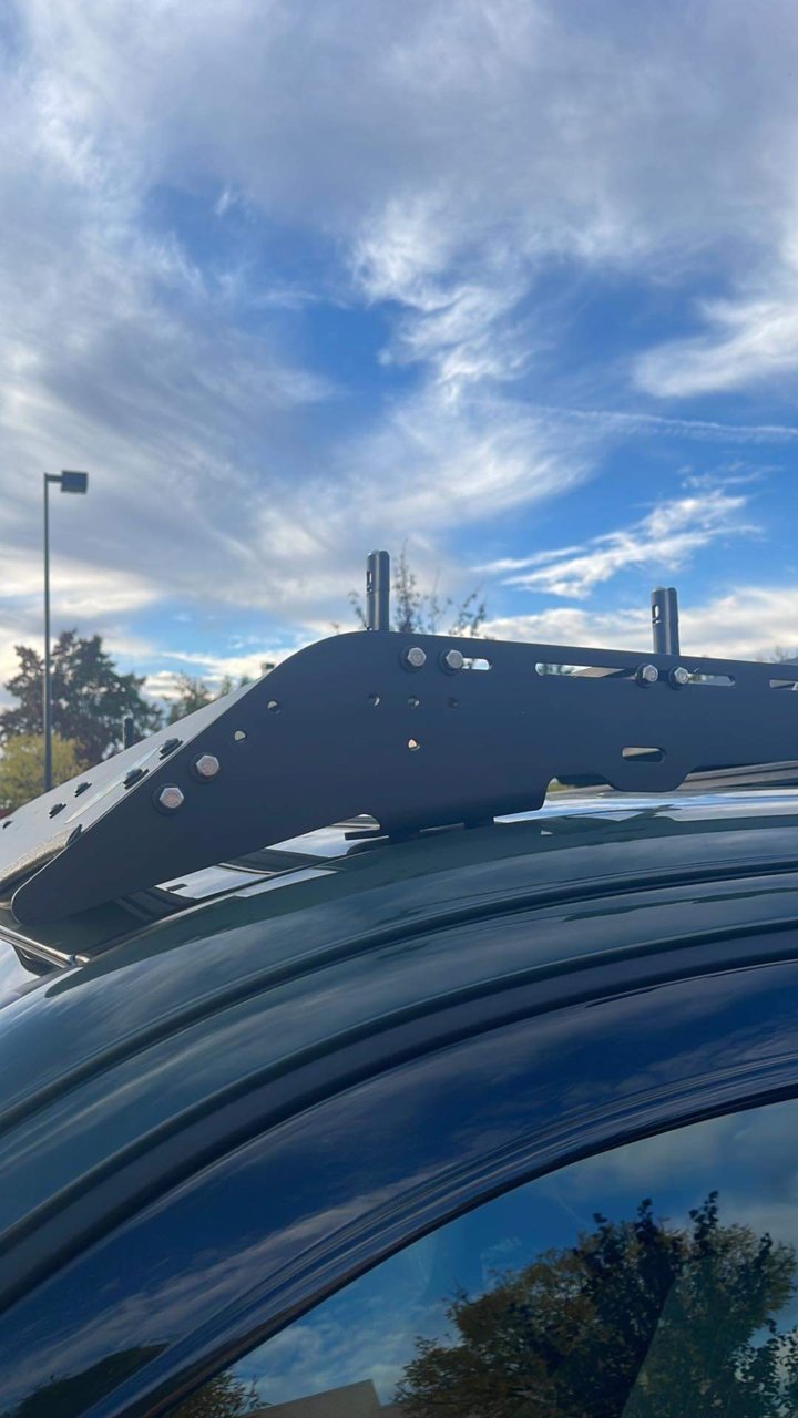

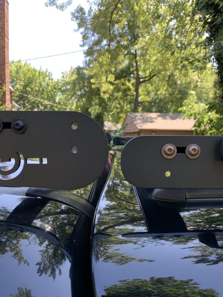

    Hey folks. Looking for a 1 inch black ss spacer to flush my top rack with the cab rack. Suggestions?
  10. Mar 9, 2025 at 12:29 PM
    #150
    Roofy
    Roofy Well-Known Member
    Mar 20, 2014
    #125794
    127
    Virginia
    '14 Sport 4x4 DCLB
    Bilstein 5100’s, Vision Wheels, slotted StopTech rotors, TRD pads, SPOD, Decked Drawers, N'Fab Steps, Leer Cap, KC Highlites 40” & Cyclones underbody and under the hood, Rigid Scenes mounted to Prinsu Rack, anytime LED Fogs, TacomaBeast headlights, RAGO bed stiffeners, USB-C rocker in cab & 2xUSB in bed w/anytime on option, Alpine Head Unit, Front Camera.
    Don’t kill yourself looking for black stainless. Consider taking the powdercoat route on something cheaper. You’ll get more options for fitment and can match the Prinsu color & texture better.
    hope that helps

  12. Mar 14, 2025 at 1:21 PM
    #152
    METAC
    METAC Member
    Oct 10, 2023
    #435224
    13
    2nd Gen TRD
    Appreciate it all. Interestingly, all the top rack hardware quickly oxidized and turned reddish yellow. The cab rack hardware still looks brand new.
    Appreciate the feedback. I’ll find something from McMaster.
