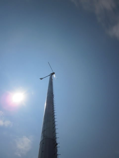

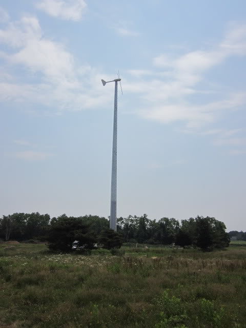

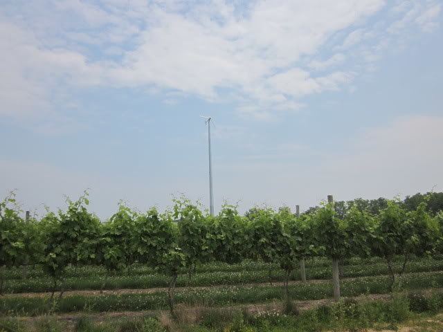

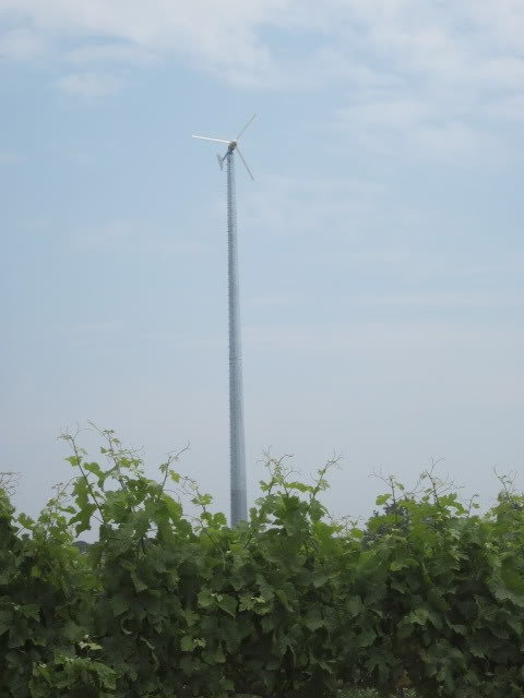

    A few pictures of one of my recent projects. It is a Bergey XL-S 10kW unit on an ARE 120' MonoPole. It should produce around 16000kWh of power per year.
