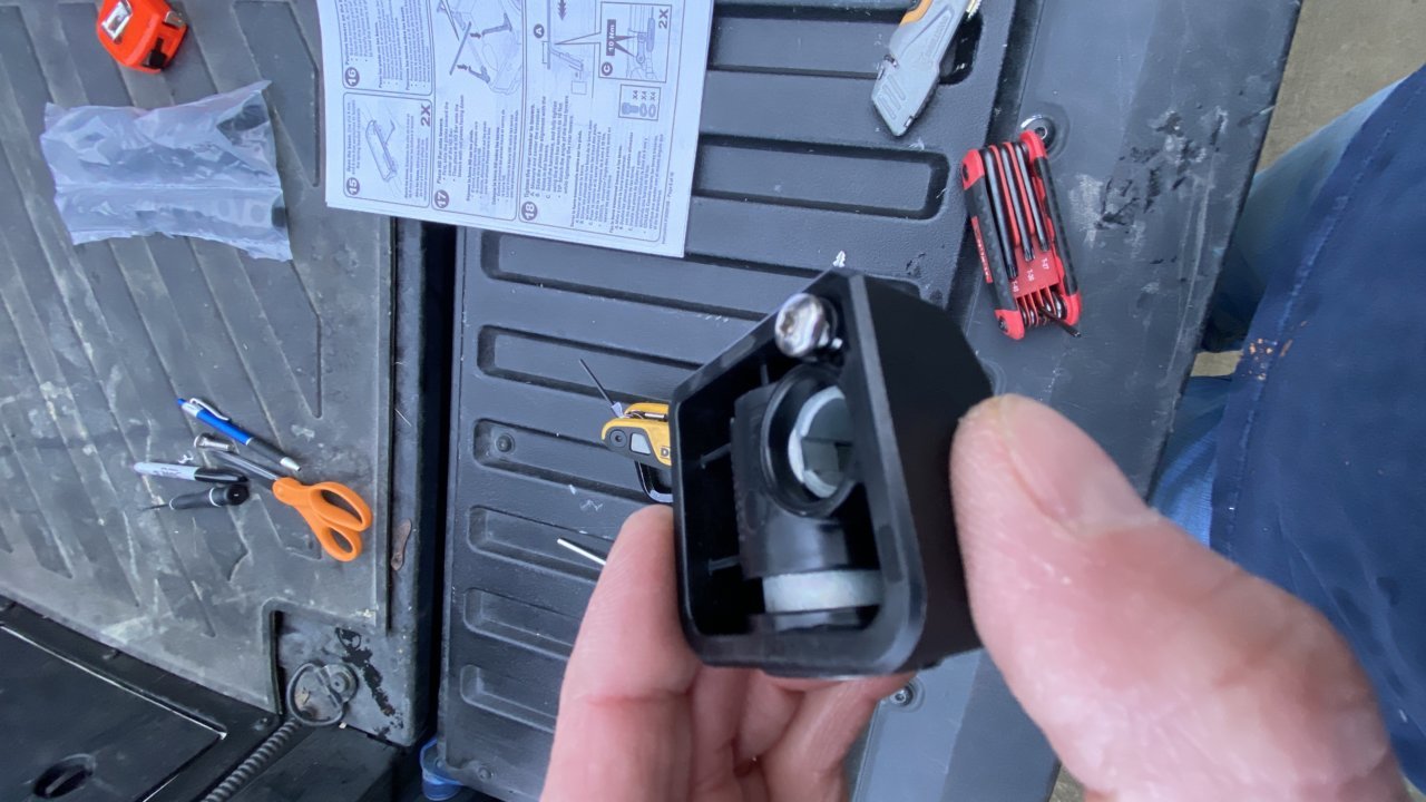

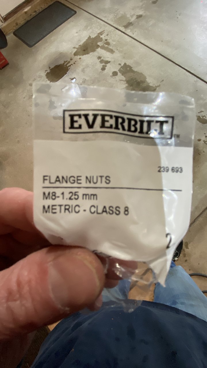

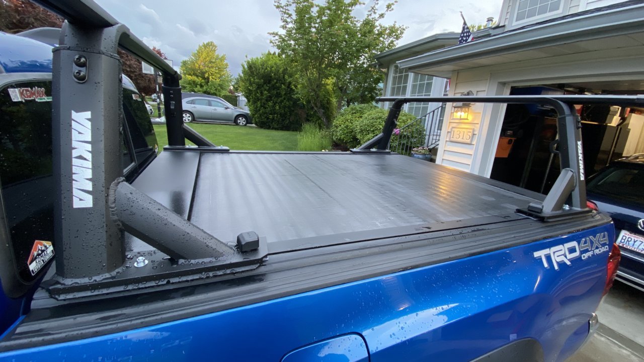

    Update: There is a small screw on the locks that keep it from rotating if you attach normally. You need to remove that to use the locks. But save it for when the Yakima adaptors become available. The lock will spin freely around the pin once it is on but it is locked. Photo of the nuts I used. Bolts are 8mm - 1.25mm. See photo of the bag. Cannot remember the exact size of the carriage bolts I used. Bring the locking pin with you to size it. But match the length below the flange on it, not the overall length.
