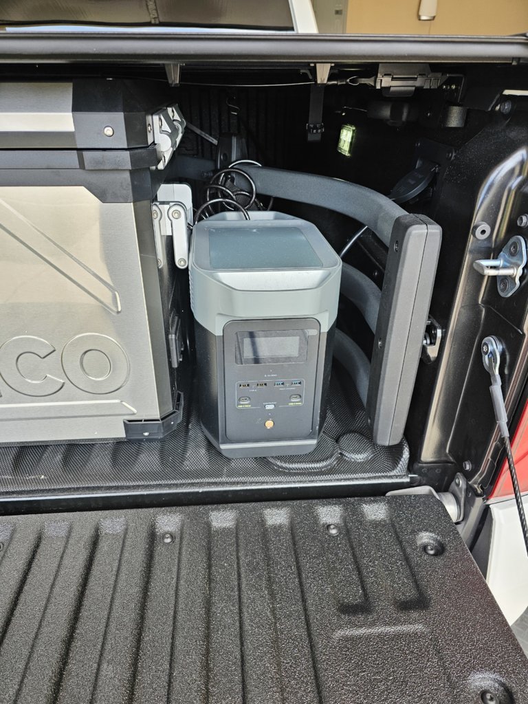

    I would like to start a brainstorming session for alternative power source to power aux lights. Let me start by saying that I have a hybrid model and my battery is underneath the rear seat. Also my truck didn't come with aux switches. I have purchased an auxbeam ar600 switch control unit to control some lights that I like to ultimately buy and install, baja designs reverse lights (not purchased) and possibly some roof rack light bar (not purchase). I would like to install the ar600 to control those light and install the main brain somewhere under the hood and bring 1 line in the cab for the switches Because my battery is under the rear seat, getting positive 12v cable from battery to switch is no easy task. I started to think that since I have a ecoflow power bank delta2 in the bed there has to be a way to power that switch from the delta 2 and leave my truck battery alone. Has anyone done anything like this? I am thinking if I bought a 12v cigarettes lighter like this i can plug one end in the delta 2 and the other end on the ar600 switch. All I would need is connect the fused power to a fuse box. The questions I have, will those wires handle the amp draw? Most people who connected lights say they connect them to 10 amps. So it looks like it would handle it! Let me know your thoughts.
    Also on the other hand, the truck has it's own Cigarette lighter plug on the left side of the bed. That could be another way to power the switches.

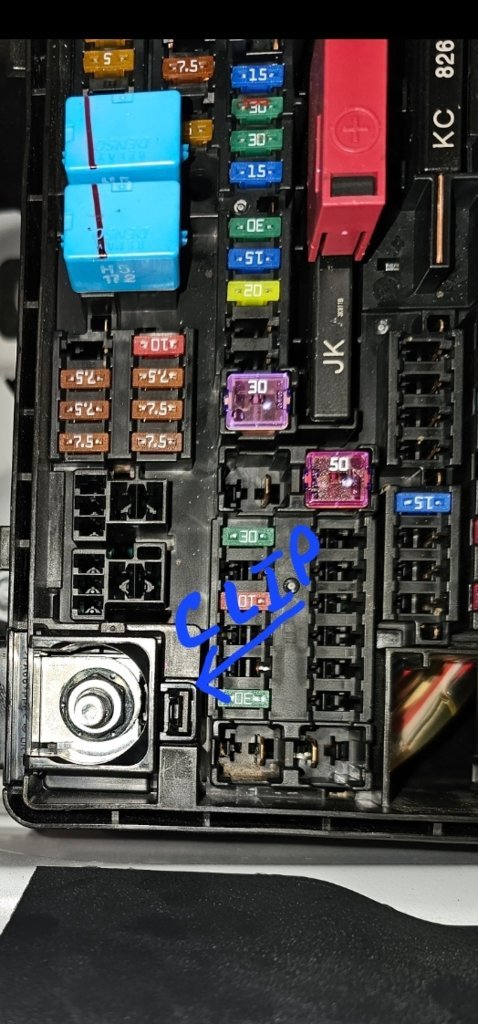

    I don't have a hybrid, but note in the video where the guy attached his (ditch?) lights. There's a hot post in one corner.

    Yes, I just saw that and I checked on my car. There is a plastic piece acting as a cover that could be removed so wires can reach that post. It has 1 clip where I have the screw driver but I am unable to slip it out. There must be another clip or that nut has to also be undone for it to come out.Screenshot_20241021_162138_Gallery.jpg

    Isn't the bolt a hex head?

    That clip release the plastic a little bit but something else is holding it. Maybe the nut also needs to come out.

    You would need to loosen it to add a wire ring fitting.
