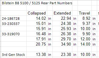

    Here are the numbers that I have. The top line is the standard 5100 rear.

    I have the 33-230337 rears. They are only 1in longer than Stock, but I didn't swap bump stops. I could have gone with the 33-319070 rears if I did. The Option 1 packs drooped out at over 2.6in more than the fully extended stock rear shocks with no brake line issues.
    AFAIK, all B8 5100s / 5125s have the same valving, but I could be wrong. IMO, my setup drives like a champ on and off road. Way better than the stock setup, loaded, normal, or empty.
    I would not fear the 33-319070 rears. You just need to do the collapsed length measurements / calcs.

    As for the Eibach shocks out back I know that Eibach talks about their shocks being for 1.5" of lift, but the shock's actual specs are 14.92" collapsed x 24.09" extended which is in line with the specs of shocks promoted for 2.5" rear lifts from other manufacturers.
    As for the 5100/5125 discussion we have been getting good results with the 5125 combo with the RXTs. The only thing that you have to do is slightly trim down the lower eyelet to mount properly. It's really not a big deal at all. As for valving the 5100/5125 are the same shocks, but just with different dimensions. Option 2 is technically a thicker pack then Option 1 since an additional leaf is being added in. This will move your bumpstop up further yet. @tonered have you got stock bumps out back?
    If you want 5100s we have a bunch of 5100 rears in stock here at Hotshot Offroad. 5100 fronts have been the problem... However, the other thing is that 5100s are not a side-specific shock so the shop shouldn't be struggling to find a "right rear" shock.

    The part number that I would recommend for your application is 33-230337. That is a Bilstein 5125 (aka an extended length 5100).
    The 070 part number is 16" collapsed which is just too long.
