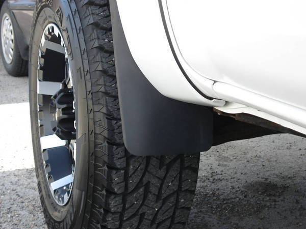

    I cut the stockers down for now. I tried to trim them where they were rubbing (on the part that "bubbles" out by the innermost bolt) but it wasn't working properly. I ended up cutting them fairly short where there is a faint mold line on the inside portion, and rounding the edges. I cut the portion that bolts to the innermost bolt right off about 1" past the pinch weld. Looks great! I already had a couple people ask me where I got them. I also bought some pro-fit #7 mud flaps, but I haven't had time to try to fit them...might not even add them if my modified stock ones do the trick.

    Sure, I'll see what I can do for you. They are pretty short...like maybe 3" but seeing as it's Spring/ summer, they seem to be doing okay. You could always trim yours a bit longer. Are yours rubbing in the same area...the bumped out portion between the inner most bolt, and the other bolt closer to the wheel arch?

  16. May 16, 2011 at 8:54 PM
    #16
    Fabulous
    Fabulous Well-Known Member
    Jul 17, 2009
    #19807
    831
    Fabian
    Calgary, AB
    2006 Tacoma double-cab TRD Sport
    Homertaco grill, Light Racing UCA's, 2.8" front lift (5100's at 0.85 setting and Eibach springs) 2" AAL with rear 5100's, Wet Okole seat covers fr/ bk. 17 x 9 Incubus Crusher wheels w/ 4.5" backspacing. 30% tinted front windows.
    As promised.
    There are a couple more in my gallery, but this best showcases what I did.
