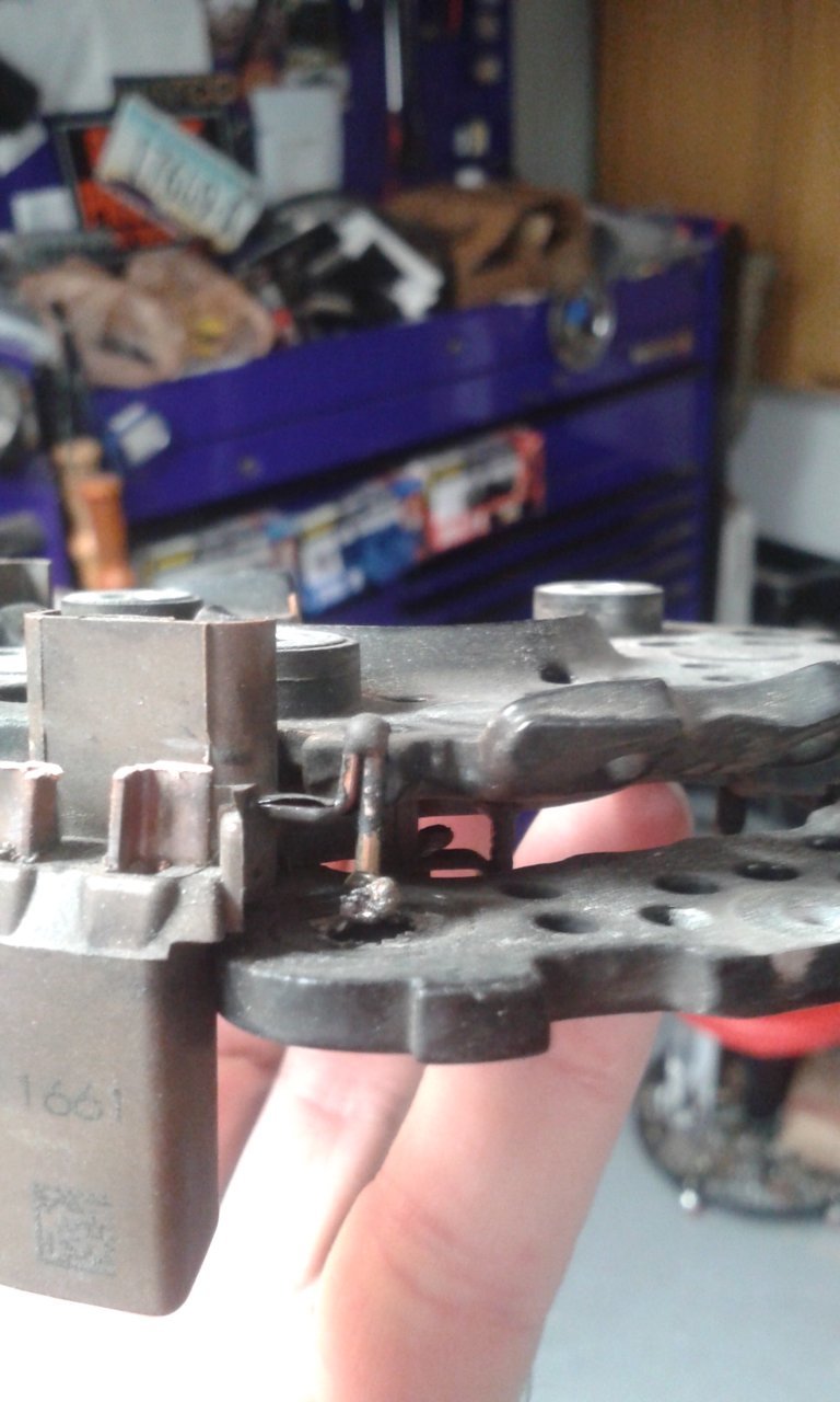

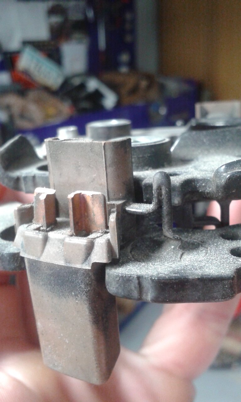

    Should look like this-
    Probably looks like this-
