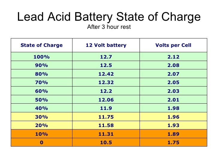

    Question:
    Do I want an ammeter or a voltmeter?
    Example:
    Alternator failure to charge, again we will use older carburetor equipped vehicles because it gives a better example.
    The alternator fails during daylight driving, old vehicles had a mechanical fuel pump so the only load on the battery was the ignition system - a very small load.
    Those cars would run a long way on just the battery - until they quit, and you started walking.
    The ammeter would only indicate a tiny discharge, perhaps the width of the needle itself - very easy to miss.
    A voltmeter on the other hand would drop noticeably when the alternator went out as the system voltage instantly would drop from normal 13.8 - 14.2 volts to the fully charged battery voltage of about 12.7 volts.
    As you drove the voltage would rapidly drop as the battery was depleted and the needle would very obviously indicate this.
    Please review the chart below for illustration.
    Voltmeter wins the functionality challenge!
