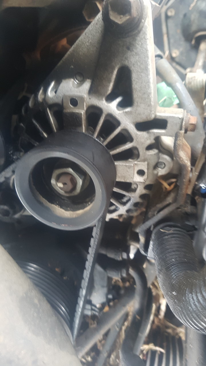

    My alternator is not charging my battery after some deep water.
    Is the alternator different from a manual to an auto trans?
    Will it matter if I have the tow package?

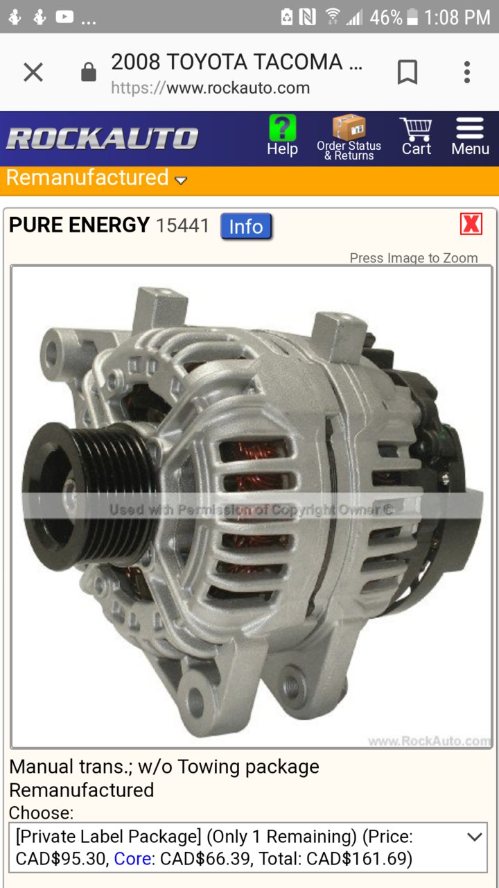

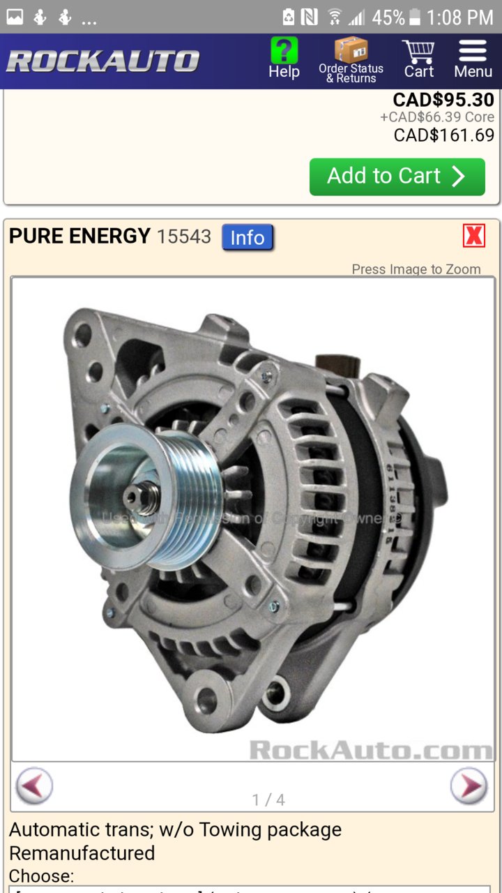

    I checked the fuse they were all good.
    Will the auto and manual for sure interchange?
    The parts stores are telling me they wont.
    The manual is a 90 amp alt and the auto w/o tow package is 100 amp and the one with tow package is 130 amp.
    The 90 amp has to be special ordered but they have the other 2 in stock.
    The truck is a 6 speed 4.0 without tow package

    I have they all list a different one for manual trans.

    But look8ng at pictures they almost look identical

    The top mount looks a little different

    I'm not to concerned with fitting a higher amp alt just if the auto trans alt will fit on a manual tacoma .

    Pull yours out and compare it to what they have.

    Does she look the same as y'all automatics?
    She's snowing out and I don't really want to pull this thing out at this moment

    Well I ordered the one specified for the manual 205 plus tax and it's coming from bc.
    I didn't want to chance it as this is my work vehicle and it can't be down. !
