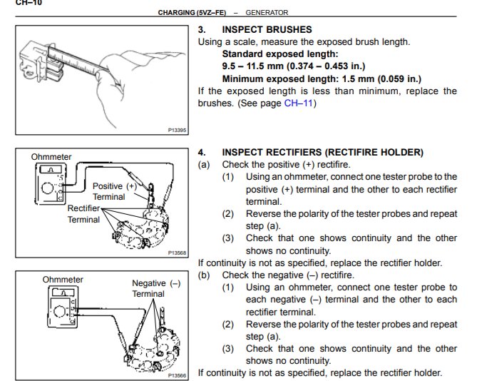

    #29
    Wsidr1
    Wsidr1 Well-Known Member
    Jul 11, 2018
    #259004
    3,078
    Indiana
    2 x 95.5 Ext 2.7L & 3.4L A/T 4x4
    @UKR_TACO
    Here are the two checks you should probably start with doing.
    UKR_TACO[OP], DrZ and cruiserguy like this.

  11. Jun 24, 2020 at 7:06 AM
    #31
    cruiserguy
    cruiserguy Well-Known Member
    Jul 31, 2016
    #193416
    19,000
    Elijah
    SEKS
    2000 ext cab, 2.7L, auto, 4x4
    Solid find on the rectifier testing... I'm so used to looking stuff up in actual FSM book form so I just reference my Cruisers FSMs for a rough idea on specs like that stuff.
