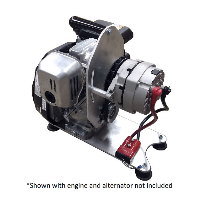

    Yeah no kidding, I must have been doing it wrong and destroying alternators my whole life from jumpstarting...
    I make a small engine alternator kit for this particular usage.
    www.affordabledcgenerators.com
    I have yet to pop one putting it on a dead vehicle, running it for a few minutes, then cranking it over. Not once.
