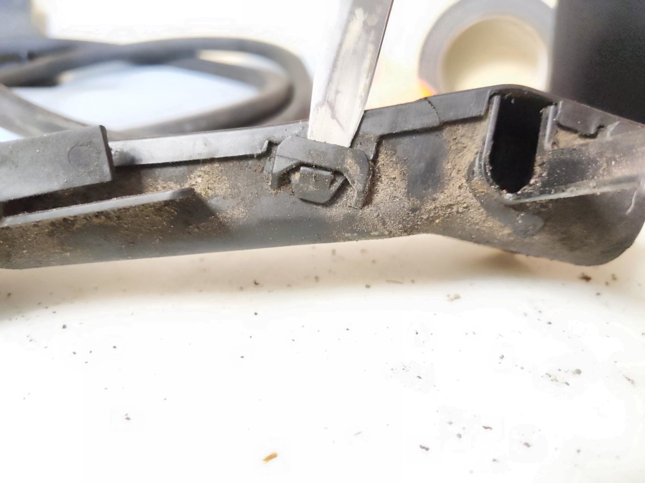

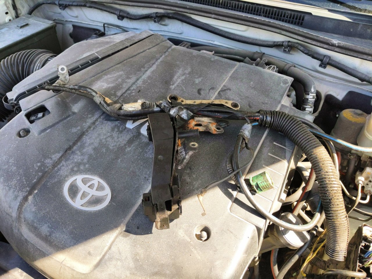

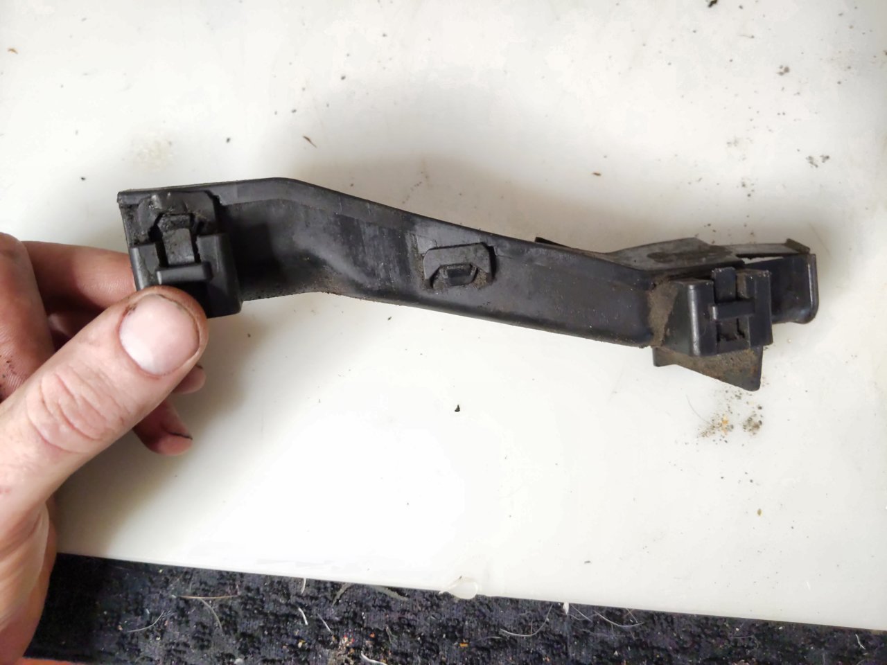

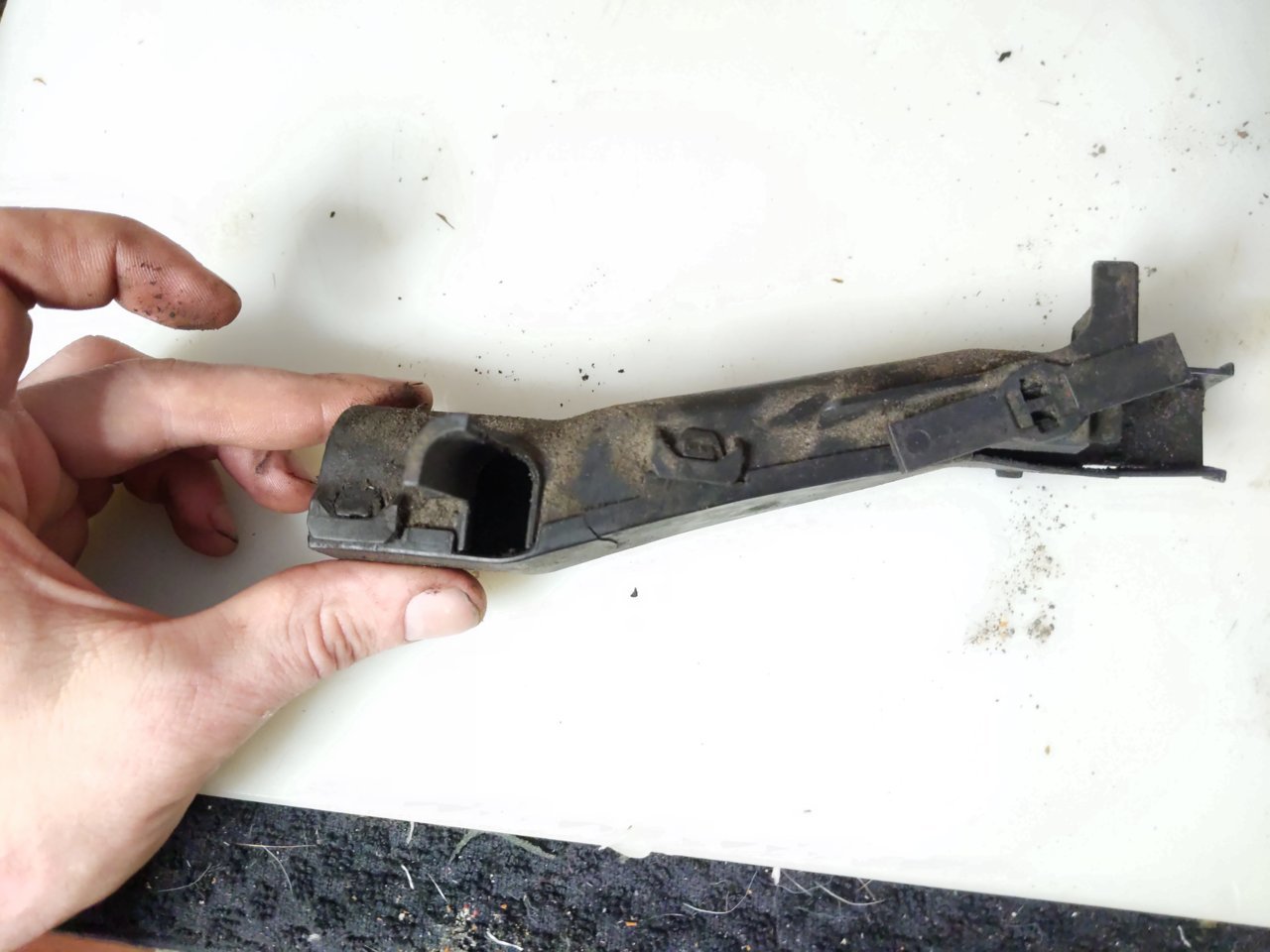

    Nope, I'm referring to this guy (as seen from the angle you'd see it along the driver's side of a 1GR-FE, down where you can't reach it at all):
    And it's held together by five surface clips:
    I ended up only being able to get it off by removing the entire wire harness, brackets and all, from the engine bay.
