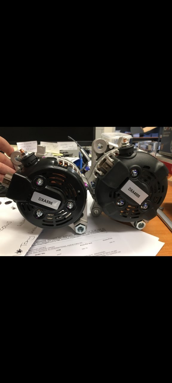

    After searching to uograde my alternator on the cheap with not much online help I thought I would share what I manage to do on my ute. Dxa400 130amp just need to cut off the 3rd mount

    I don't get what your going for? isn't 130 amp the same as the current one?

    90Amp is the standard, bigger than 130A its double the price.

    I swapped an alternator from the tow packaged tacomas to get a few extra amps.

    Why the need to upgrade, how much juice are you drawing on a continual basis?
