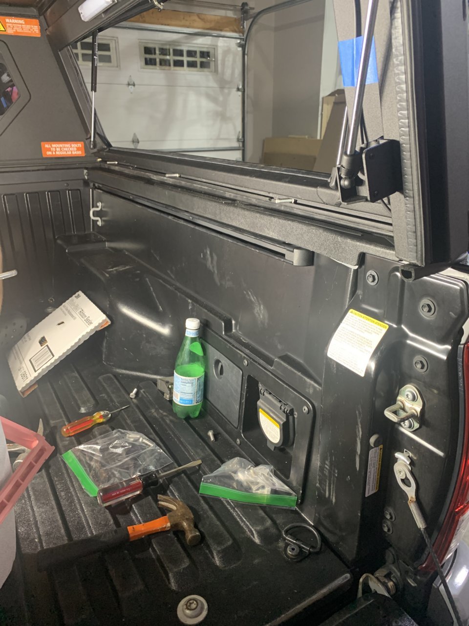

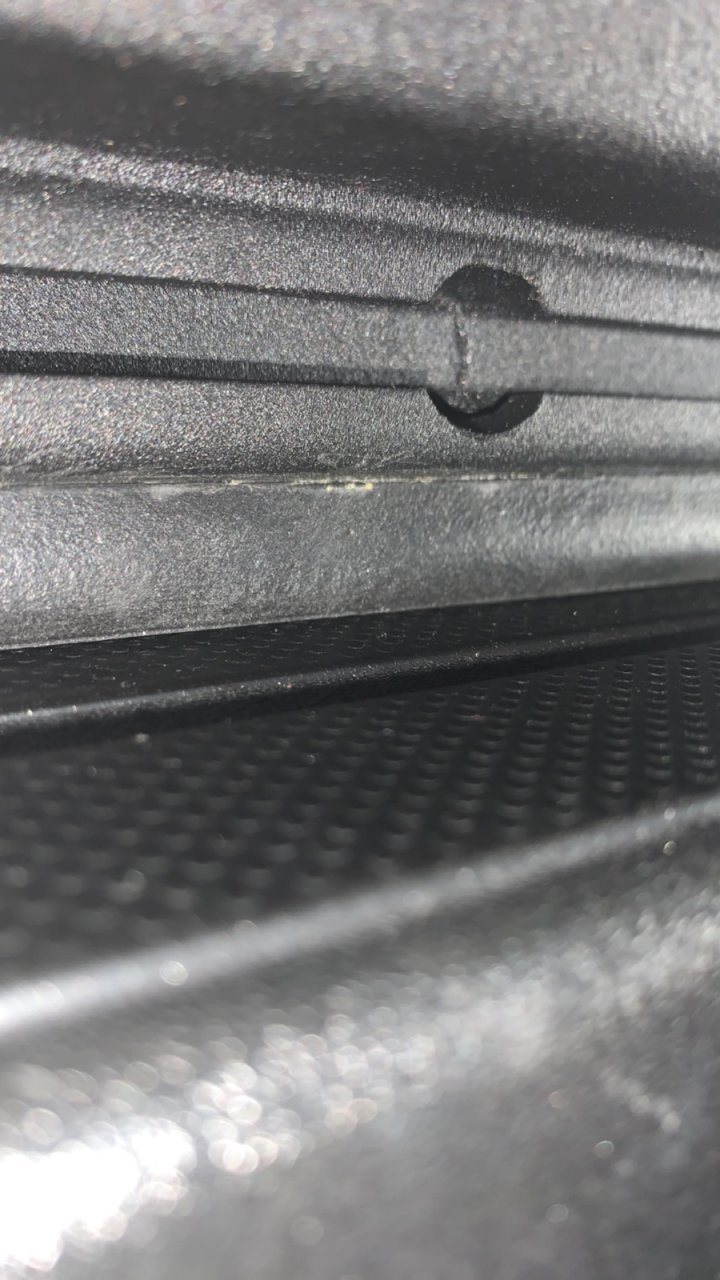

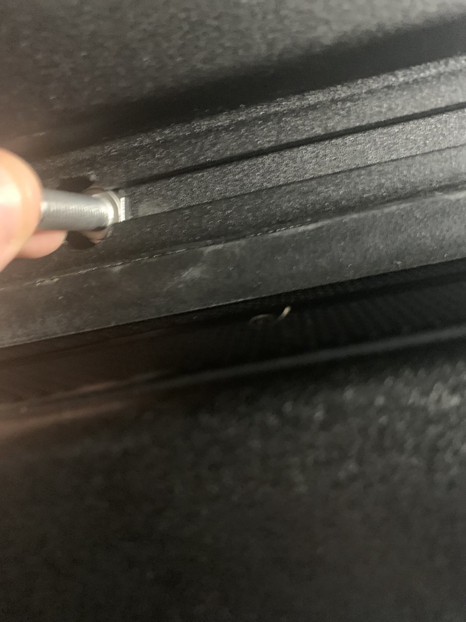

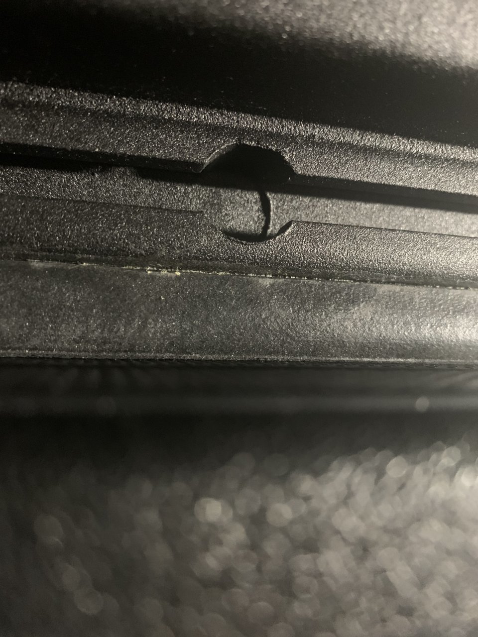

    Hi, I am posting on behalf of my brother, who bought and waited 4 months for an Alu-Cab Contour Canopy. The issue is the mounting bolts do not fit inside the rail to shift the bracket over to the middle. He reached out to support who said it is because there is paint build up inside the rail, but scraping it seems more likely that it is straight aluminum rather than paint.
    There also seems to be zero help online about the canopy either. So, would anyone recommend it try to be sanded down(it is very difficult to scrape inside the rail)? Or try to find a different size hex bolt head to slot inside? Or anything else because it is seeming like it is a faulty canopy.
    Getting a quality picture is difficult too, but I hope it shows that the inside of the rail is too shallow for the head of the bolt.

    Also, in your first photo, the bolt will only go in with the top and bottom of the bolt being parallel to the track. You have it in the photo at an angle.

    It's the powder coating that is causing the issue. The easiest way to deal with getting them into place is to get them started in the track, put a nylock on the bolt and then use a socket to wiggle and push it into place. It will slide into place with a little back and forth.
