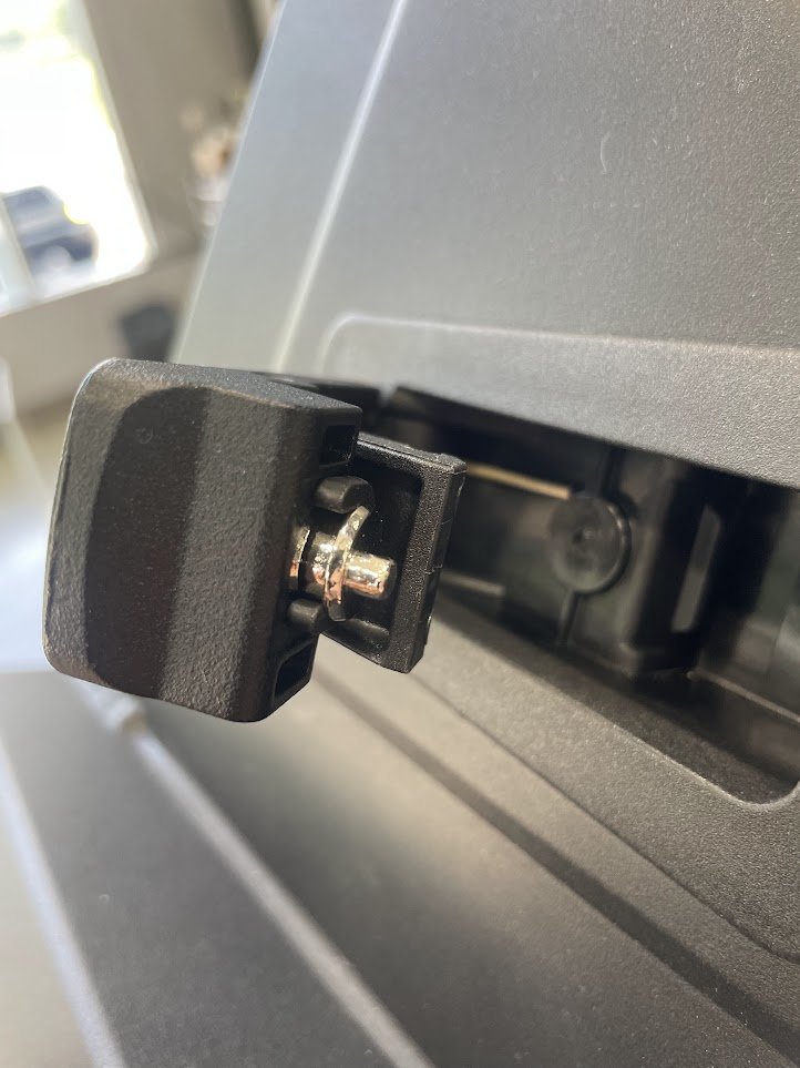

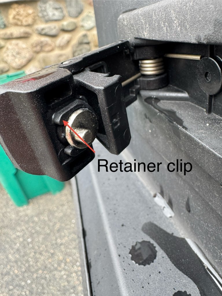

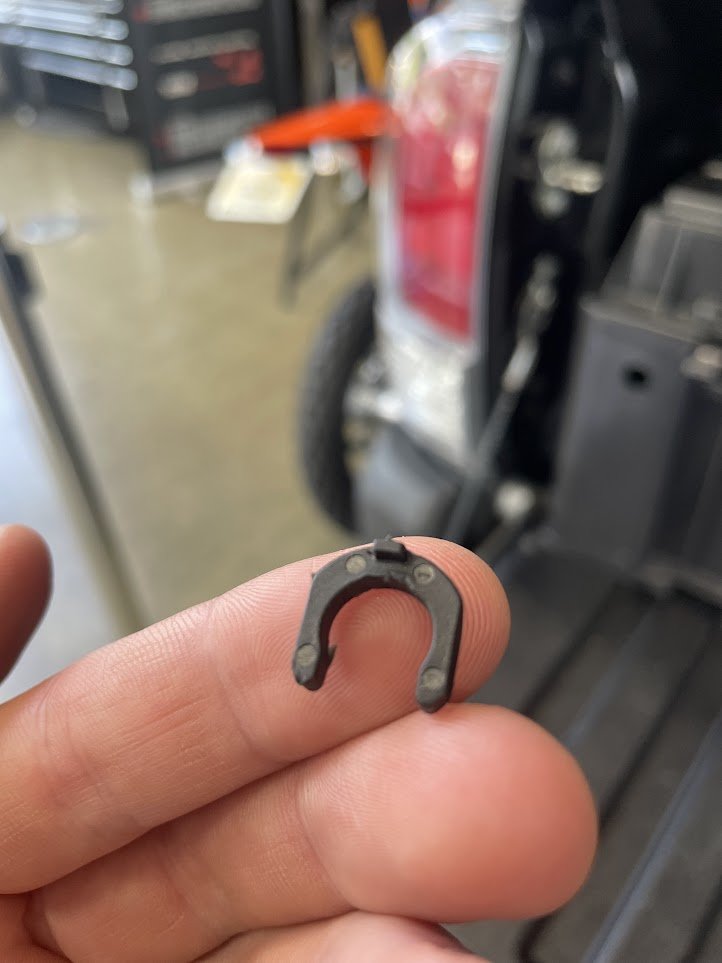

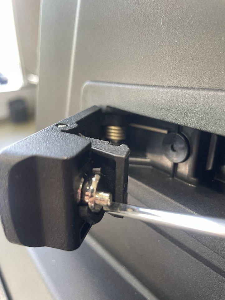

    To replace, open each lock. On the back side of the lock core there is a small plastic C-clip that can be removed using a narrow flat head screwdriver. Once the clip is removed, the core can be easily replaced and re-secured using the same clip.
    I've attached a few photos showing the process.
