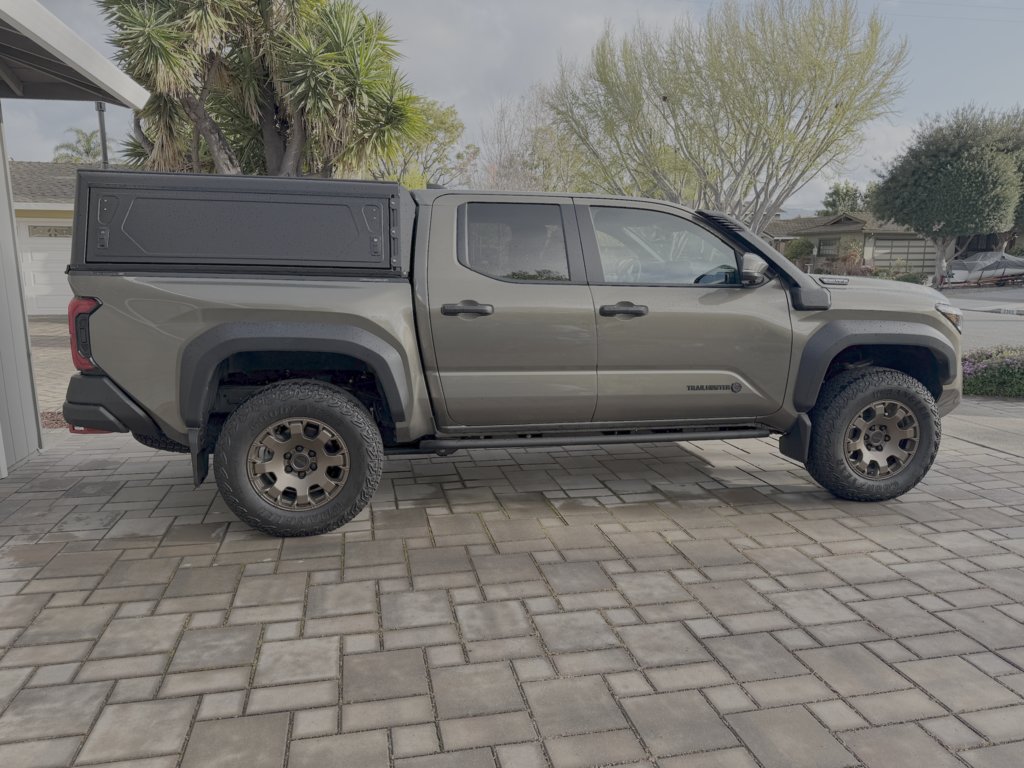

    Oh, I guess I should throw up at least one photo up now that it's all bolted down correctly now.
    I still need to do the wiring... the tail light and interior lights are fairly straight forward. I got the ggoffroad kit to relocate the cameras and I've already removed them and routed the wires to under the rear seat. But since I plan on doing electronic locks, I need to locate/splice the door lock wires. Then I can route everything into the bed at once.
    Only gripe I have is the door seals want to catch on the sides of the canopy and it makes it annoying to close the doors. Not sure if that is normal or I need to have a few friends pull on the rear corners and re-tighten things down?

    Looks great! Are you talking about the side openings? Mine open and close pretty easily. The back hatch/door has two rubber gaskets, one on the inside and the other on the outside, that makes closing it kinda wonky, but it's waterproof. Pretty satisfied with it so far.

    All 3 doors have gaskets and all three gaskets rub on the sides/frame of the canopy to some degree just before closing, but the rear door is by far the worst and requires me to push down on one corner and then the other. Basically there's enough flex in the doors that pushing on the corner lets the gasket get by without a lot of force.
    I know some people have reported the power tailgate doesn't want to close without trimming the gasket near the corners, but I've not had that issue. I setup the shims on the 6 brackets so I'm using the most shims and still get a seal (no light being seen between the canopy and bed). Instructions say they want the weight of the canopy on the brackets.
    Honestly, it's not the end of the world by any means. We got some intermittent hard rain right after I installed and no leaks. I guess the real test will be when I'm driving though.
    Oh if anyone else does their own install: one thing that was a little annoying is the foam gasket they have you install was clearly kept in a S.A. warehouse for a bit and the paper backing on the adhesive dried out and was difficult to remove without tearing the paper. Having a heat gun to warm things up (not too much of course!) helps a lot.

    Same with me on my new contour for the rear. One side of the rear door closes and seats perfect, other corner requires some manipulation. I'll monitor as the seal breaks in.
    Overall the fit and finish of the canpoy is very high (outside of all the silver bolts on the outside).

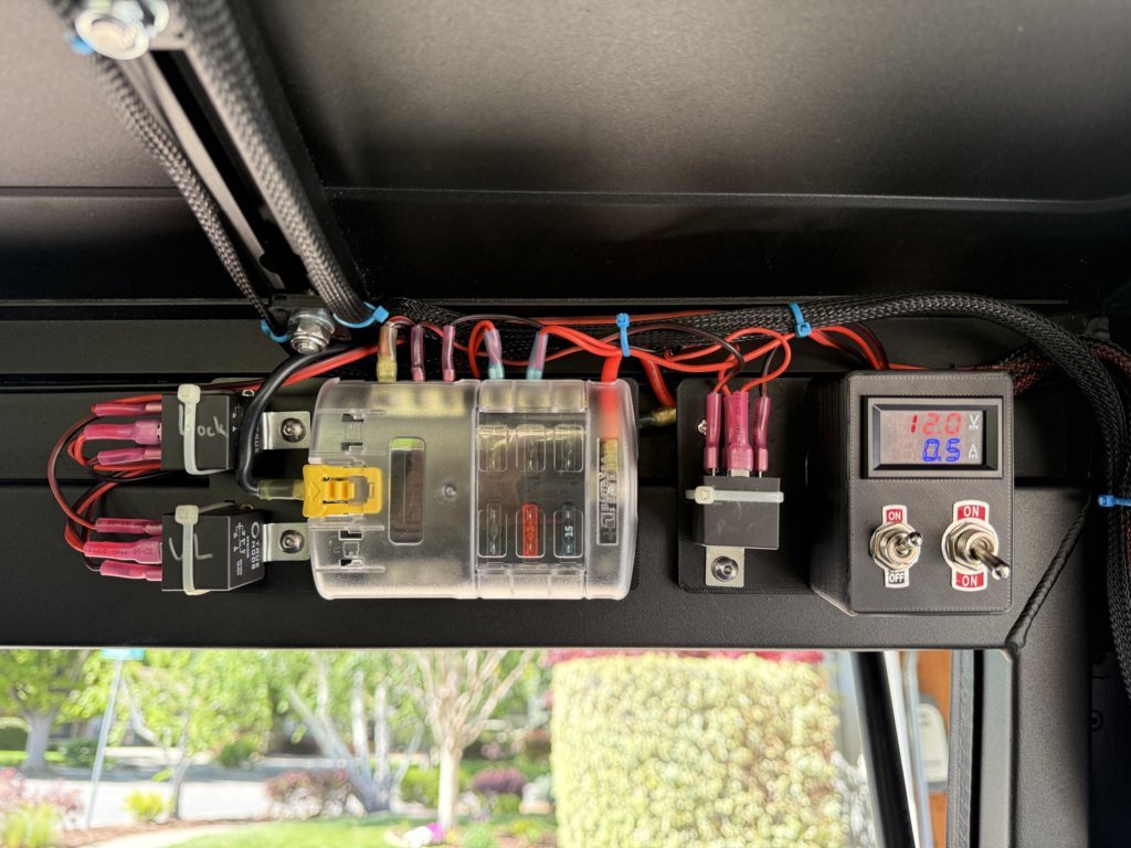

    Cameras are installed and wiring for power & door locks from the cab is done!
    Ended up 3D printing a longer arm for the rear view camera since the one supplied by GG Offroad was only about 6" long and some cable mounts for the T-slots on the canopy. The new camera arm is 10.5" inches and places the camera closer to the window so I can keep it higher without tilting down and getting an eye full of the cap.
    Currently designing some mounts for the relay box, some relays, a central switch for lights (on or tied into the door lights) and perhaps an amp/voltage meter to keep an eye on the battery. The LED lights that Alu-Cab provides eat 600mA when all 3 lights are on high.

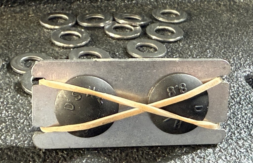

    @Vanhuette : I measure it to be 34-3/4" from the bed (I have the spray in bed liner) to the lowest point of the Countor which isn't the door, but rather the lower mating surface for the seal. Yours may be 1/4" higher or lower depending on the shim stack you end up with.
    As for the locks, from the research I've done (I've another thread here in the 4G forum) the wiring shouldn't be too bad assuming you have some wiring experience and know how to use a multi-meter. Honestly, the hardest part is taking apart the cab to get access to the wires in the B pillar and remembering I need to press the unlock button twice on the remote for the wire to go "hot". Once I have things working, I'll post more about what and how I did it so others can hopefully do the same. I will say I'm glad I did this wiring at the same time as the cameras, because it's a huge PITA trying to run things out the cab and into the bed.
    @Rocky.Mtn : I'm using the included SS M8-20mm bolts with came with the Countor mounting kit, because I replaced them with stronger grade 8.8 bolts like this: https://www.mcmaster.com/catalog/131/3594/91280A530 FWIW, 8-18 stainless is a few bucks more expensive and more corrosion resistant, but either will work fine IMHO for this application.
    FWIW, Unlike reports I've read in the past where there is a lot of extra powder coat material in the tslots, I've had no issues inserting and moving the M8 bolts into position in my cap.

    Guess I should of actually read the instructions... would of saved me a lot of time today. But got all the wiring done except between the relays and the canopy locks. Pretty happy with how it all turned out. The switches to control the lights and turn on the amp/volt meter are easy to reach and being up in the corner makes it easy to read even in strong sun light.
    The switch on the right lets me setup the Countor lights to be on, off, or controlled by the door lights.
    Switch on the left turns on the display for the volt/amp meter. Pulls about 10mA which is fine for while on trips, but since I'm still WFH I don't get a chance to drive the truck every day and no point adding another ~15% to the total parasitic draw.
    Next up I guess is do the locks. Still need to plan how I want to write them up and I really hate making wiring harnesses, but not much choice.

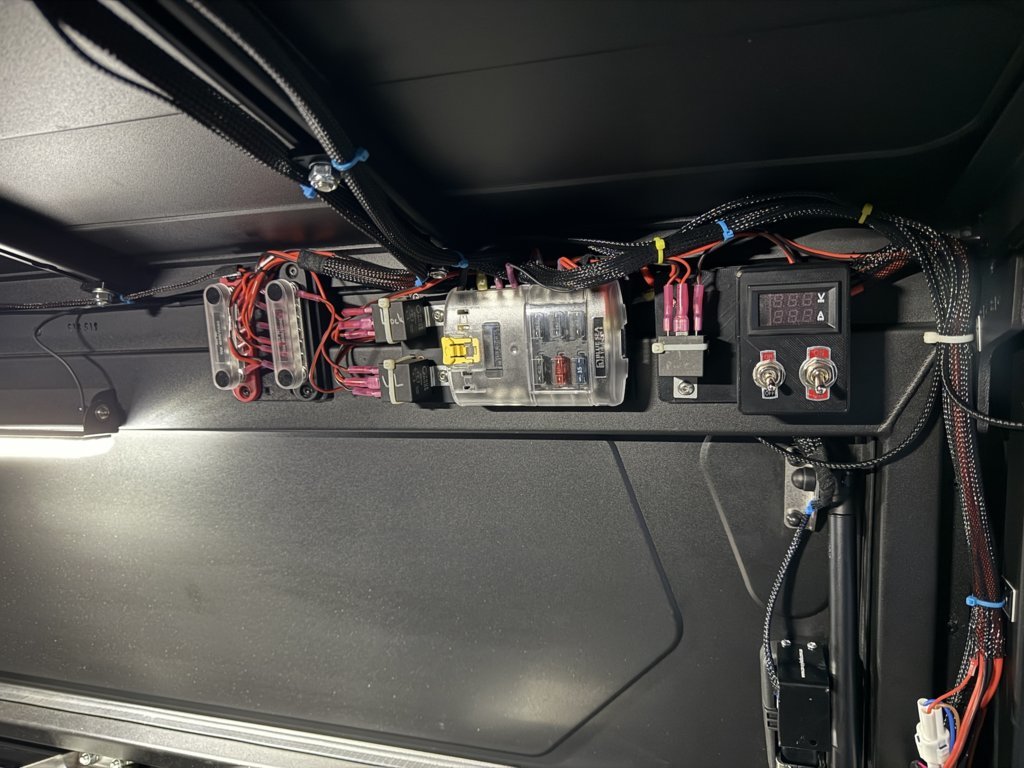

    Got the Canopy Locks physically mounted today. Instructions were fairly good and using a drill press is highly recommended to get all the holes drilled square which is fairly important. Definitely suggest reading each step completely before trying to do the step.
    One thing I would definitely change in the instructions is mount/install the protection bracket on the lock backer BEFORE YOU INSTALL THE LOCK in the door. Trying to screw the "self-tapping screws" with a screw driver against the door panel is a huge PITA- especially for the the screw nearest to the shock. Doing it off the door, means you can also drill a pilot hole for each self-tapping screw which makes it much easier. Not sure why the instructions tell you to install the protection bracket while installed... I had no issues sliding the little motors to lock/unlock in between the lock body and the bracket and then screwing them in later.
    They included some brackets to move two of the gas struts to clear the locks in the kit for the Countor, but I didn't need them- everything clears as is.
    Anyways, decided to use some bus bars to make it easier to wire the 6 locks to the relays, so taking some time to design & 3d print the appropriate mounts. Will have to finish the wiring another day.

    3D printed the bracket for the bus bars for the 6 latches and got everything wired up. I designed and printed the mounts for the T slots as well. Wish I could come up with a better solution than 3M wire management stickers for a few other places, but one downside of aluminum is that you can't use magnets like with the RSI.
