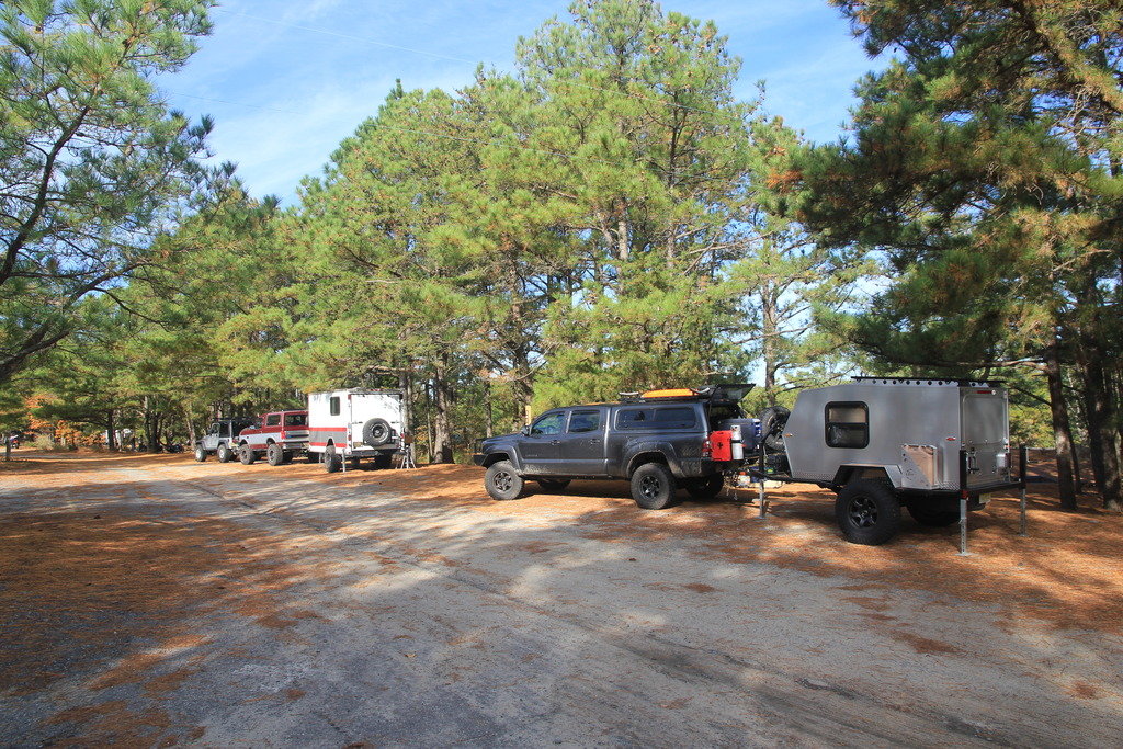

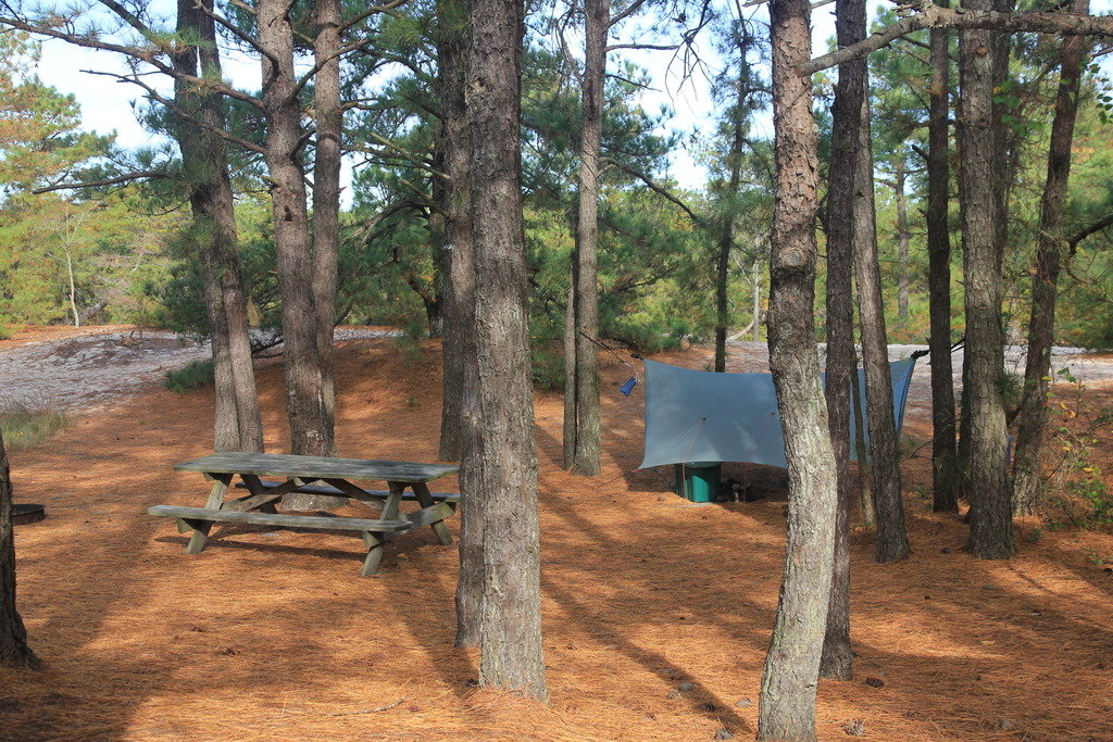

    Ended up getting down to Cape Henlopen this past weekend for a camp trip with the guys. Weather was beautiful Friday and Sunday but Saturday was a little wet - fortunately we were able to setup a shanty town of ez-ups and tarps and broke out the booze to pass the time.
    I was dying to take the rig and camper out on the sands and inevitably test out the Maxtrax but no dice as it was still crowded when I rolled in Friday. Snapped a glamour shot at least - the sundown ended up being pretty sweet before I headed to camp to setup.
    The rigs.
    Hammock camping for my buddy and his lady.
    Happy dog action shot!

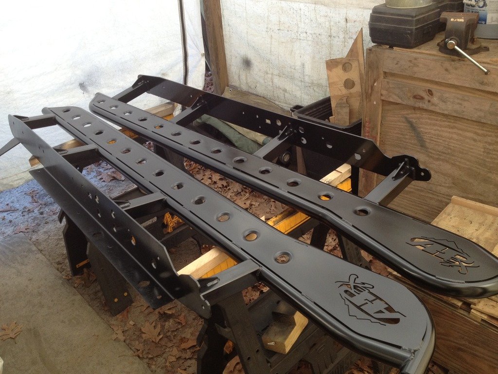

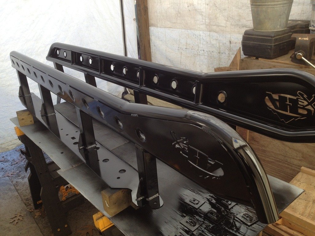

    Super pumped to have my @allpro APEX sliders. They are looking super slick in gloss black and should be going on tomorrow!
    :cheers:

    Love this thread. Not sure what type of gloss black you painted them with but I shot mine with an Mil-Spec epoxy primer and top coat and it didn't hold up worth a shit. I ended up shooting them over with Plasti-Dip and that's held up the best. You might want to shoot the underside with Plasti-Dip and keep the gloss black on the outer edge and topside. Just a suggestion.

    Thanks bud, I used VHT chassis paint (SP650?) like I used on the rear bumper. The bumper is holding up well so bar even with climbing on it with cruddy boots to strap down the kayak. Plastidip on the underside does sound like a good idea as they take some beating from stones and such on the street.
    I'm thinking in the spring they'll get that and I might use some of the Monsta-liner stuff on the tops of the fill plates for extra grip and protection for that step area. Tubes will stay rattlecan as they'll need constant touchup from use.

    That sounds like a plan. The cross bars towards the rear really take a beating from the "road schmutz". I figured using the epoxy paint which really takes a beating would be enough but it was down to the primer in no time at all. The plasti dip has really held up well. If that didn't work I was going to try rattle can undercoat or bedliner next. Good luck!
