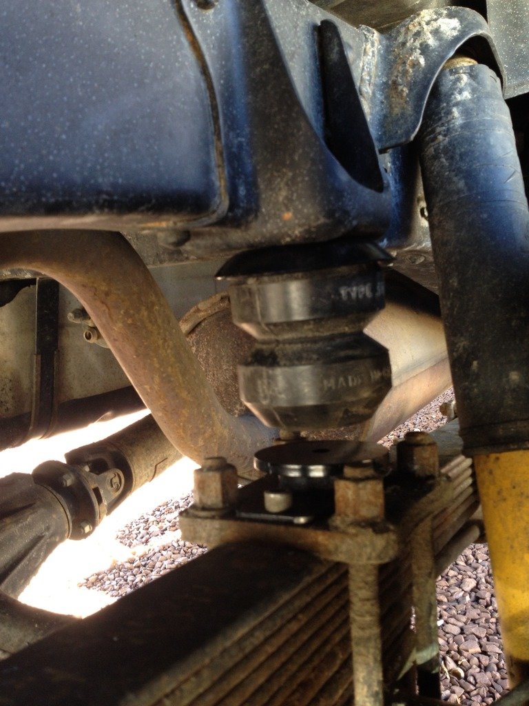

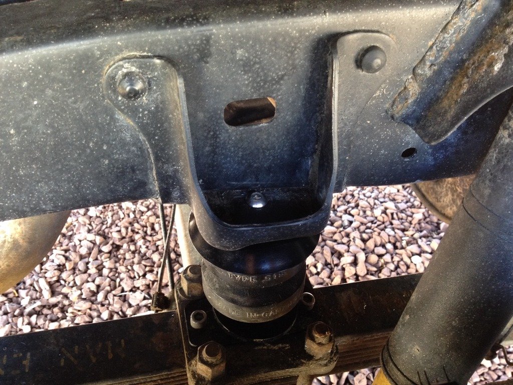

    Installed the Wheelers Superbumps on the front last weekend. Hugely satisfied with them and wish I had done it sooner! They soak up some of the harshness I felt the 886's always had. I swear it even feels better in sweeping corners like onramps and offramps and controlling roll without the swaybar.
    I'm still debating the next step in the rear but am leaning towards the Timbren Active Offroad setup. May be pulling the trigger on that soon.
    Otherwise not much to update other than some tinkering projects including reinstalling the on board water setup and working some mounts for additional rear lighting off the rack.

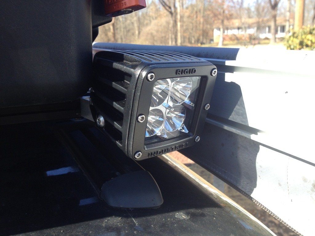

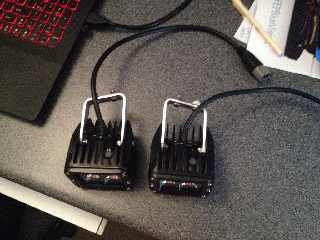

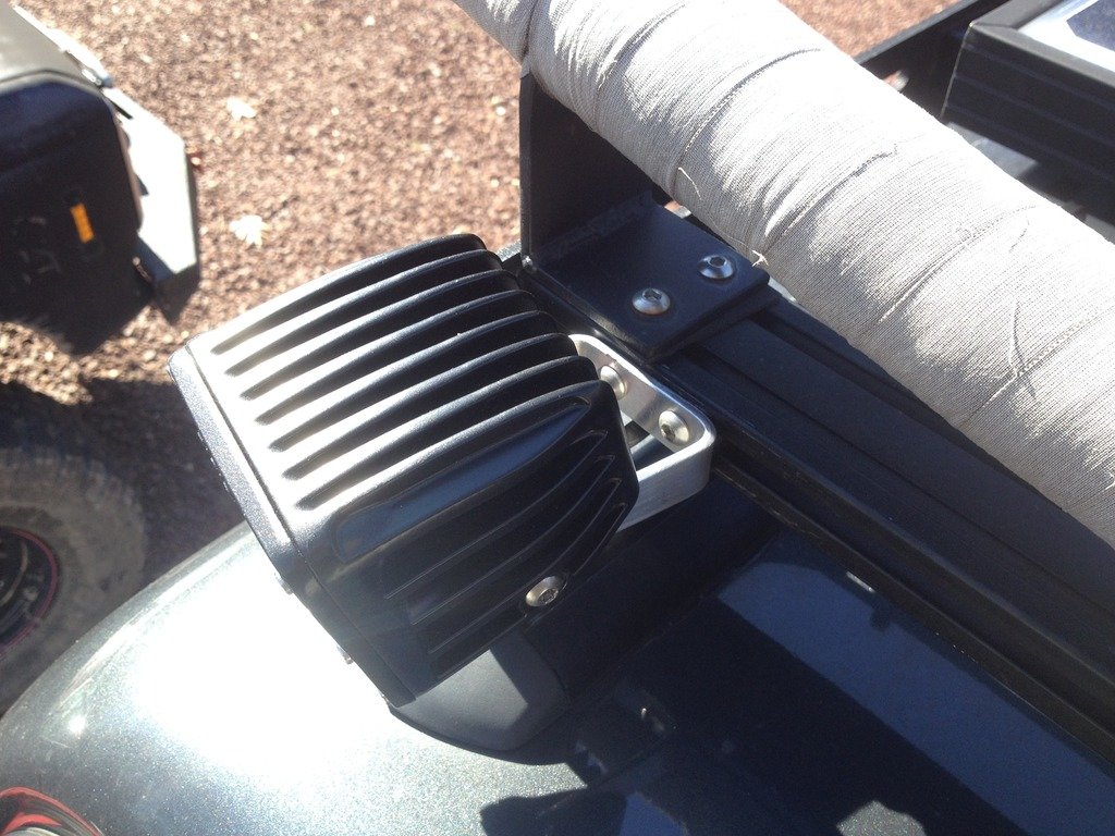

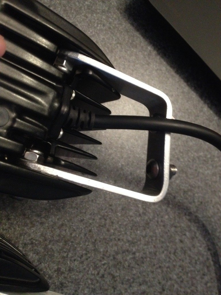

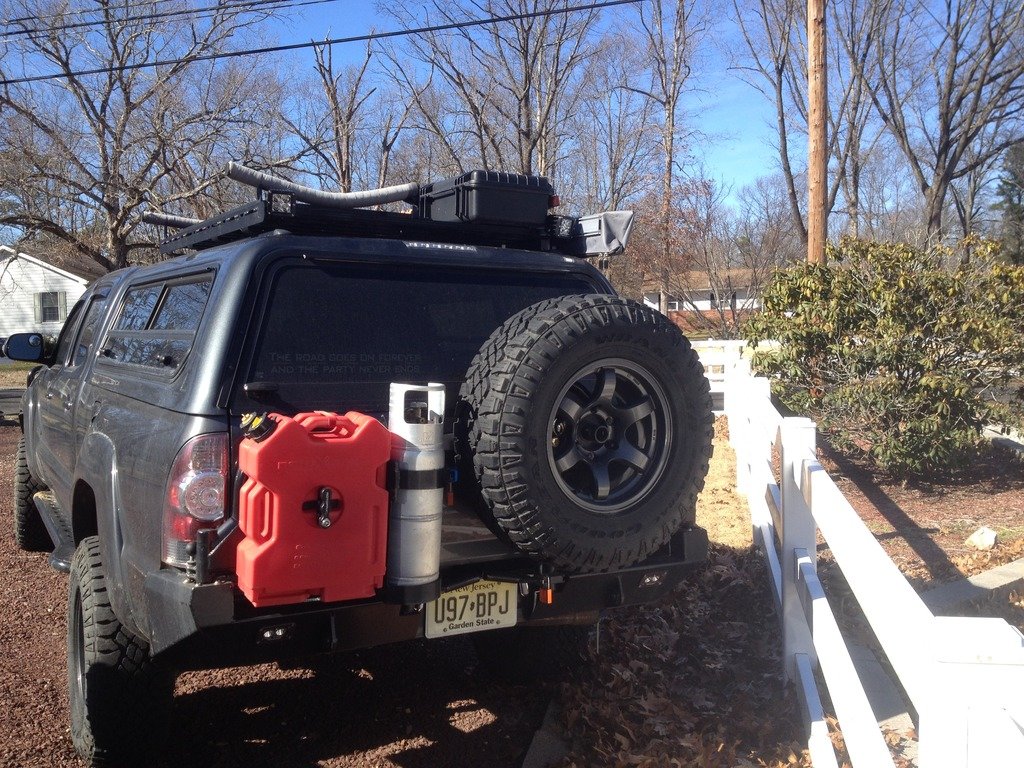

    I've been kicking around options for additional rearward lighting and was bouncing between a mast setup off the tire swingout or going right off the roof rack. I ended up going with the roof rack only so I can still strap my topper door down to the tire when hauling long items in the bed like lumber or steel materials.
    I already had some Rigid dually lights lying around from a previous project so I'd figure I'd go ahead and use them. As their brackets weren't going to allow me to throw light to the sides of the truck I went ahead and fabbed up a DIY solution with some strips of 1/8" aluminum I sliced out of a larger sheet. A few bends in the vise turned out just perfect!
    I still need to wrap up the wiring down to the bumper through the topper but I'll wait for a warmer day to get that done.

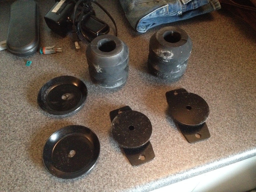

    Caught a good deal on the Timbrens with flip kit (I'll be selling the u-bolts and plates shortly as I already have the all-pro setup) and hope to get these on soon!
    I'll be switching up the mounting I think but I'll have to see if it'll work - I plan to drill the bracket on the frame and mount the bump to that facing downward and mount the Timbren bracket on my all-pro plate. Hopefully this will eliminate the bumpstop from packing up with mud like I've ready happens when you mount per the instructions with the bumpstop facing up. We'll see...

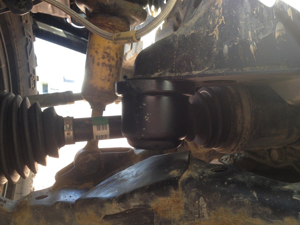

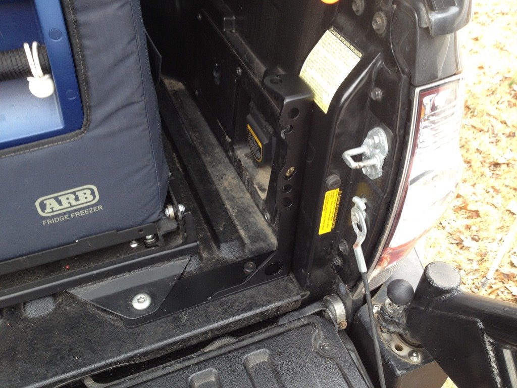

    Well - Made some more progress on the winter build list for this year's travels. I was able to flip the Timbrens the way I had hoped so that they don't pack full of sand and other junk, I expect that this will improve their performance long term. I still haven't hitched up the trailer since putting them on so I'm eager to see how it rides with the trailer loaded up with the Honda on it.

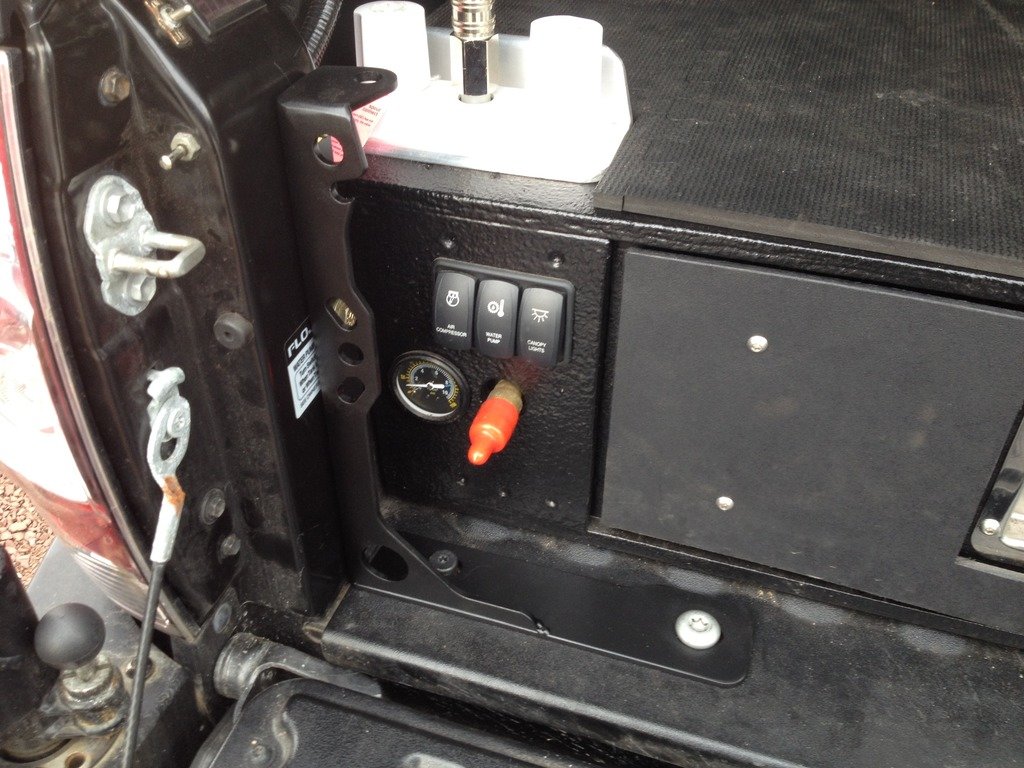

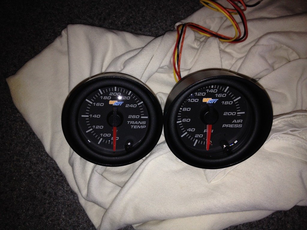

    I also ordered a Lotek a-pillar gauge pod which should be arriving tomorrow to install a gauge to monitor the on board air pressure as part of the future locker install and a transmission temperature gauge to keep an eye on things while towing. The Scangauge is able to see trans temp but I want something that's a little more in line of sight and intuitive to read at a glance. These should do the trick.
    Last but not least, my bedside braces from @At The Helm arrived on Friday and the weather was nice enough to get some paint on them and installed yesterday. Very pleased with the fabrication quality as a hobbyist welder/fabricator! The only deviation I made was pounding off the facory bed bolt washers so I'd have as much thread engagement as possible which I was worried about on the passenger side with the fridge mount I'd previously made. Should work just fine!

    Did the same washer delete on the passenger side. Having your fridge slide brackets I get we had the same intensions and solution. :cheers:

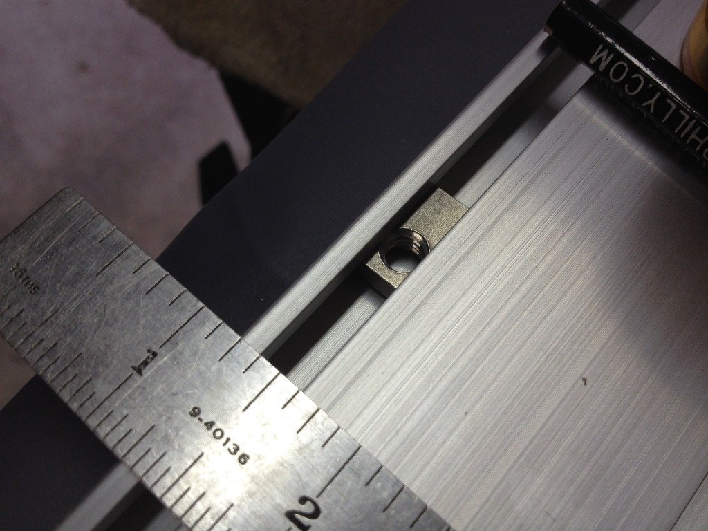

    Can you tell me where to get these t-slot nuts for the Prinsu rail? Thanks again!
    After some thinking I decided rather than using the M6 bolts from ARB I'd use some countersunk 1/4"-20 SS socket caps for security and thread them into the same t-slot nuts I use in my PrInSu rails which are a perfect fit!
    :cheers:[/QUOTE]

    Sure - I had bought them through Amazon (here) before but had picked up more some months ago through ebay (here) at a slightly better price.
    :cheers:

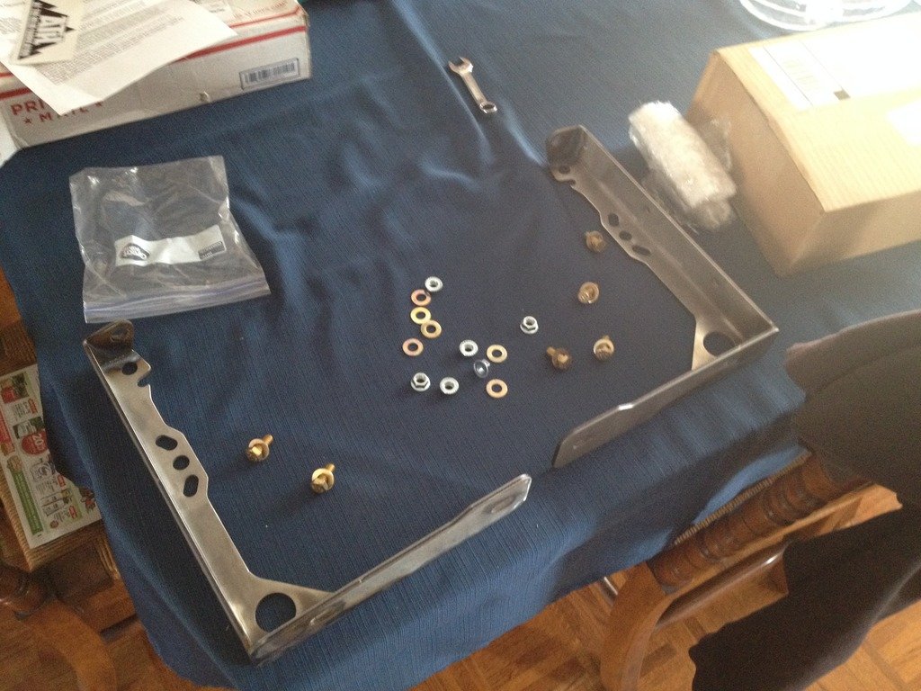

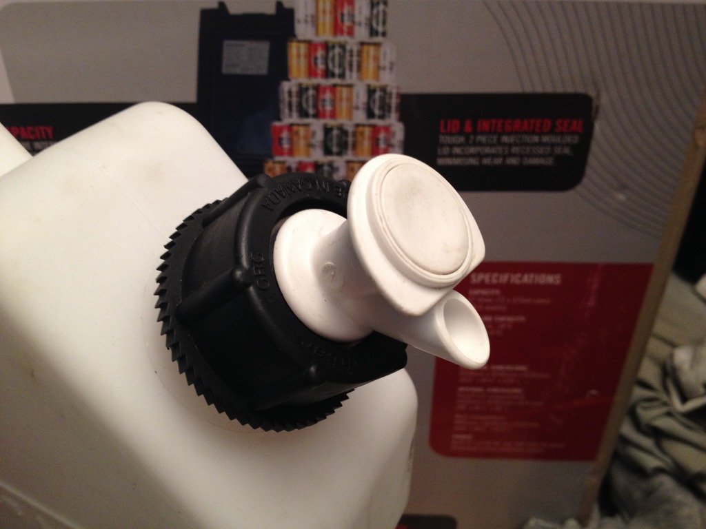

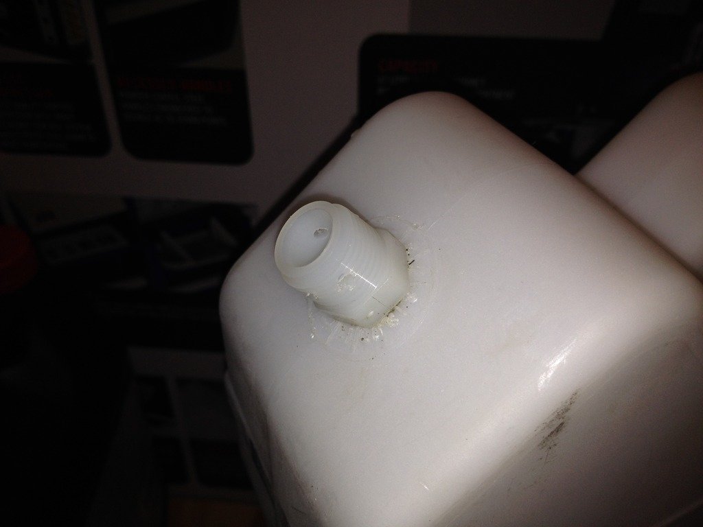

    A few months back I decided I wanted a quicker and easier way to use my 2-gallon water rotopax for drinks, washup, etc and started poking around the web for possible parts to solve the problem. I knew I wanted some type of push-button style spigot but wasn't sure how I could incorporate it into the rotopax - after some searching I found this replacement spigot for one of those barrel style igloo coolers - perfect!
    After some measuring I decided to order one of these 3/4" ID x 1-1/2" OD stainless washers. This is the perfect outside diameter to fit the rotopax gasket on off the original spout and after some dremeling and filing, the igloo spigot fits and seals right in.

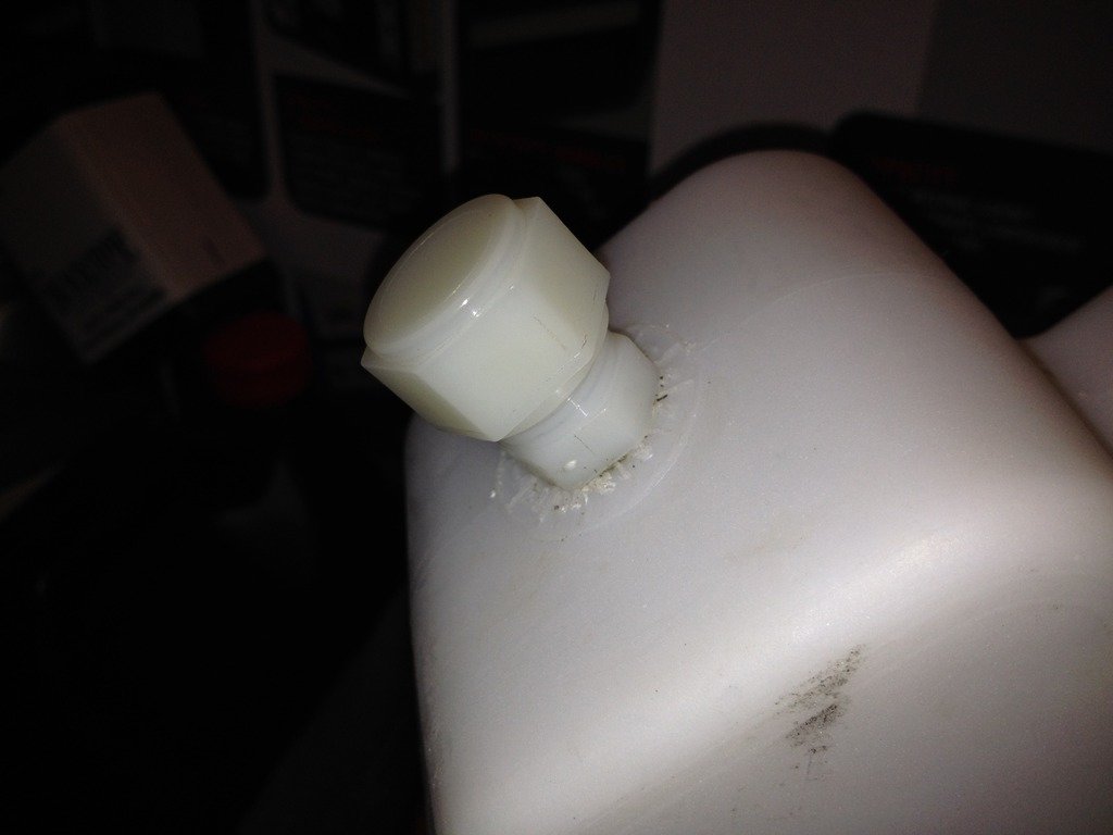

    It's compact and works great EXCEPT the container forms a vacuum inside that really slows down the output as air gulps back in - super disappointing! I'm not sure why but at some point rotopax did away with the vent that used to come on these suckers so I did some more thinking (read - drank some beers) and decided to bite the bullet and drill a vent of some type into the rotopax.
    Obviously being leery of screwing up a perfectly good container I did some more searching and narrowed down the solution to either installing a rubber valve stem without a core or using some type of plumbing fittings to put in a vent like my jerry cans have. I passed on the valve stem as this will be potable water and I wasn't keen on having the rubber and brass around seeing as they weren't meant for that type of use. I tracked down this male to male nylon NPT and this NPT cap and decided they'd fit the bill.
    After drilling a 9/16" hole in top side of the rotopax opposite the spigot I tapped the hole using a brass 3/8" NPT fitting I had lying around (better bet is an actual NPT tap but I couldn't find mine :notsure:). So that you don't need to fully remove the NPT cap from the NPT nipple, drill some holes in the threaded portion. It's important that these are placed far enough up that the cap will cover and "seal" these vent holes when the cap is tightened down but far enough down that they can breathe air in without fully removing the cap (read - lose it in the campsite somewhere). This step took me two nipples :rimshot:
    Don't over tighten the nipple into the threaded hole for obvious reasons. Mine seems to be tight enough that it doesn't leak even when held upside down and hand tightening and loosening the cap doesn't move the nipple.
    Boom - no more gulping when you use the spigot and crack open this bleeder.
