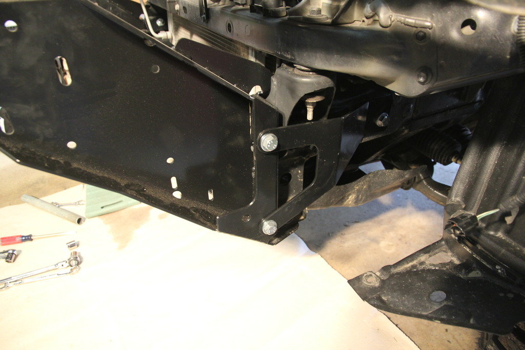

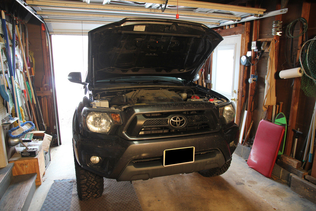

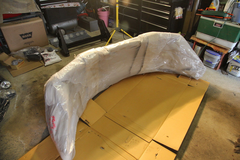

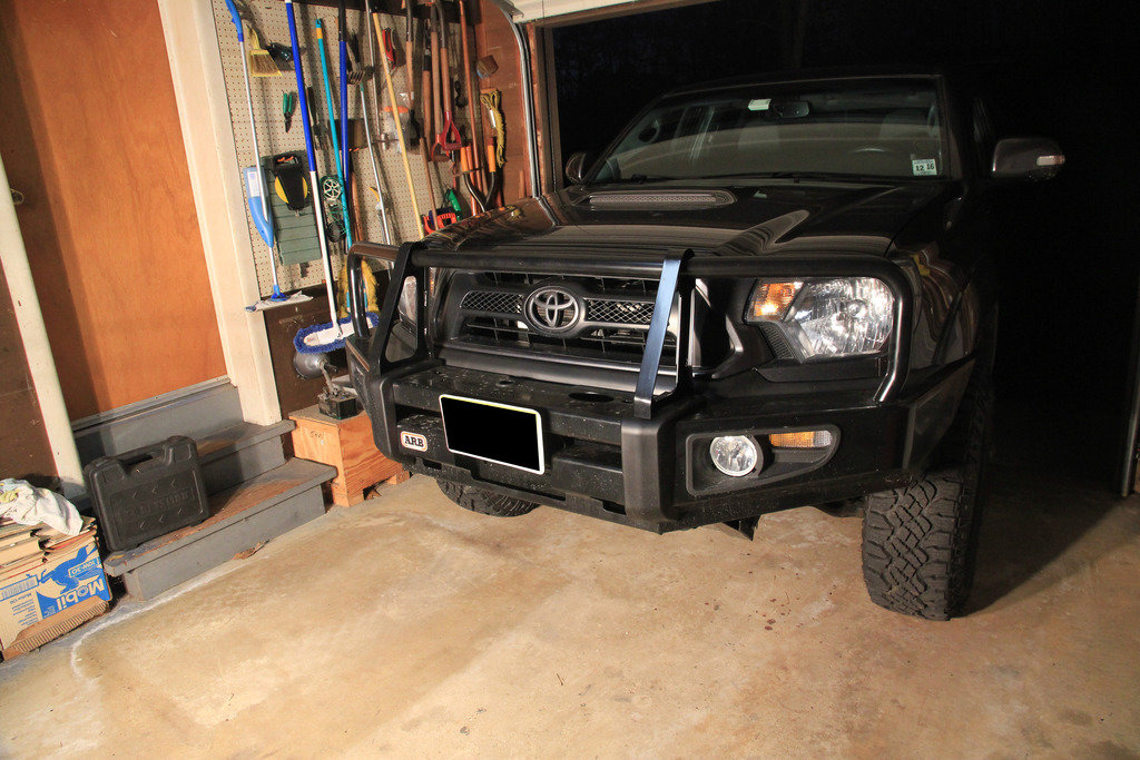

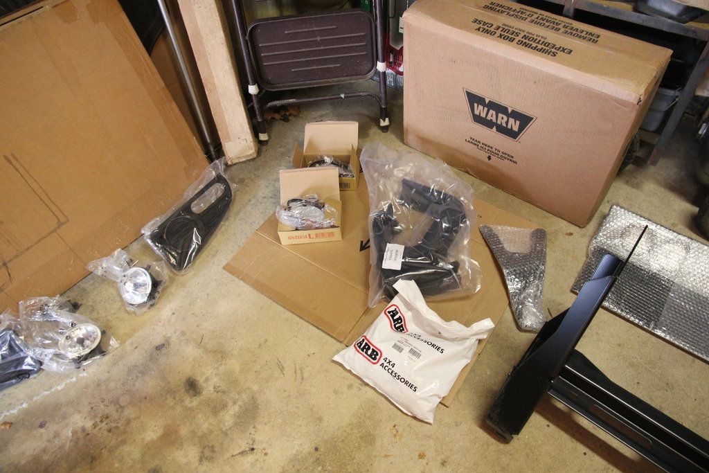

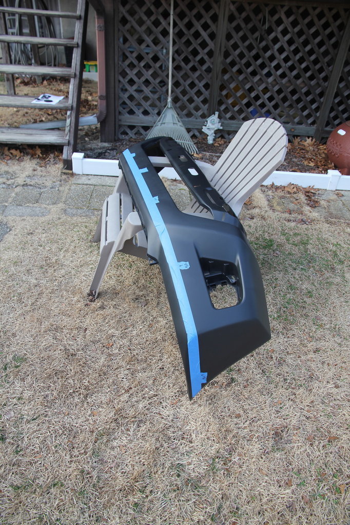

    Well enough with the teaser! After lots of research and reviewing other builds on here I decided to go with the ARB 3423140.
    Before getting into the install I want to thank Chas and Mike from TotalAutoParts for working with me and getting me a great deal on this next stage of my build. I'd purchased from them before for my EBC Brake Kit, brake lines and Rigid LED's (build updates coming on all these) and they were a complete breeze to deal with. I did a lot of shopping around between local and the big-box-outfitters and all in TotalAutoParts offered up the best bang for the buck and I knew my dollars were going to a good place. Through the whole process these guys work with you to get you what you need and how you need it and even made the shipping process easy; the delivery guy R&L even helped me carry all my goodies into my garage before getting on his way! All that said, I'd highly recommend that if you're in the market for auto parts (even things not listed on their website) get in contact with these guys in the Vendor section and see for yourself what they can do for you!

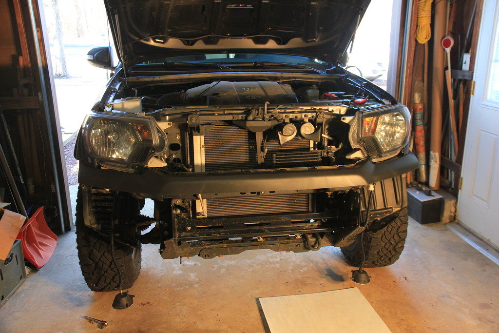

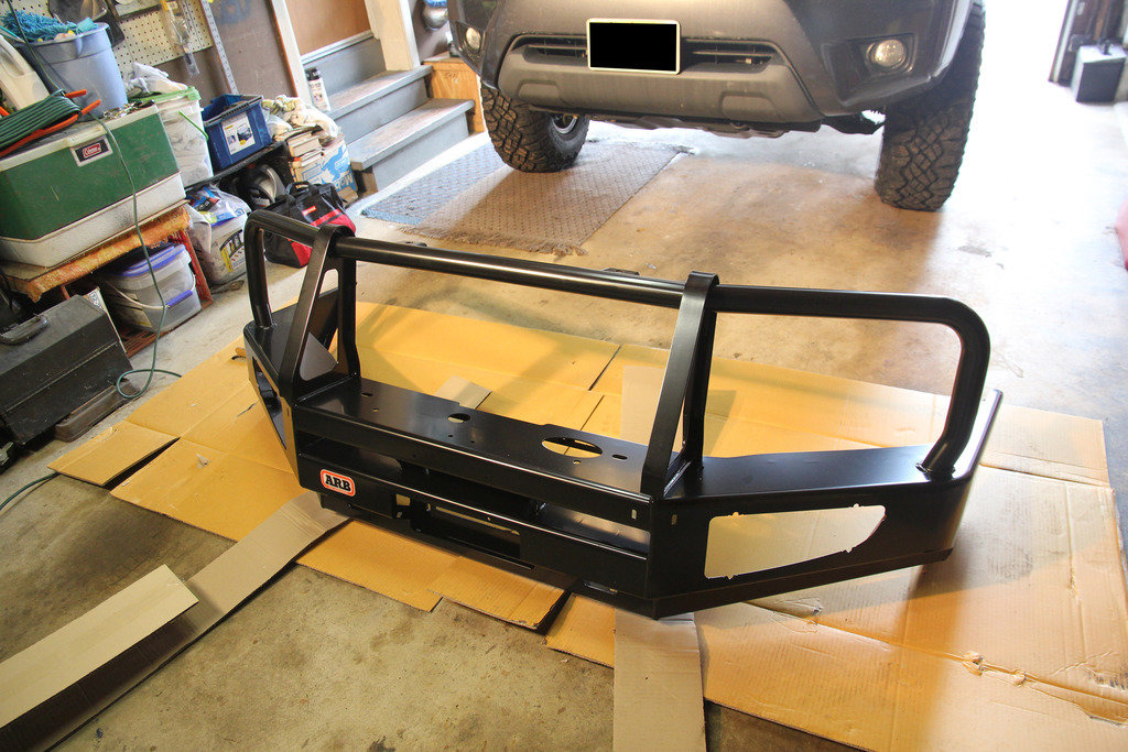

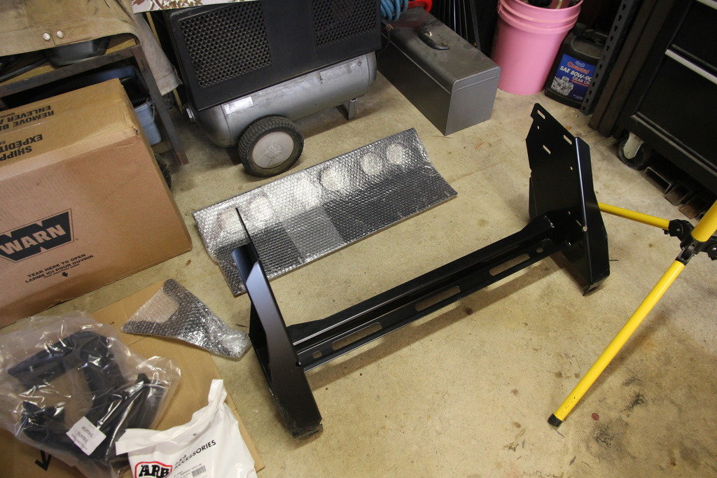

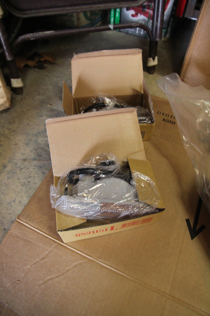

    Now for the install! I had no idea how these things were going to be packaged but they were well packed and survived the trip with no noticeable damage. The ARB came in a total of 3 units, 1 box for the frame brackets, skid plate, nuts/bolts, frame ties, rubber bumpers, etc, 1 box for the fog light inserts, foglights and marker lights, and then the fully wrapped bullbar.

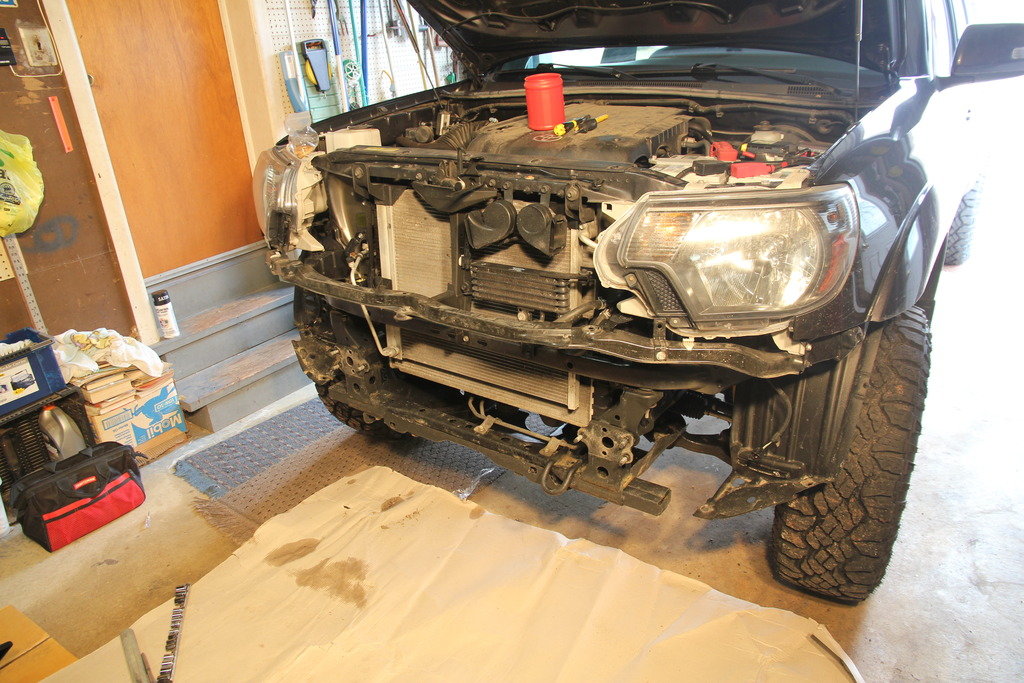

    I was so impatient on the day it arrived I immediately started unwrapping things to get it at least mocked up on the truck.

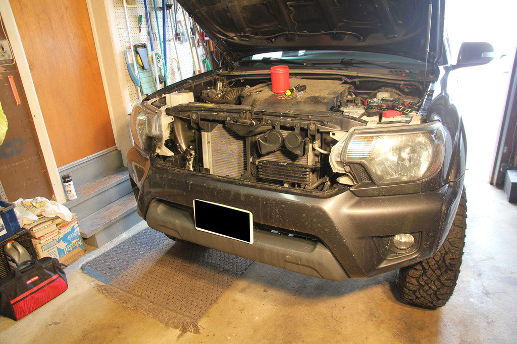

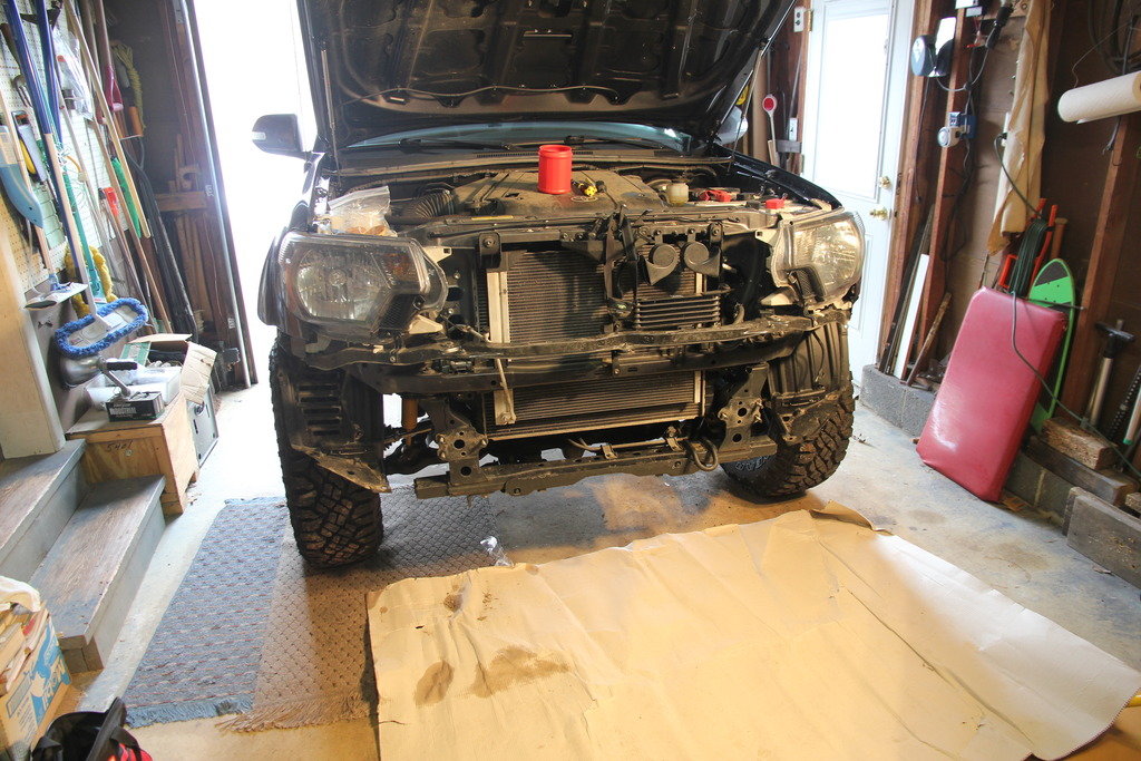

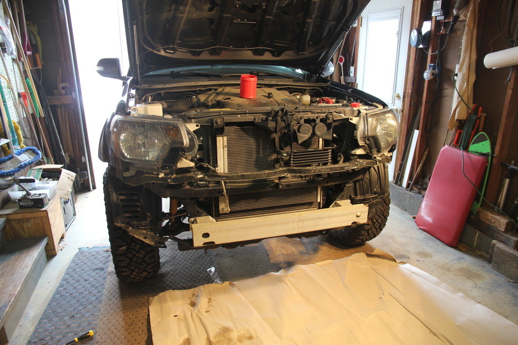

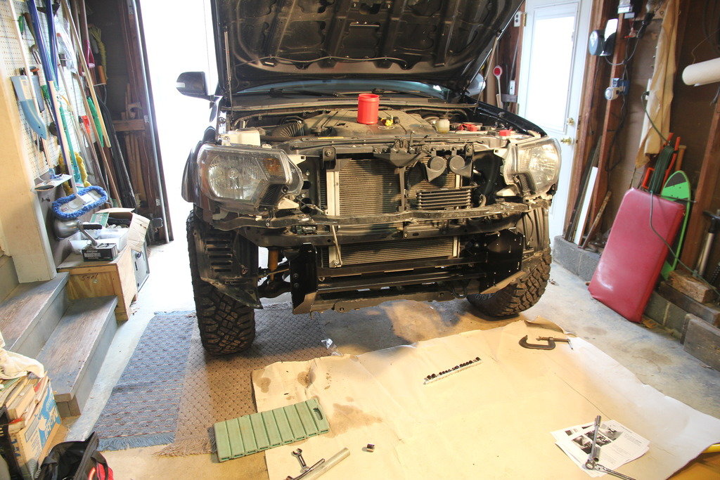

    I started teardown right around lunchtime and made good time getting everything pulled apart. Fortunately I had a pretty good idea how everything needed to go from doing the MGM BHLM a while back.

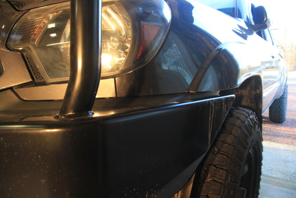

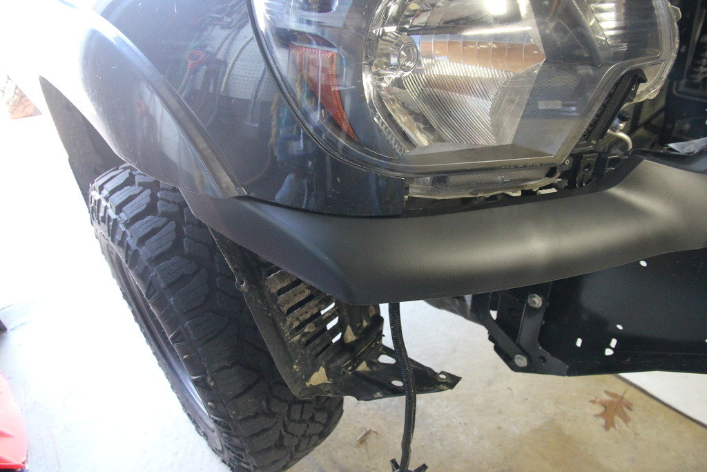

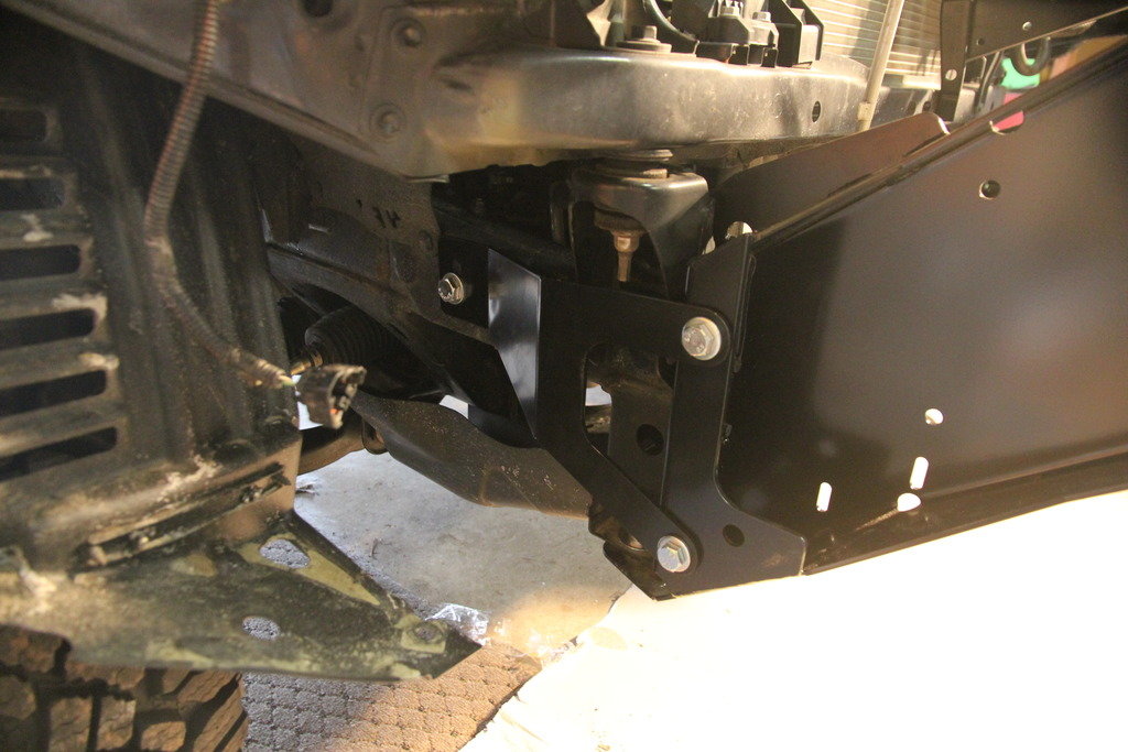

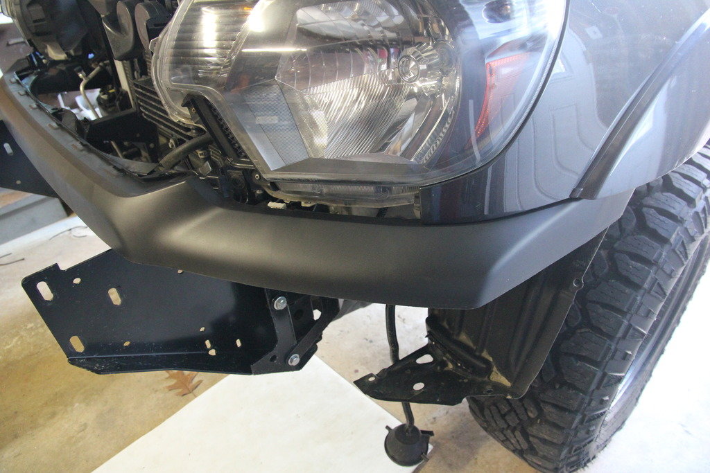

    The first real snags came when I started putting on the ARB parts. First, the ARB instructions are not the best and include tiny black and white photos. Second, ARB puts all the fasteners in a single bag with everything unlabeled and mixed. Third, everything is metric which isn't really their fault but it's a pain to check thread sizes and pitch as I don't keep much metric stock on-hand. That said about 15 minutes of counting and sorting had the hardware figured out. The biggest fight after that was getting everything lined up, particularly the holes on the bottom ends of the factory crashbar and the ARB mount.
    The frame ties are a nice touch and went on easy and use a factory hole in the frame. Top tip, the plugs rotate out and don't need to be pried out!

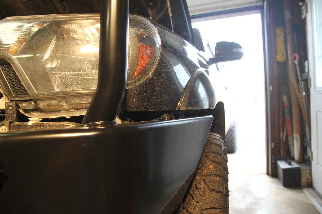

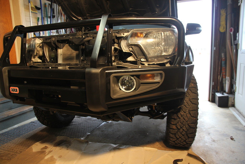

    I hadn't cut my stock bumper at this point and had decided to order an aftermarket crash repair part to hack up and fill the gap. I ordered TO1000384 (Toyota 52119-04060 equivalent) from eBay for $84.14 to my door so it was a no brainer. The added bonus with this P/N is it's for the base model so it did not have the holes punched for the fender flare extensions – these holes are otherwise visible after the install if you run a sizable gap between the bullbar and fenders. The downside was the bumper cover hadn't arrived yet to get cut and put on so I pushed on without it. With the bar set loosely in place you can see the issue running without a bumper cover!

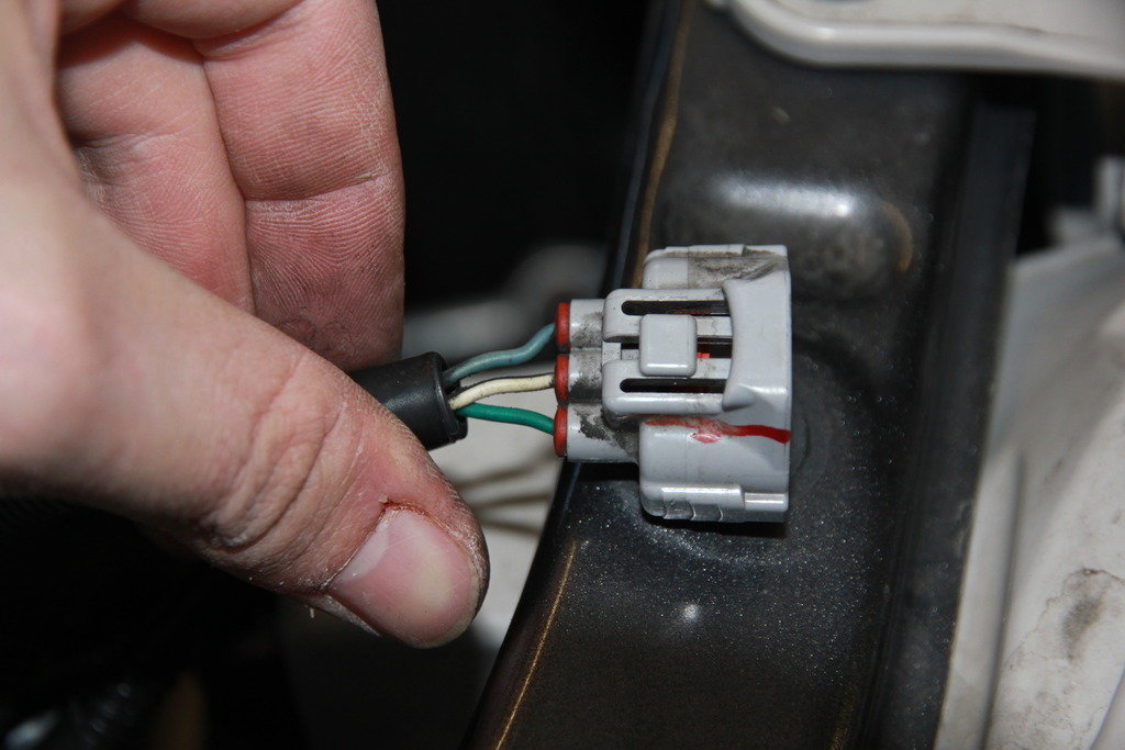

    I wired up the foglights to my factory wiring for the time being but will eventually re-wire to use my OTRATTW switch. I wrapped up the re-assembly process in the late evening and ran it that way for about a week until the factory replacement bumper cover arrived. I made short work of hacking it up!

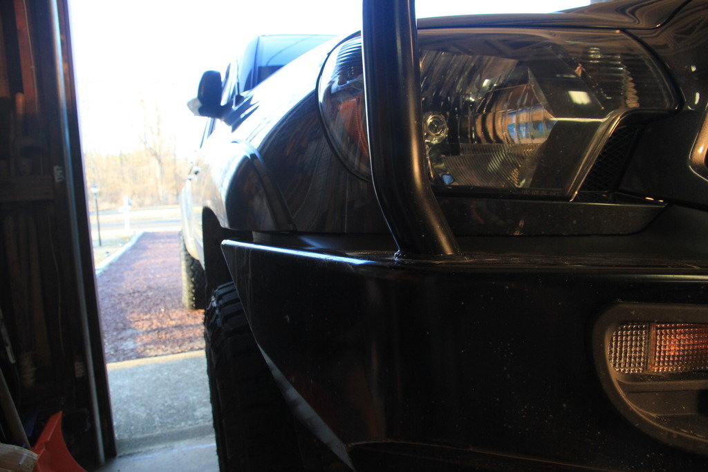

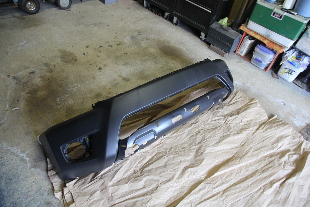

    I loosely followed ARB guidelines with the trimming and gave myself another 3/4” to 1” past their number to where I cut. I'm glad I did as I think the ARB numbers might have been a little short for my liking with the gap I set.
    These areas here are where the fender flare extension holes would have been visible. I'm really glad I went with the textured black base model cover as it was cheap and looks perfect between the bar and my MGM.
    Final details included wiring up the signals which went nice and easy. I didn't use the supplied crimp splices as I don't care for the connection quality - I instead pulled the factory wires from the turn signal connectors and spiced in mid-wire and sealed with adhesive lined heat shrink tubing. This was then all hidden in the factory loom and I used some more loom and zip ties to lock down the rest of the wires and the inner fender well liners. I don't have any pics of this stuff unfortunately as it's close quarter but pretty self explanatory.
    I still need to get some better install pics but the weather has gone to crap again here with highs in the 30's again. Once it warms back up I'll get some batter completion photos and get them in here. Next on the list is to stuff the Warn 9.5xp-s in but I'm going to swap in my 886 coils before doing so!

    Looks damn good. The post and shout-out is greatly appreciated - our goal is to take care of you guys the best we can even if its not one of our core brands.
    Im liking that you didnt trim as tight as ARB recommends, looks much cleaner. Will look perfect with the winch on.

    Easily one of the best builds here. What did you use to cut the bumper cover with those lines like that?
